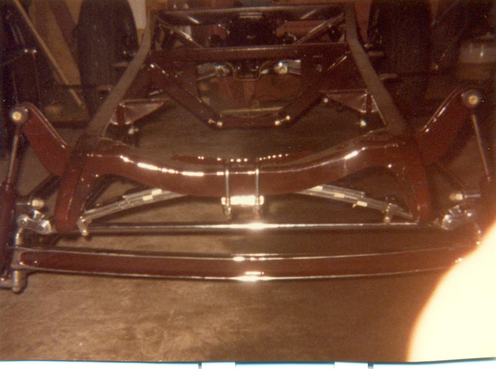

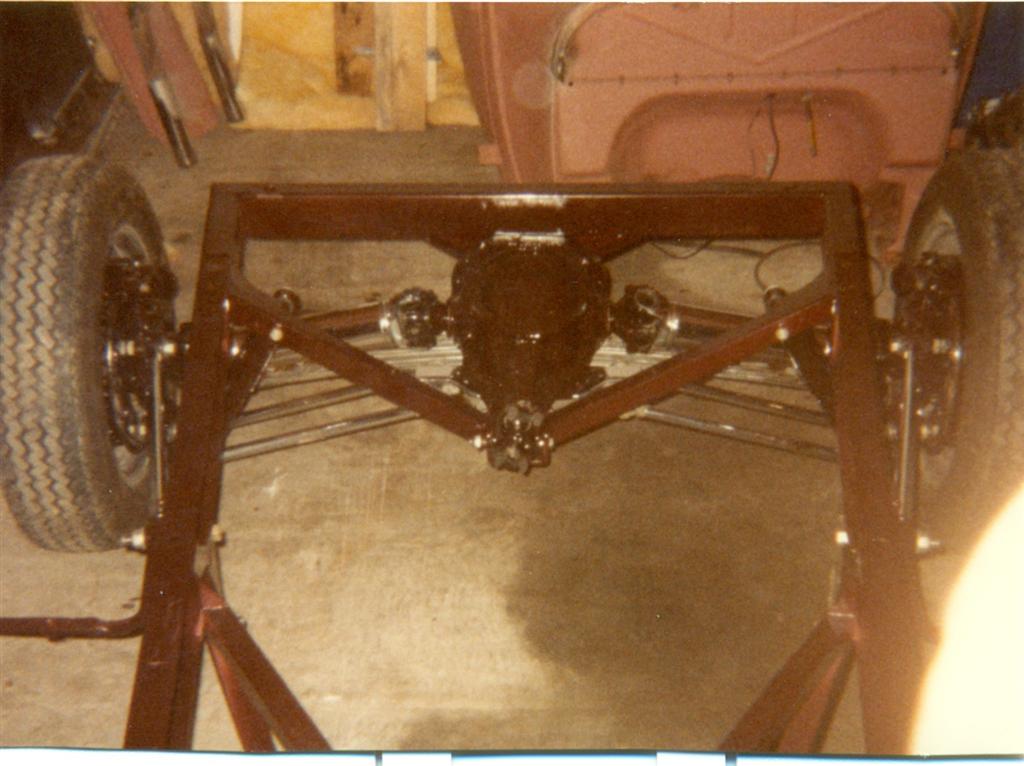

    It realy depends on your style your building. I would certainly give it the fish eye to consider. Lots of detailing thou. I'm running a c-3 vette in my rpu. 30 yrs ago it was trick and around here it still is. I also run a mor-drop beam axle. I always like the transverse spring front and rear axle for a exposed rear of a rpu it looks great. A jag with a axle might be a little wierd thou. The vette is more forgiving in my opionion. Rides nice to, in the back.
  18. tedley
    Joined: Nov 8, 2009
    Posts: 2,147
    tedley
    from canada
    A few pics of yesterday and today.
    Lots of 't' buckets ran jags and axles thou
