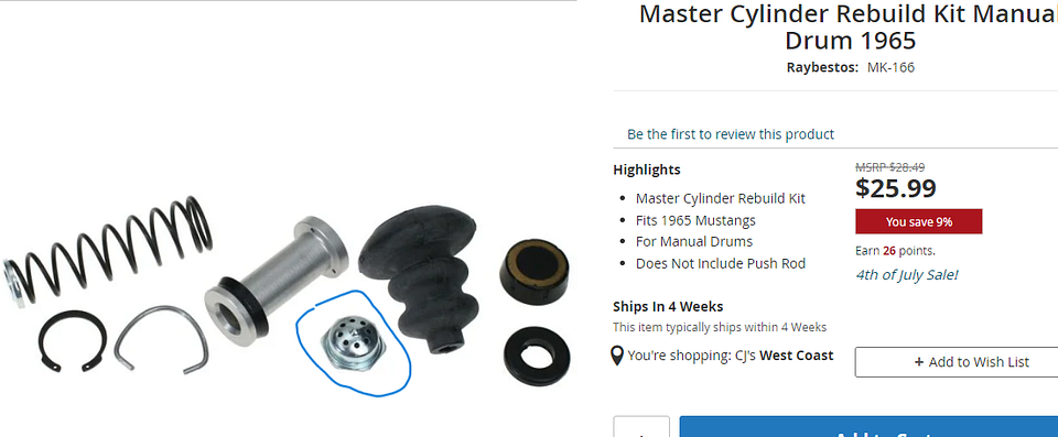

  30. Mr48chev
    Joined: Dec 28, 2007
    Posts: 36,208
    Mr48chev
    Every single piston master cylinder I ever had apart had a check valve to hold pressure in the lines when the brakes weren't applied.
    On drum brake dual master cylinders there are check valves behind the br*** seat for the brake lines in the outlets of the master cylinders. Disk brake master cylinders do not have those check valves.
    Those check valves in the dual master cylinders tend to work well with firewall mounted master cylinders but my experience says that they are not strong enough for under the floor mounted master cylinders. They work if you drive the vehicle on a regular basis and it never sits more than a couple of days between being driven but my personal experience is that those check valve springs do not have the strength to maintain pressure on the lines for extended periods of times and if you let the vehicle sit for weeks at a time you will have mushy brakes because air has leaked in past the cups in the wheel cylinders.
