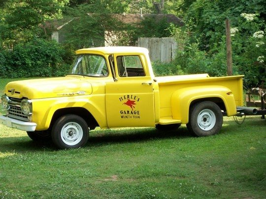

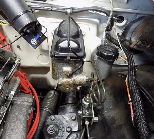

  24. manyolcars
    Joined: Mar 30, 2001
    Posts: 9,609
    manyolcars
    The 57-60 power booster is expensive so I looked for the next newest available. I used the 1964 booster for my yellow truck. The 64 booster is pretty small and leaves lots of room. mastercylinder2.jpg 7347094878_d9ddea448c_z.jpg I had to make an adapter from booster to firewall and had to drill a new hole3/4' down the brake pedal to get the right pedal ratio.
    I use a 15/16 master on every one of my cars and ask for it as a 1980 Pinto at the parts stores
    OfficerBimbo likes this.
  25. OfficerBimbo
    Joined: Mar 22, 2012
    Posts: 89
    OfficerBimbo
  26. OfficerBimbo
    Posts: 89
    OfficerBimbo
    Nice
    Nice truck and set up! Again, my biggest issue is that I have an inline 223, and that set up most likely will interfere with the carb.
