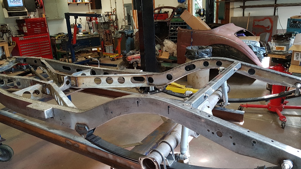

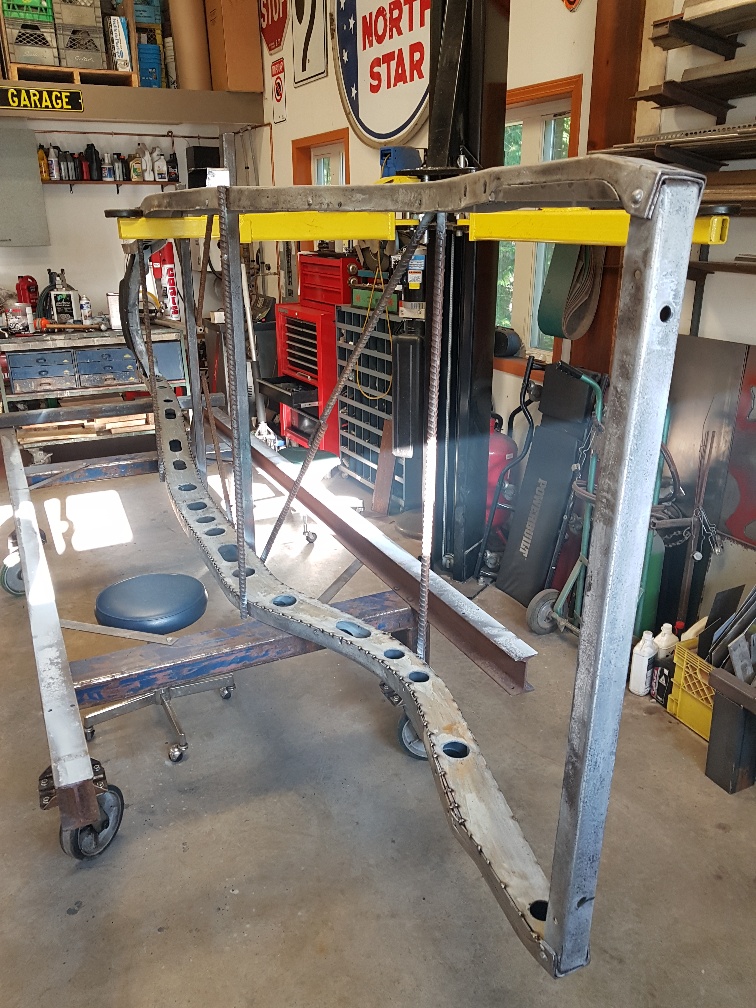

  13. I know it's not necessary to box the ch***is on these cars (our '36 sedan wasn't boxed and we rolled many miles on that car), however I chose to box the ch***is on our '38 cabriolet because it doesn't have the benefit of the roof to help stiffen the car. I made simple 1/8" plates, drilled and cut plenty of access holes and mounted them so I had a nice corner weld that could be ground smooth when done. Here are some photos showing tacking in the plates with the crossmember removed and then the ch***is after the crossmember was re-installed (from my build thread). 20181203_122502_resized.jpg 20181230_145338_resized.jpg 20190313_124300_resized.jpg 20191007_135143_resized.jpg
