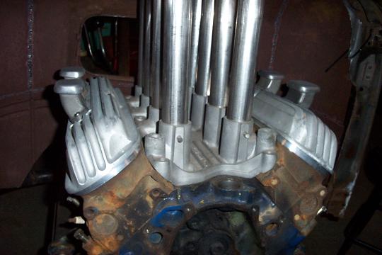

    I hate to say it but I murdered these, as they are rather rare, but it was worth it to put the Stellings on them. I know they look like just another set of early Cal Customs but they are actually older sandcast covers sold by JC Whitney.

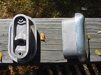

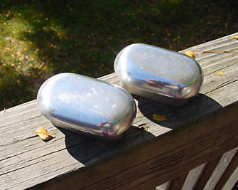

    Here ya go, I ground the fins off with a die grinder and finished thr final shape and flattened the bottom with a "cookie" or rol loc disc. It also has a PCV plumbed (and baffled) in the valley.

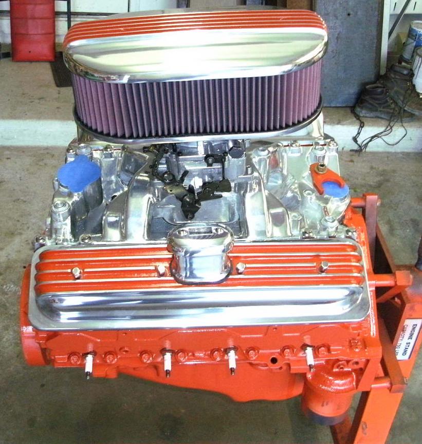

  5. I got 2 Cal Custom 9 fins off ebay cheap (each was a single), and each was one that had the oil cap hole in it cut out and the PCV holes not knocked out, so I got 2 chrome mushroom breather caps, both bayonet mount, one is set up sealed with a rubber grommet for a PCV valve (late model engine and no fill tube on the intake). The tangs on the bottom had to be ground a little to fit, and I made a rubber gasket to fit and make them tight. I think this is the setup they use on BB Mopars. Jegs has both styles, Summit, only the breather.
    I only have one picture since I put them on:

    Hello Algon, One question. Why are dual breathers needed
    on one valve cover? Have I missed something or what?

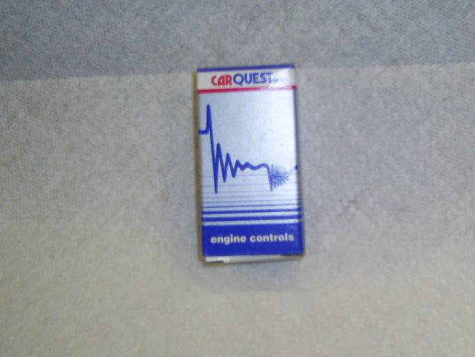

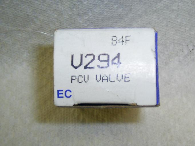

    I did mine per Tommy's suggestion and works great. This is the PCV valve I used.
    (Sorry pics on the next post)
    DD

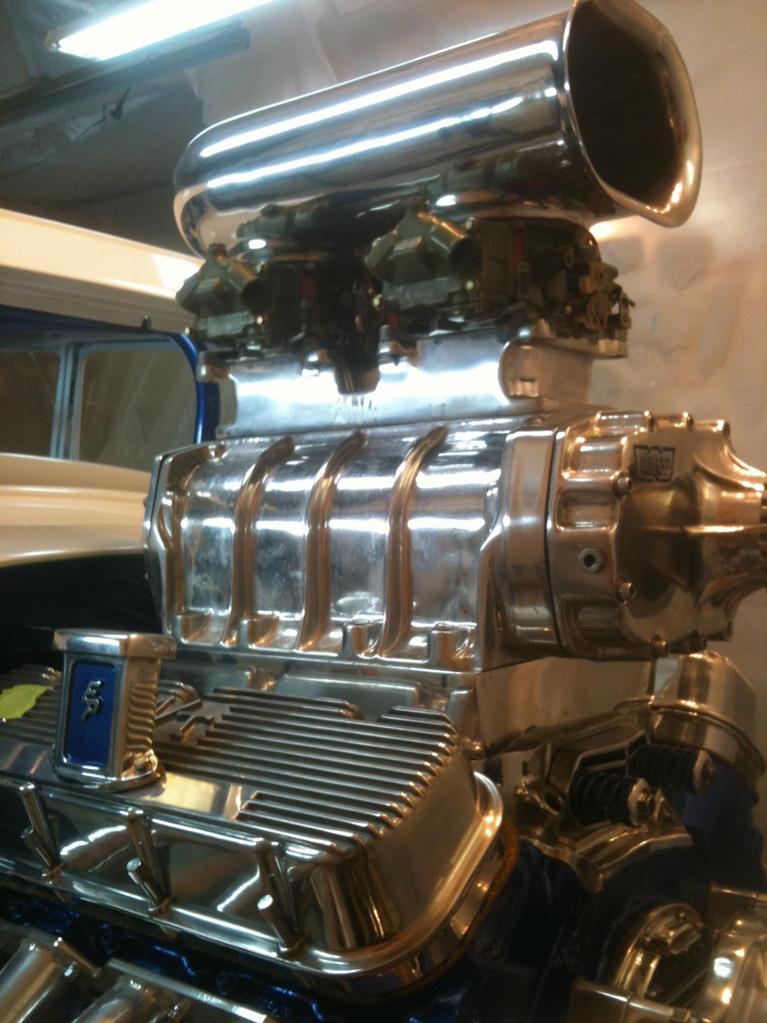

    Blown and high compression high rpm engines build more internal pressure and are often used with larger sized or multiple breathers. I plan to wing the snot out of that motor, and am interested in any benefit I can add to it while keeping in the tradition of things, though I doubt four will make any difference in my case over two. I also just prefer the balanced appearance of four Stellings verses a single chrome breather, which on these oddly overhung the side of the cover.

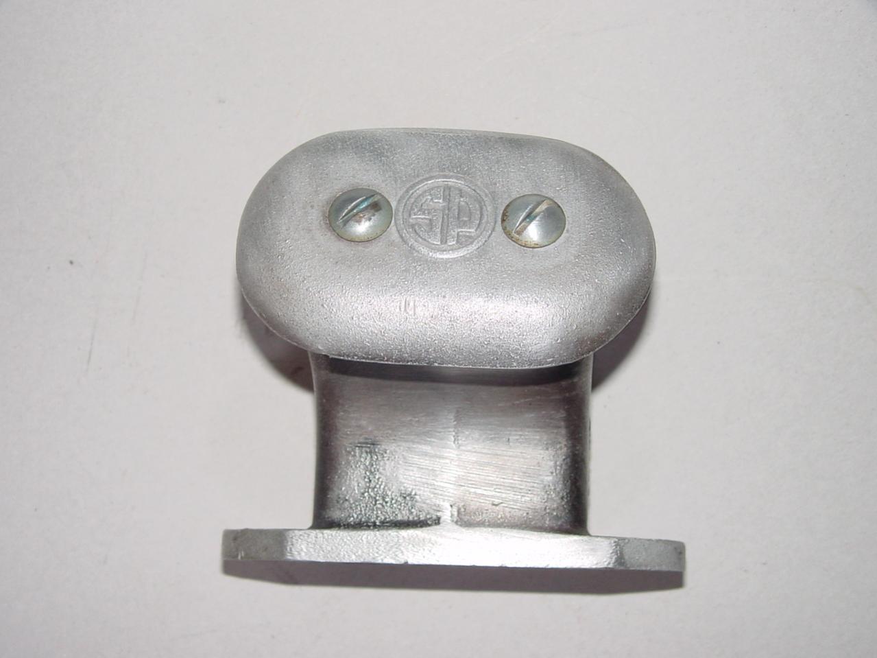

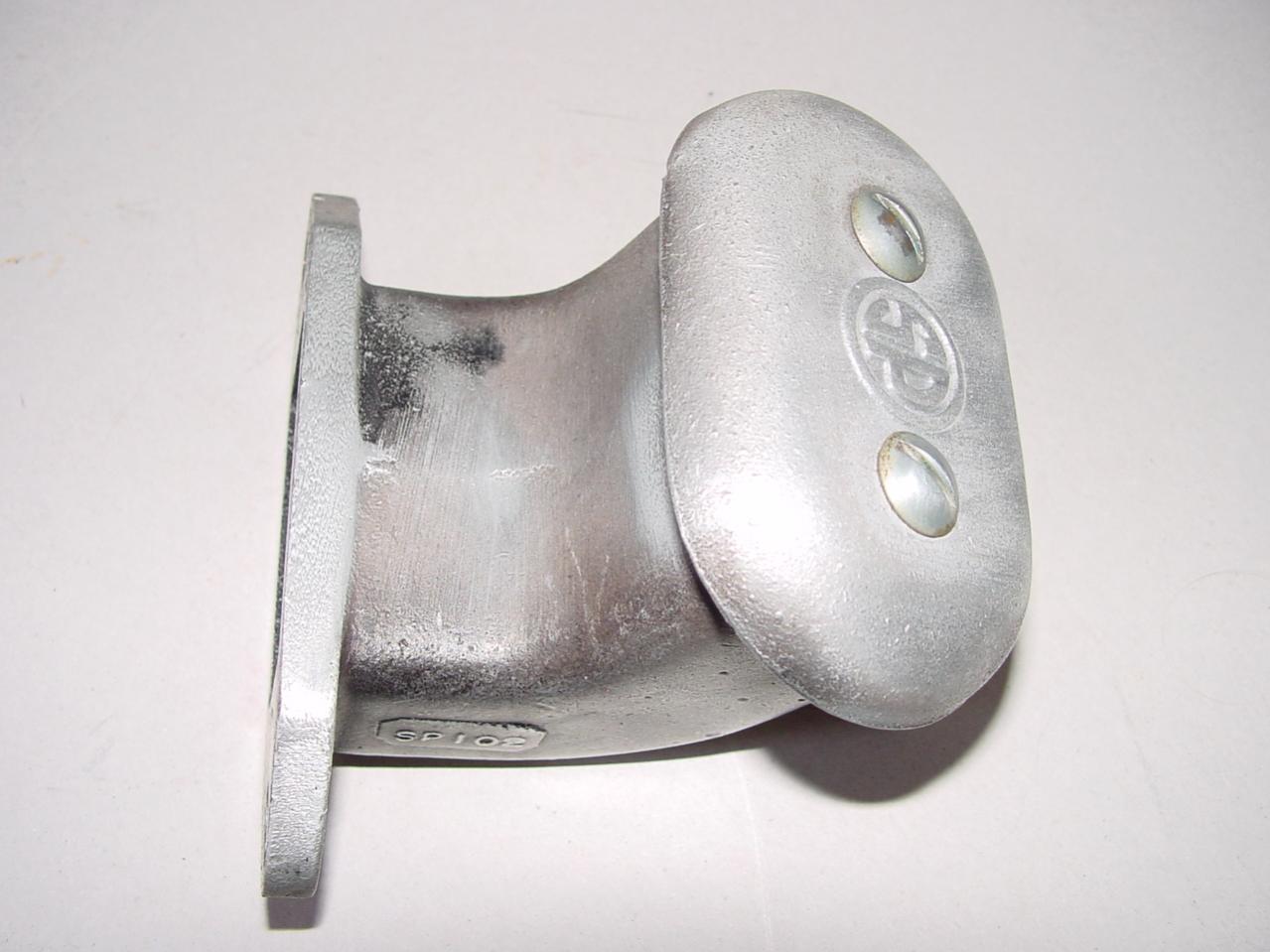

    No wonder those GT breathers are scarce, $22 bucks a pair wasnt peanuts back then. BTW what are those KP breathers? I've never heard of KP.
  23. Keith Black, slightly modified, my last name is Perry:rolleyes:.
