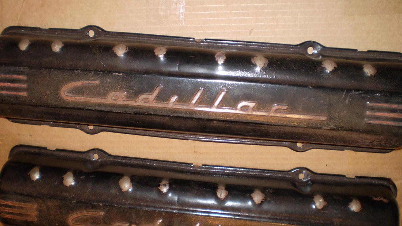

    Who on the HAMB is dimpiling these valve covers for adj rockers?
    I have a set I'd like to get done.
    -Torr

    No one I know right now is doing it... I heard of Spoons being welded in place to make
    the "Knuckle" ... Mine looked like some one just used a rounded edge tool and hammered the crap out of it..

    i see a few of you are intrested in dimpled valve covers . well i have been selling a few sets . i have found a way to dimple them but there is a problem . the valve covers very between year and the part of the country they were made . some dimple very good and some just tear . i would like to some day do this as an exchange . i keep prefecting it but i could not gaurantee your would not tear. i have also done some olds 303 , 324,371 valve covers and they seam to not tear. i am haveing a die made to do the dimples as soon as i prefect it . also i have had and sold old vintage valve covers that were dimpled back in the day and they very all over the place like nice to crude.

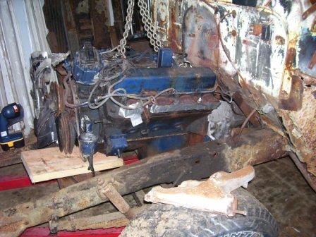

    500 Cadillac first test fit in a '54 GMC 1-ton. These were taken a week ago, today I removed the cab because I wasn't happy with the fit and needed to be able to better see where things are.
    I'm building a hot rod trailer puller because I'm tired of maintaining a modern truck just to drag old iron home.

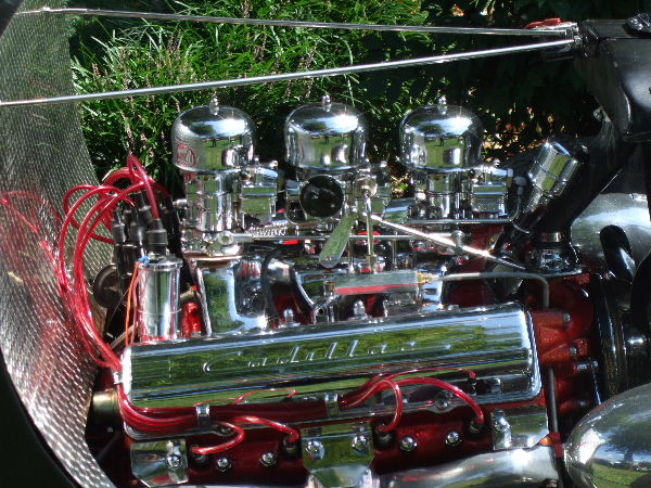

  21. This is my 37 Ford in 65 with Hilborn injection . Caddy is bored and stroked to 400" 12:1 pistons. Crane ultra hi rpm cam w/ solid lifters adjustable smith push rods, 57 heads are ported and polished swirl finished bigger valves, 3-2 58 Cad intake w/reworked carbs., Jacobs ignition box w/ electronic dist. 3" exhaust w/ sprint car mufflers. 11" scheifer clutch turning a GTO close ratio super T-10 4 speed and a Olds. 3:42 rear[​IMG]

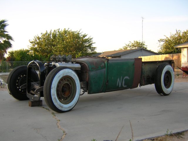

    My '28 Ford pickup thingie with a Caddy mill...

    ognc your last photo is that the same one as in the older speedway cataloge? it looks to familular

    Yeah, I got it to that point and realized how huge the Hydro tranny was and that me and that tranny weren't gunna fit in the cab of the truck. So I ordered a 700R4 adapter from some guy and it was a few months before I got the adapter and by that time I had already moved on to another truck project and haven't got back to the RPU...

    cool . i like to see that rpu done . i love the 4x2 intake
