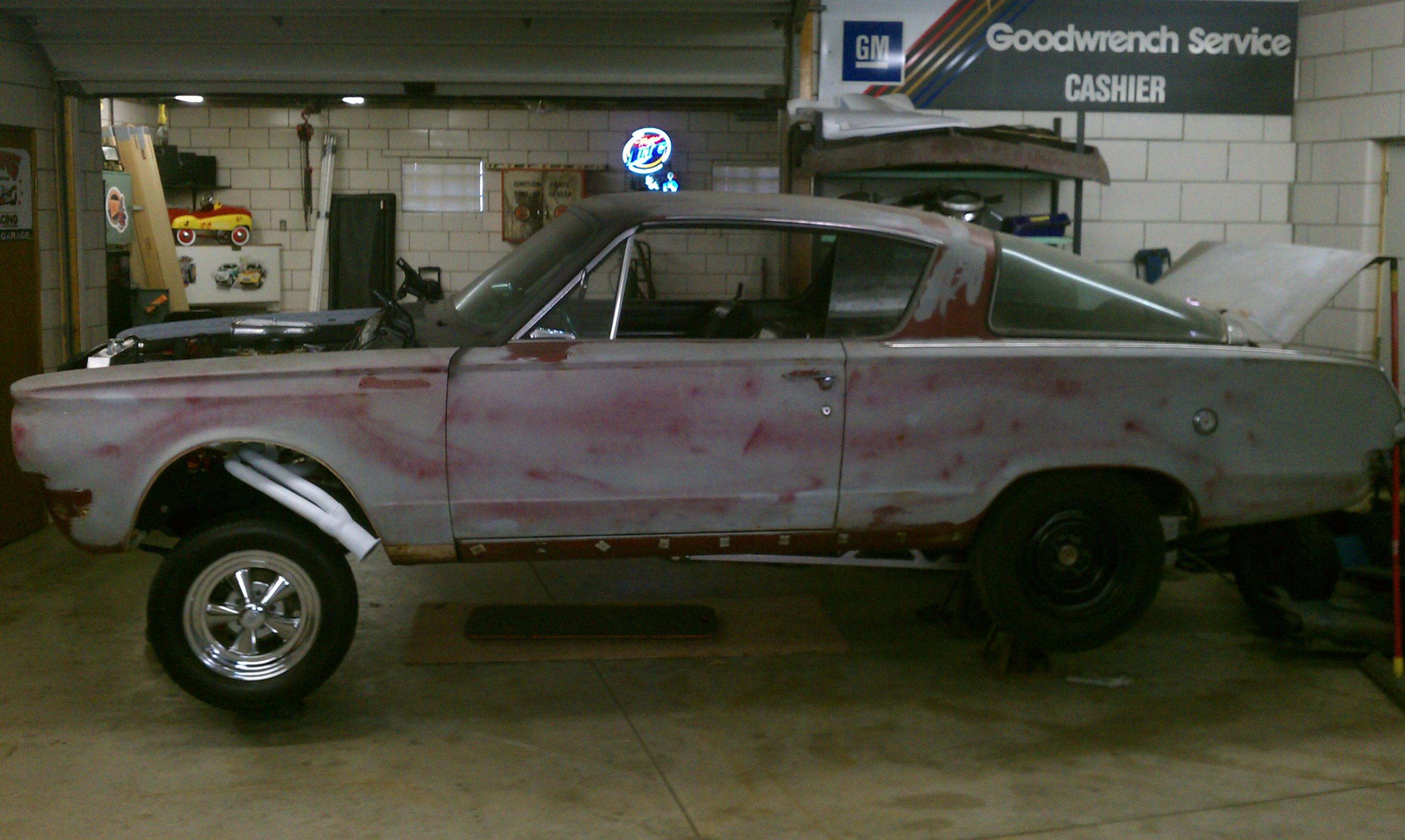

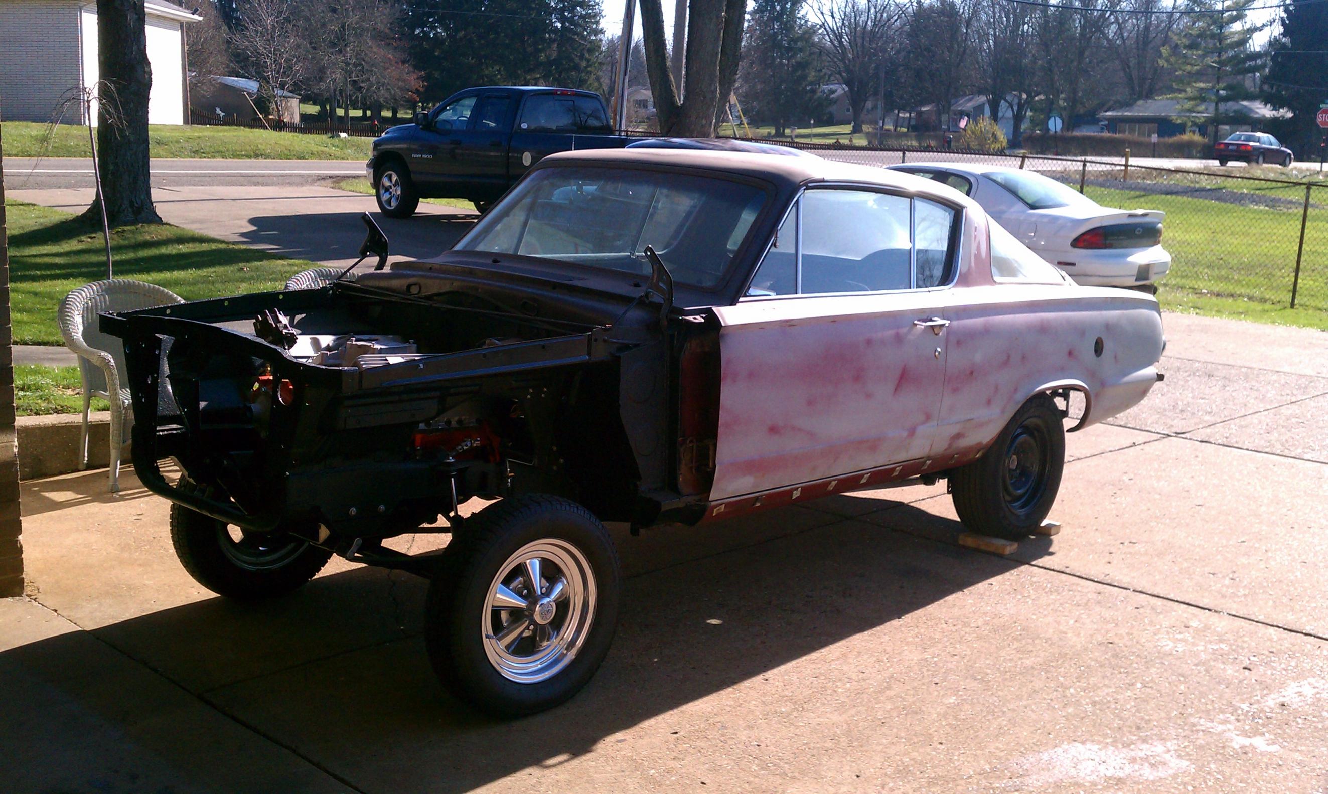

Here is a couple of pics of mine. I have a 383 4-speed in it and just got fired for the first time last night. Good luck with your build.

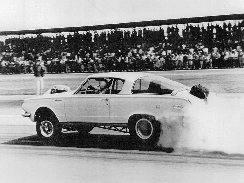

That image of Bob & Shirley Sullivan's "Pandemonium" without lettering on it yet, is not Bowling Green. Those stands are WAY further away from the track than BG...
