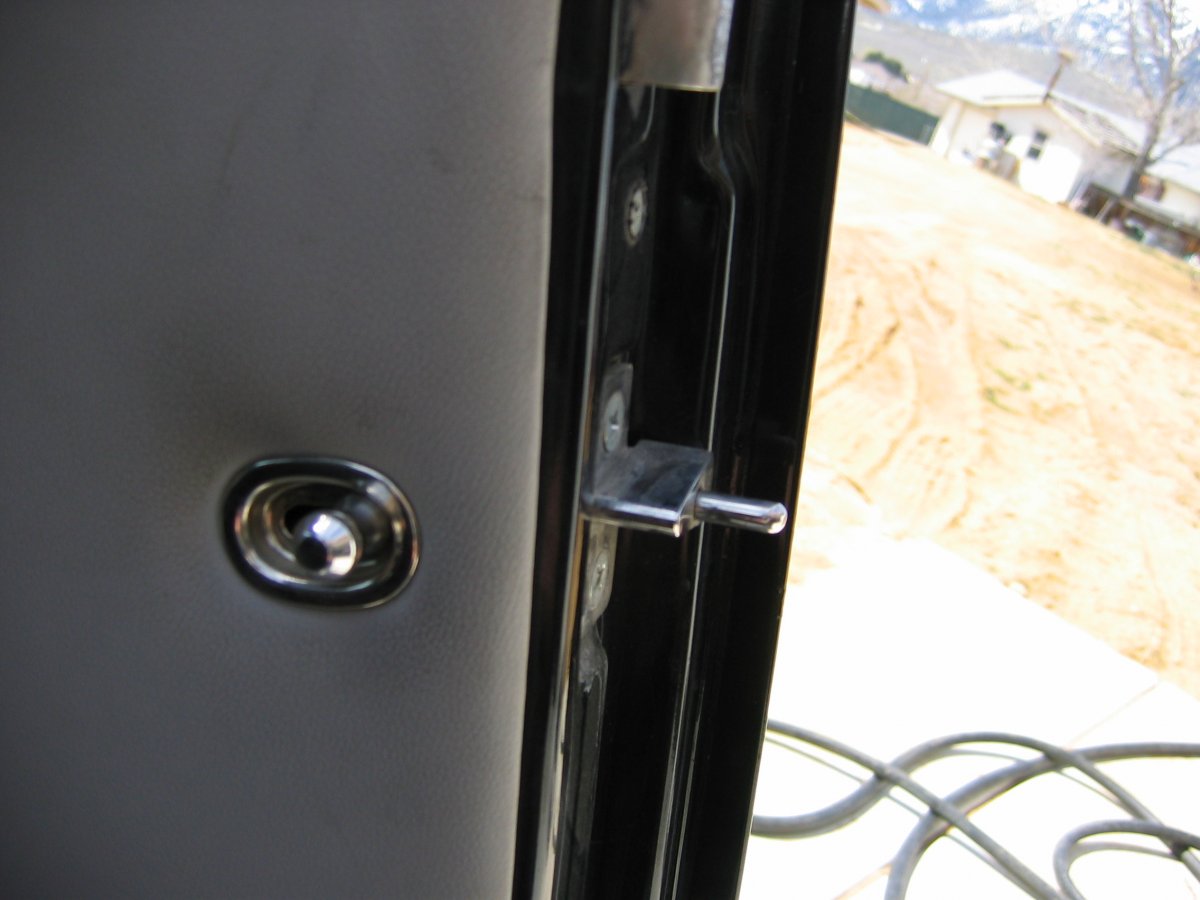

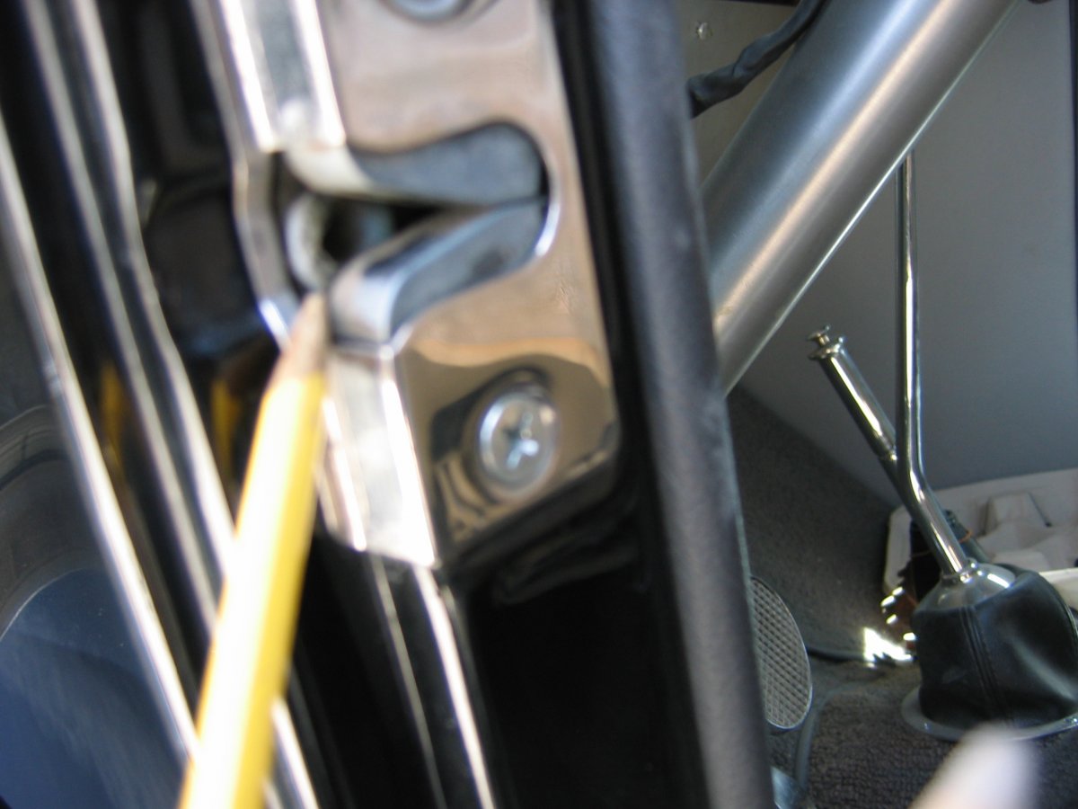

    I designed and made Stainless Steel Security Locks for my Suicide Doors using the Escutcheons from a Standard Model A Coupe ,they slide into plastic caster plugs located in the Female Dovetails for each Door on my 4 Door Vicky C400

    Ohhh I'm stealing that one !!!
    Nice

    That’s impressive, as is the whole car !

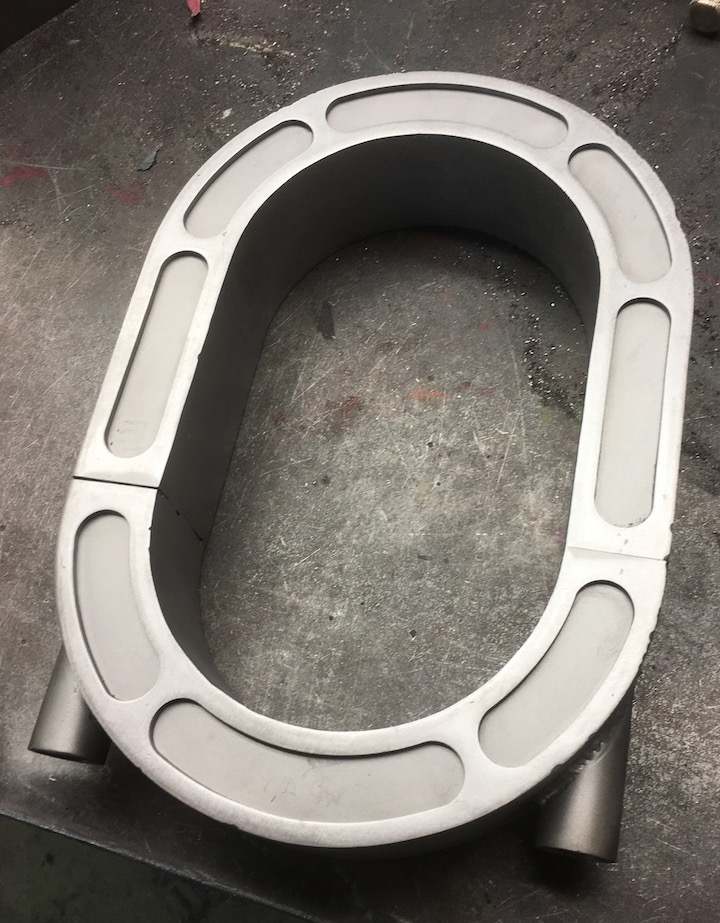

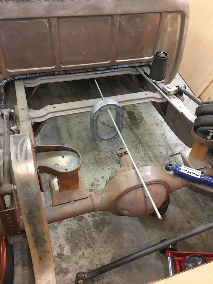

    This is a current piece, driveshaft loop with a drop out for my Studebaker pickup. I'm re-doing the suspension I threw together years ago because it's too wide and the fab work wasn't a nice as I wanted. This is the start, it will get incorporated into a new crossmember that will mount the front 4-link brackets to replace the stock crossmember. All the rusty bits are the original setup I made years ago.

    That's a cool piece!
    Did you keep track of the hours it took?

    Thanks! It was fun to design and make.
    No clue how long it took, and it seemed to take too long, mostly because I'm out of practice. Probably a day and a half, spread over a week or so. Shouldn't have been more than half a day, but between searching for the right tool and having to re-point the tungsten over and over I wasted a lot of time. But it was fun to build.
    The rest of the parts for the suspension are simpler. I think. We'll see.

    Very nice work man real clean stuff!
