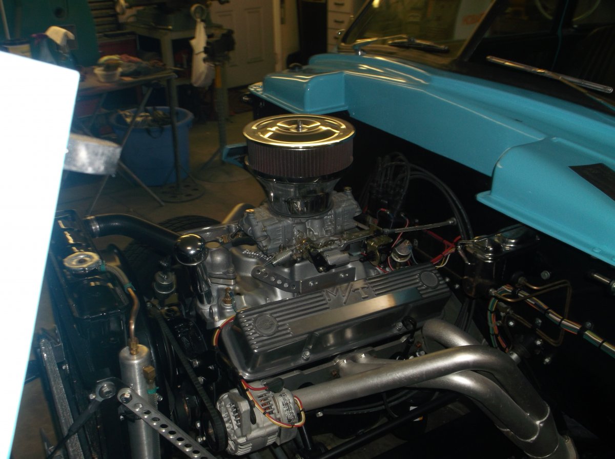

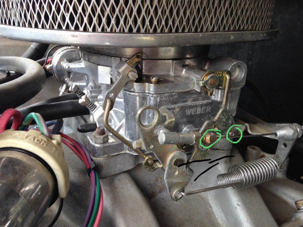

    I'm not crazy about how this looks but it works OK for now. I was hoping to see how others have done it. This bolts to the A/C mount bosses on a C3BX intake.

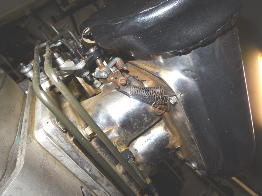

    Mostly home made

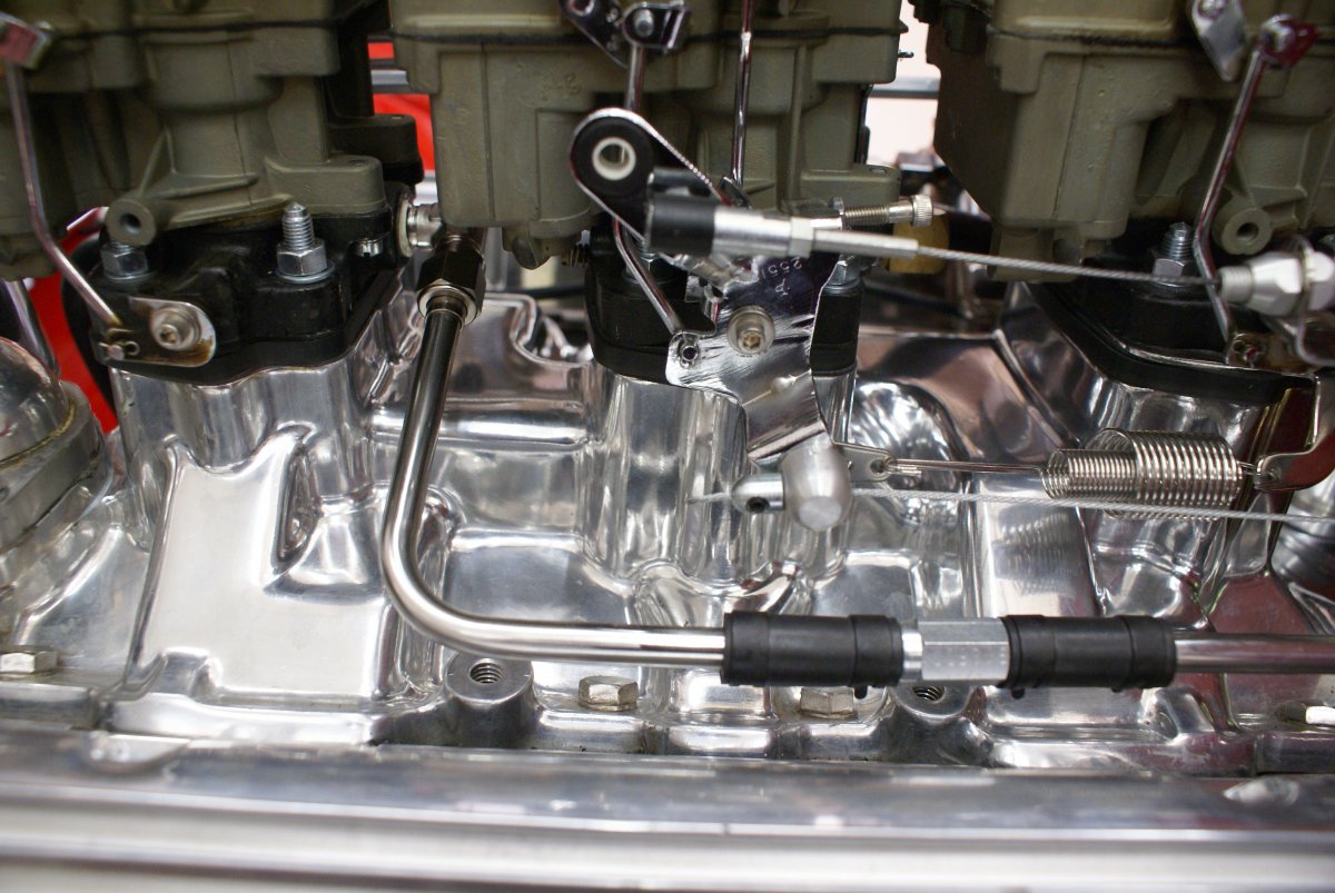

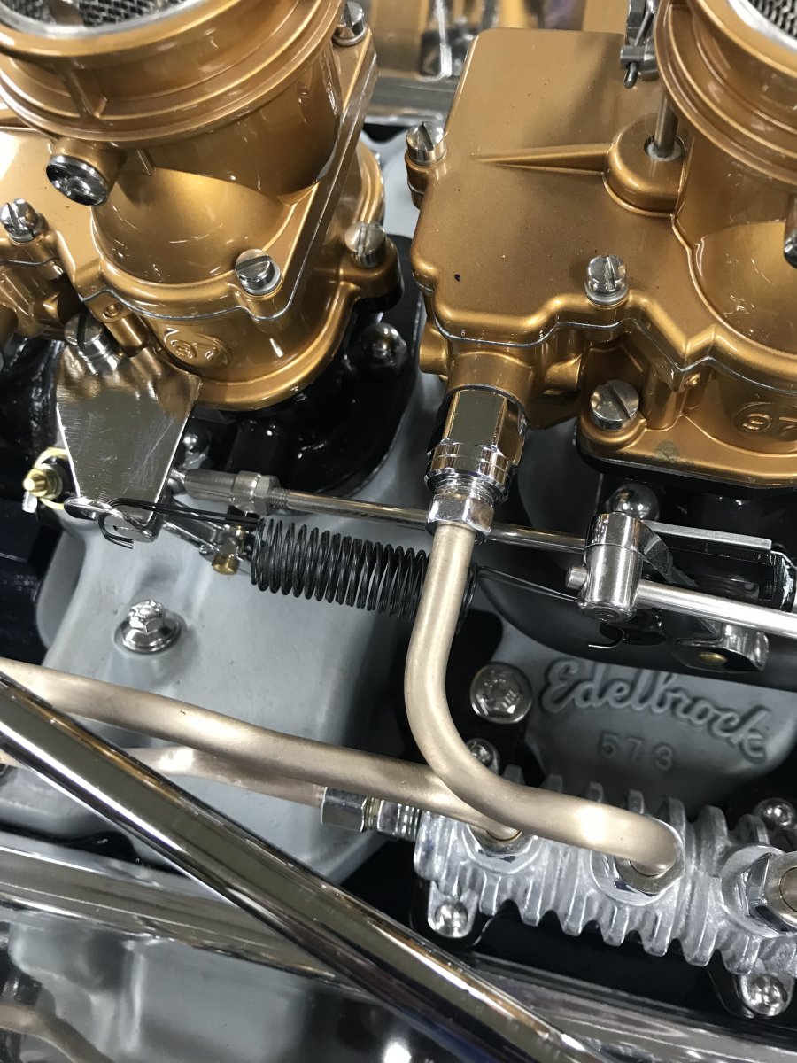

    I made a stainless steel bracket that attaches to the front Stromberg on my Y block tri power and have dual return springs.

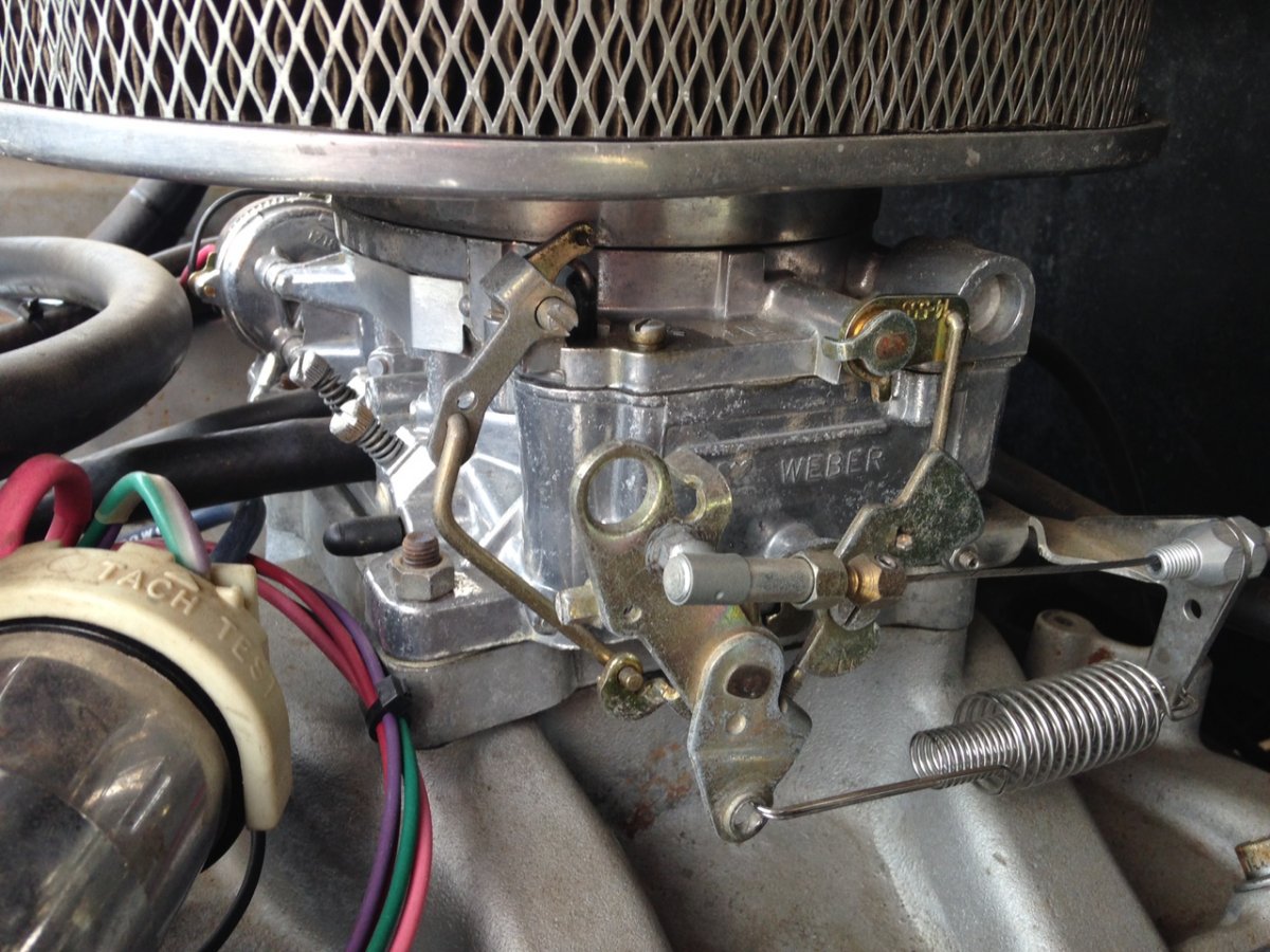

    I used a mid 70's Ford throttle cable that has a return spring built onto it. There is a similar return spring on the secondary throttle linkage. IMG_1253.JPG

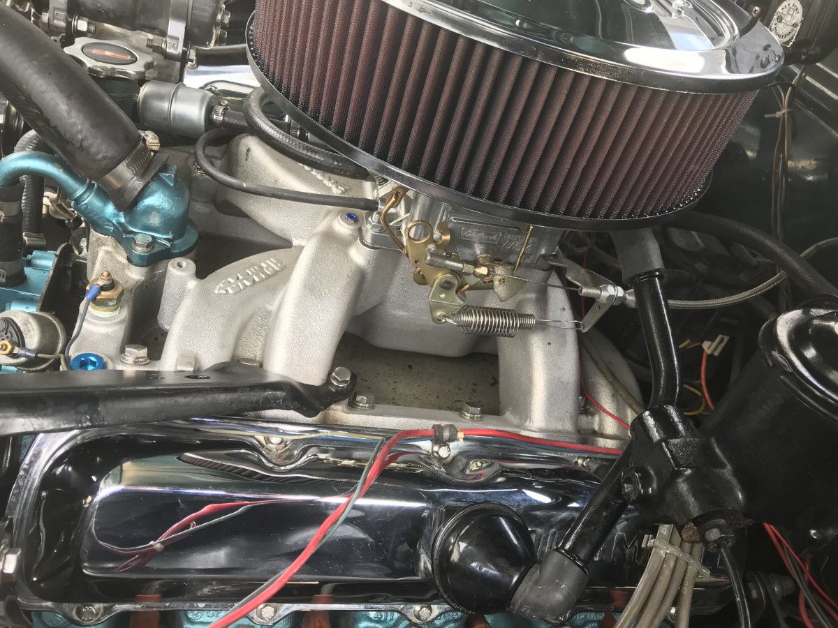

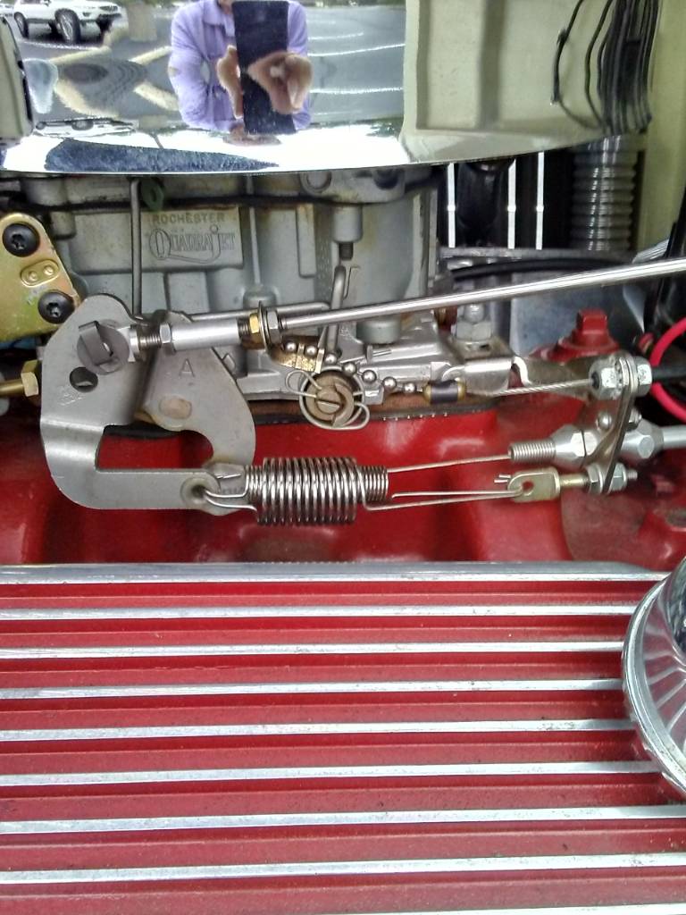

    Got my return springs on today. I made my brackets out of scrap from my metal barrel. I just like to make stuff rather than spend the money on store bought items that can be fabricated. 15 minutes worth of work saves $ 40 or 50 bucks that can go else where. DSCF3514.JPG
