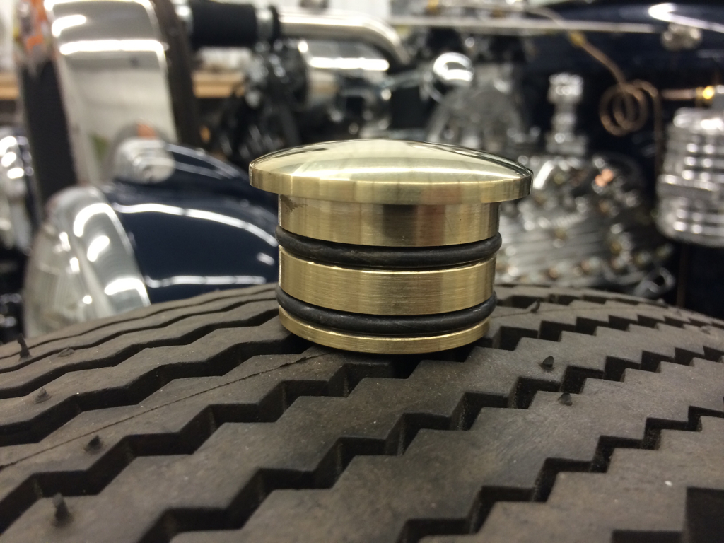

  19. Made this last night. It's a br*** plug that fills the hole in my pitman arm on my Model A. ImageUploadedByH.A.M.B.1424058939.355099.jpg
    TagMan and burl like this.
