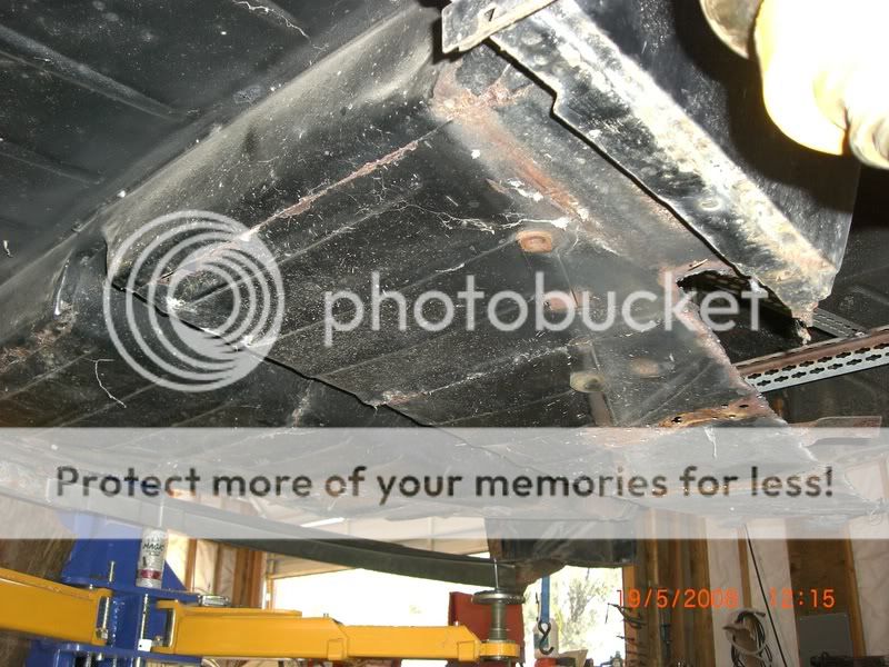

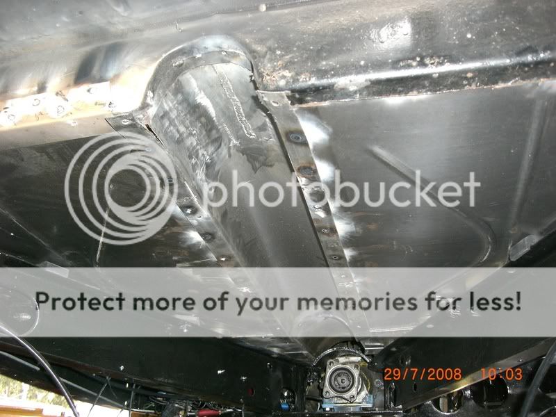

    Heres some before and during pics of mine , they,re not after pics because it,s not finished yet.
