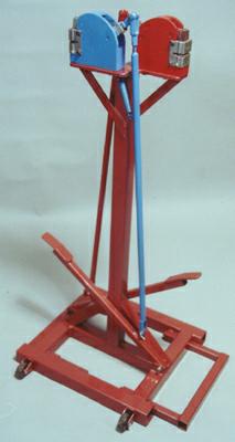

  17. Bluto
    Joined: Feb 15, 2005
    Posts: 5,113
    Bluto
    My shrinker-stretcher just has a built in stand :)
  18. Slag Kustom
    Joined: May 10, 2004
    Posts: 4,312
    Slag Kustom
    thats alittle more then just a built in stand.
  19. Da' Bomb
    Joined: Apr 8, 2005
    Posts: 438
    Da' Bomb
    Now that's just showing off! Shrinker envy! ;)
