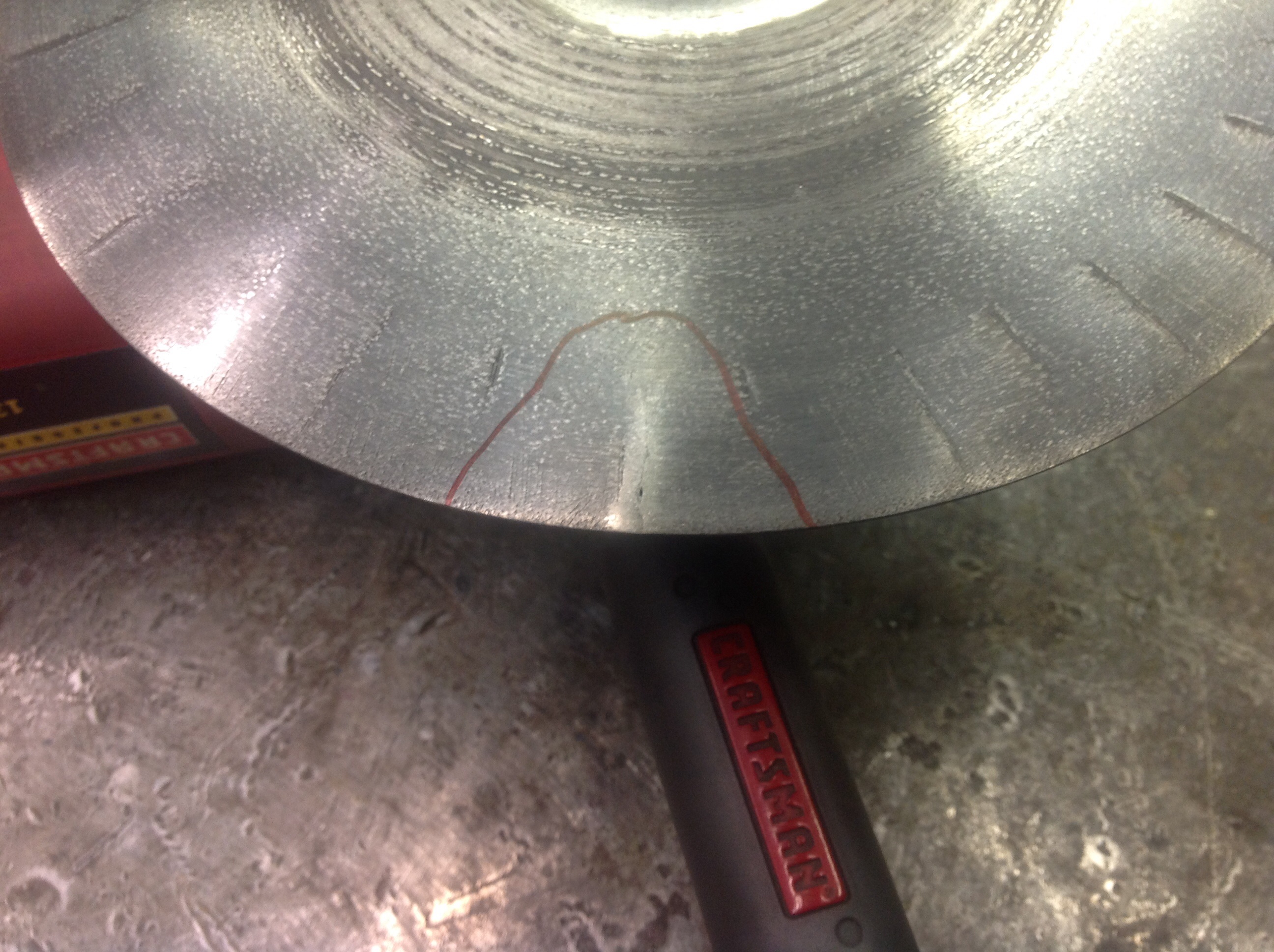

    A shrinking disc has its uses but it is not a subs***ute for planishing. If the panel is not stretched it does not need to be shrunk. If you have a rippled panel you need to dress the ripples out by planishing. If you then find it is stretched it will need shrinking. Metal has memory and will return to its former shape if it is treated in the right way.

    Mindover makes a very good point. Shrinking, both torch, and disk is often used prematurely, causing additional damage. A "oil can" situation isn't always due to stretch. Make sure you have the shape corrected before you turn to heat.

    Don't even think about using one that doesn't have the upturned lip on the O.D. That's got to be one of the most dangerous tools I've ever seen.

    Do you guys have soft start grinders in Canada and the USA? I have my shrinking disk on a 9" soft start grinder and it starts slow then speeds up. When it was on a non soft start grinder it would almost rip out of your hand on start.
    But as someone in this tread said always start it resting on the panel and wait til is stops before lifting it off the panel.
    I have oxy and the shrinking disk but always use the disk for shrinking - I only weld with the oxy. Used to use it for shrinking till I bought the disk. Took a while to get used to but once you get the hang of it it is great
