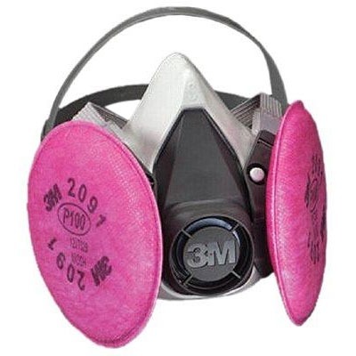

    X2! 3m makes a nice welding respirator . Fits comfortably under your hood. Body Shop I'm at supplies them so not sure on the cost. Either way its your health so expensive or not wear one!

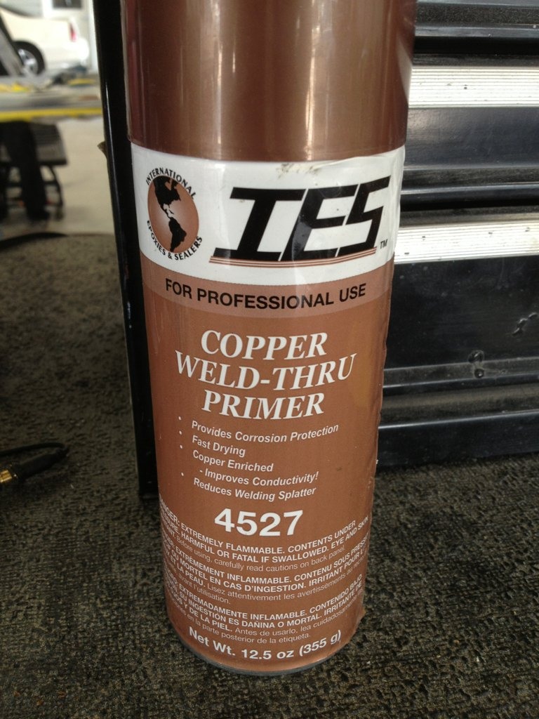

    The weld thru primer we use is very good stuff. No splatter they u get with the others. It's mandatory we use it as a better corrosion protection. As a matter of fact I just put a second bedside on the same o/t chevy truck. Using the weld thru primer helped a bunch, no rust from the first repair. A good weld thru primer is absolutely necessary. If you were just to lap two pieces of clean metal together then weld its gonna rust. But keep in mind all the newer cars a built different from the older ones. It's all lapped and spotwelded
