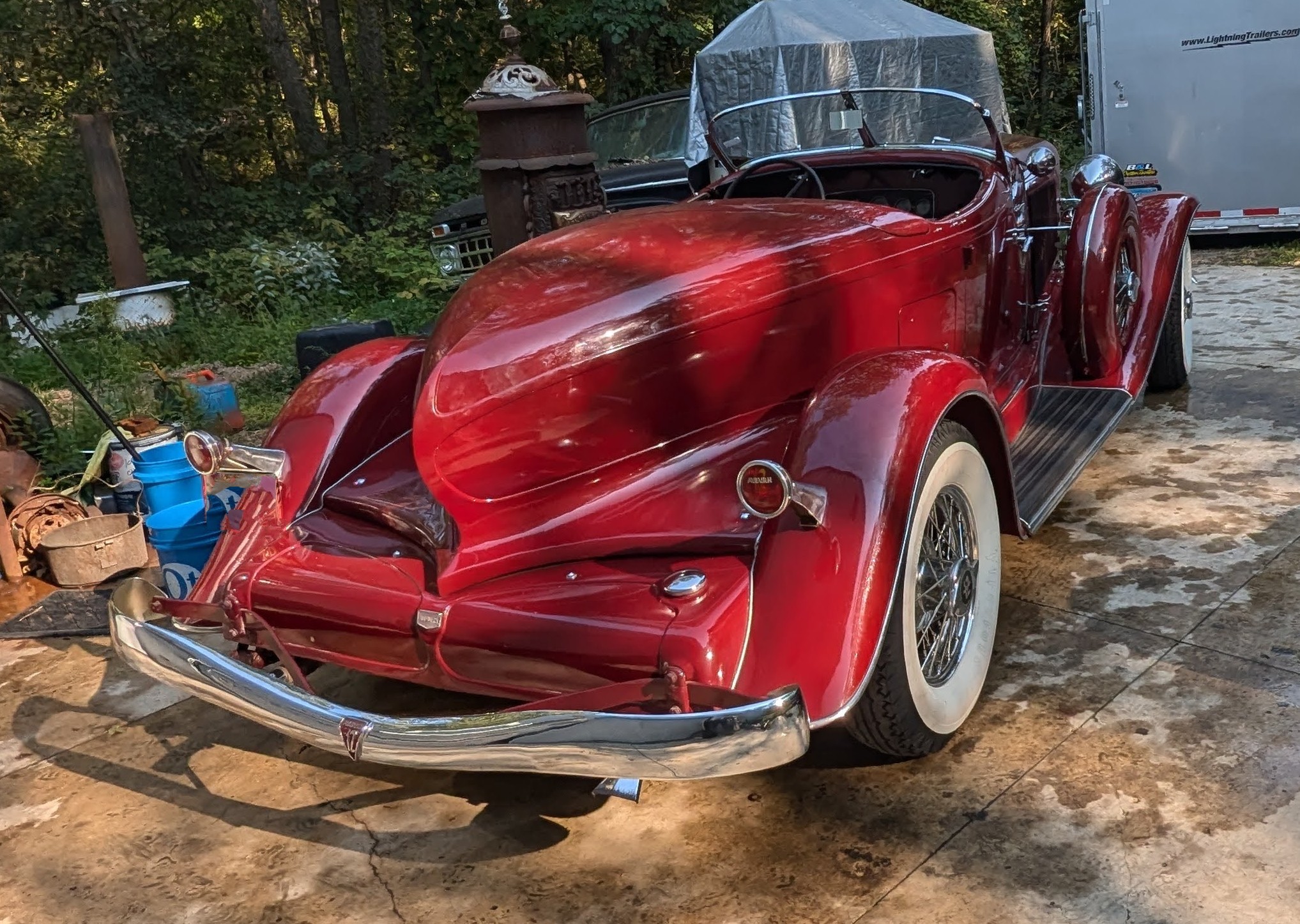

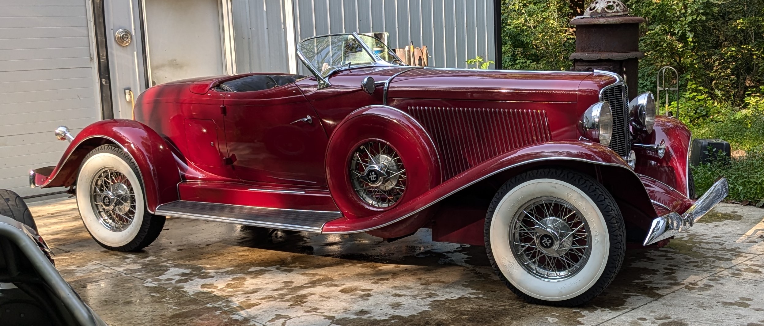

    41GMC, I don't suppose I should derail this thread with off topic Auburn stuff, but here is a sneak peek. After Sick Week I can post more in "The Antiquated" section I suppose.
    turboroadster, SS327, Stogy and 13 others like this.

    That is indeed a great machine, thanks from Dennis, for sharing the teaser pictures!

    beautiful car, I hope it's "plan B" if the coupe doesn't cooperate.

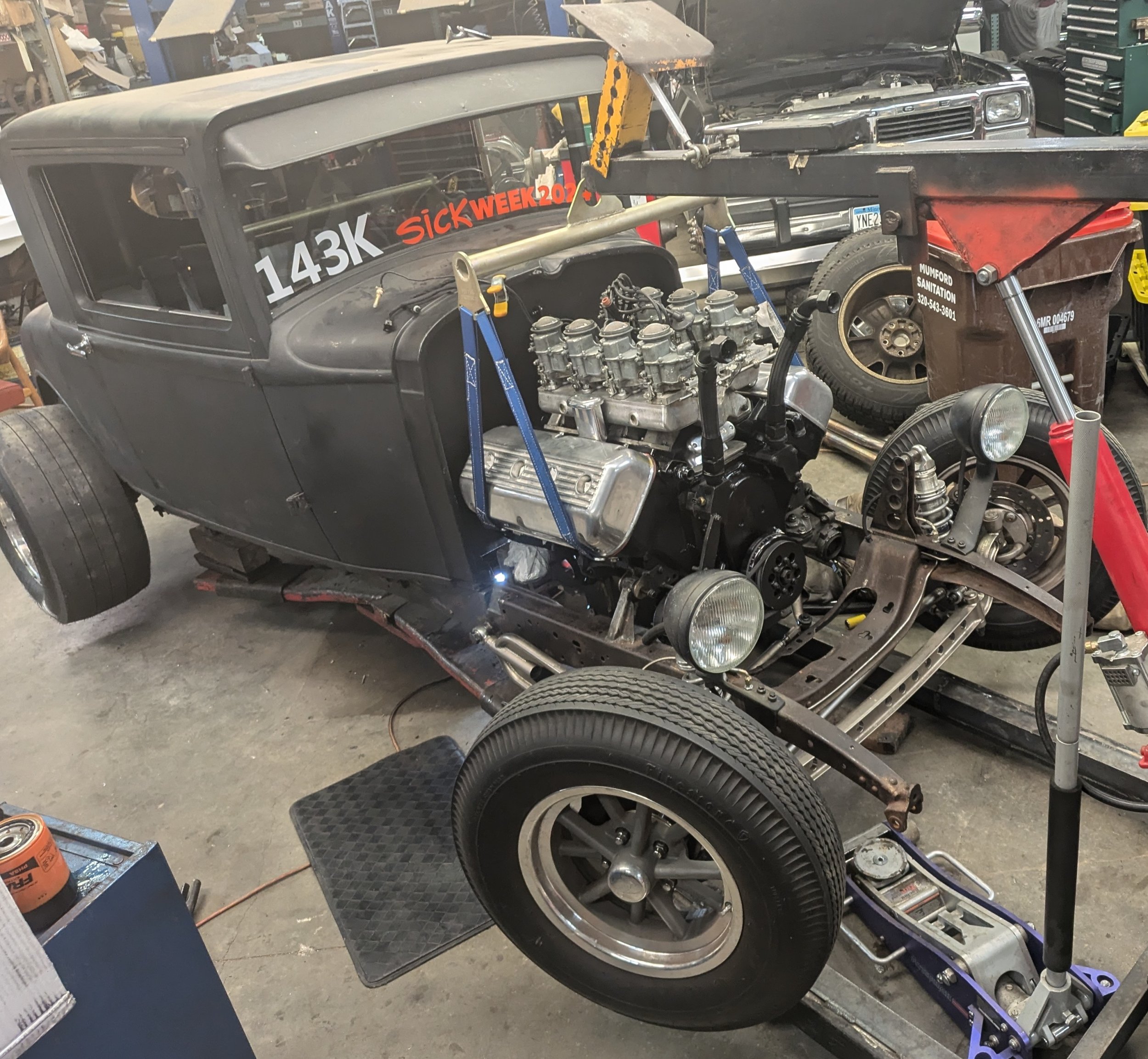

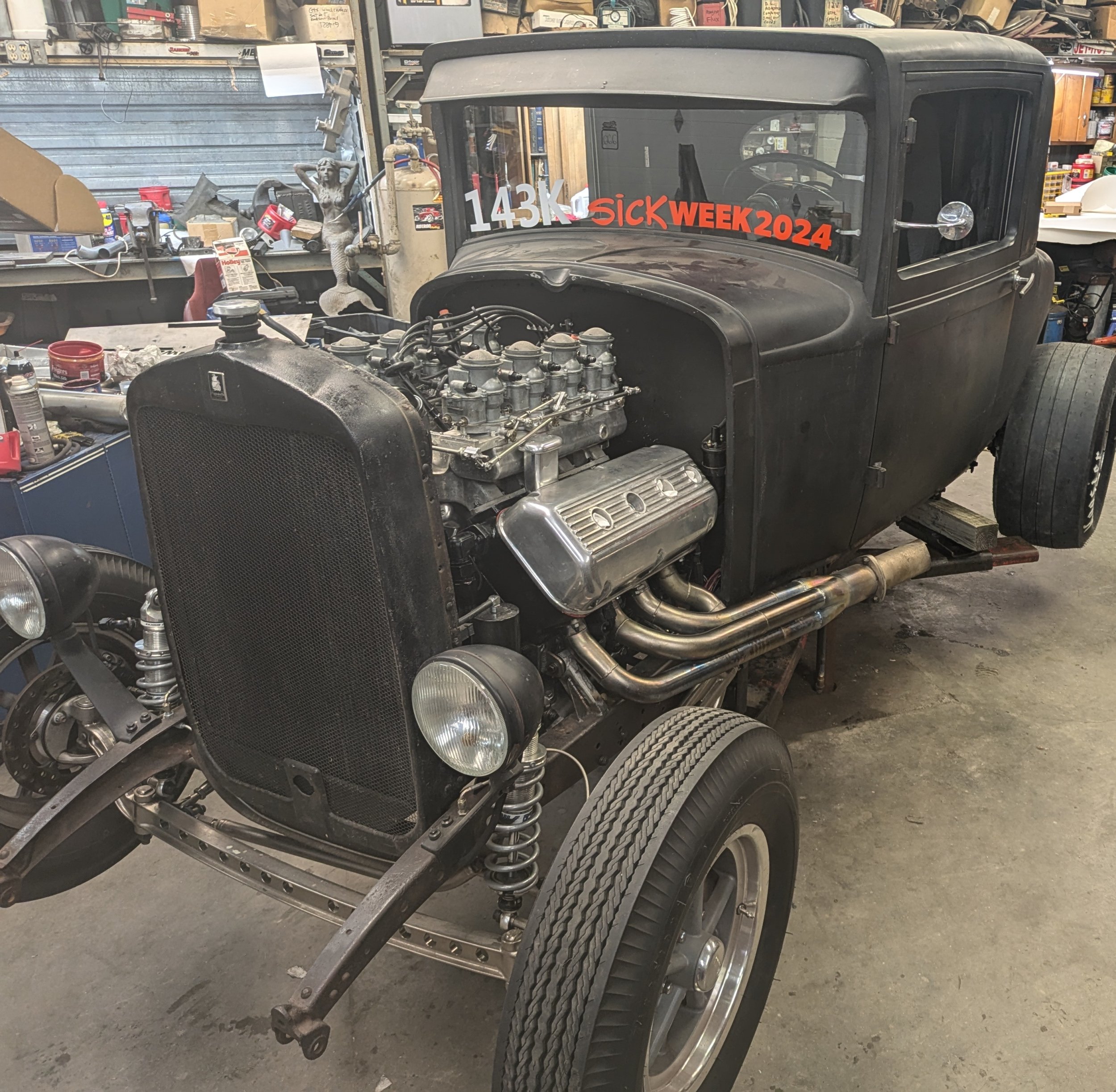

    I finally finished getting the Hemi put together tonight. Cam's been coming over and helping with the project some. Hopefully tomorrow will have it in the car and test fire it. If nothing goes wrong we should be ready in time for sick week!
    Since I had problems last year caused by the screws that hold the cam retainer plate to the front of the block rattling out, besides loctiting them I switched to ARP hex bolts instead of the Allen headed cap screws, and made a sheet metal retainer with tabs bent against flat spots that I ground into the flanges of the bolts. I'll be really, really surprised if they rattle loose.

    More progress today. The engine's in the transmission's in. Should be up and running tomorrow, barring the unforeseen. Thanks for the well wishes! My shop looks like a tornado went through.

    Hey @Hemi Joel
    Looks like a lot of great progress.
    The mermaid on the bench looks very cool as well!
