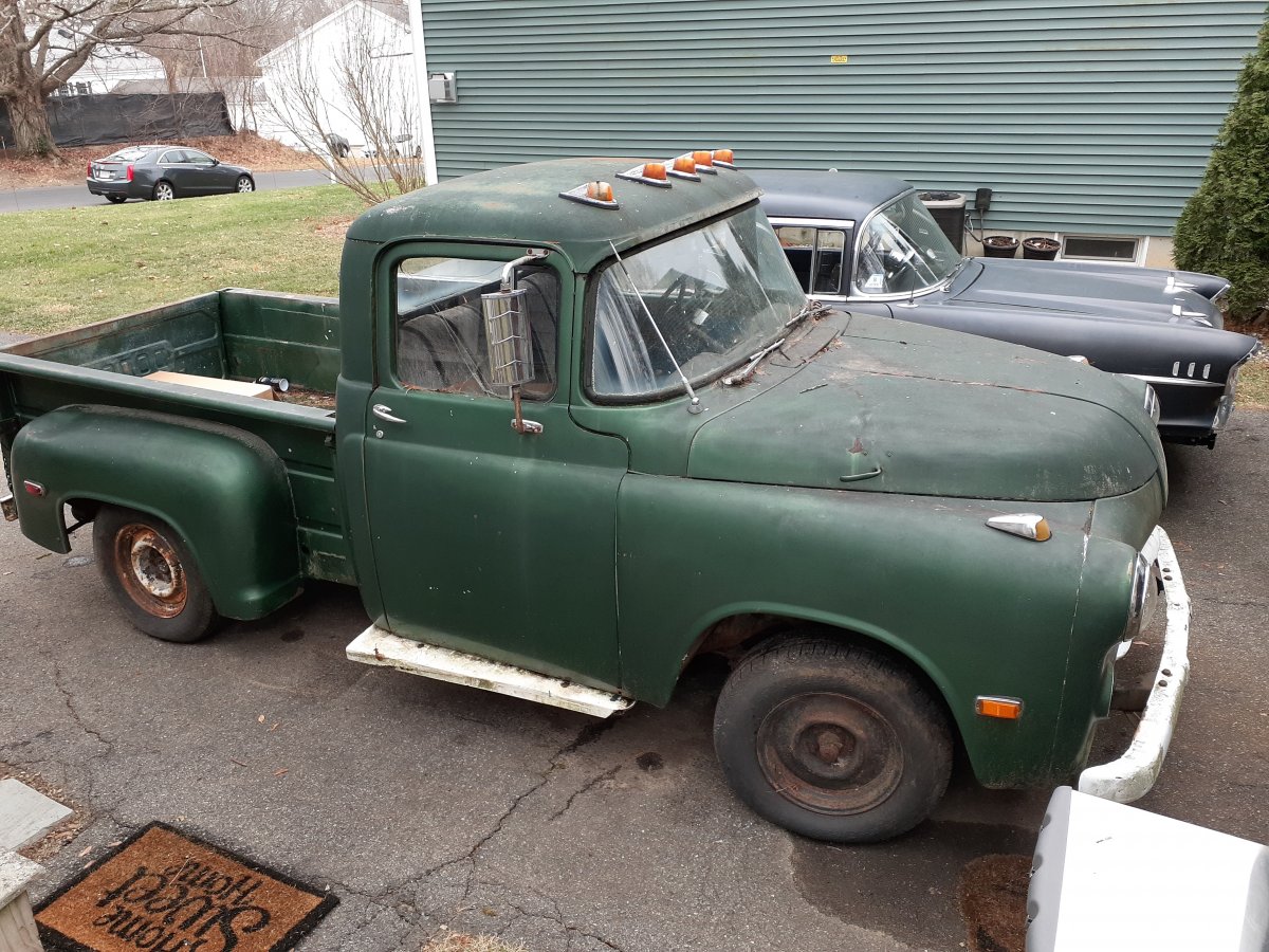

    I had posted a couple threads asking about info on 56 Dodge trucks and straight six Chevy engines. Well, my coworker asked me to get his project road worthy.
    It runs and drives but does not stop so first order of business is brakes and brake lines. It'll need a carb rebuild, new radiator, and whatever else he wants. 20201212_113700.jpg 20201212_114018.jpg 20201212_123636.jpg

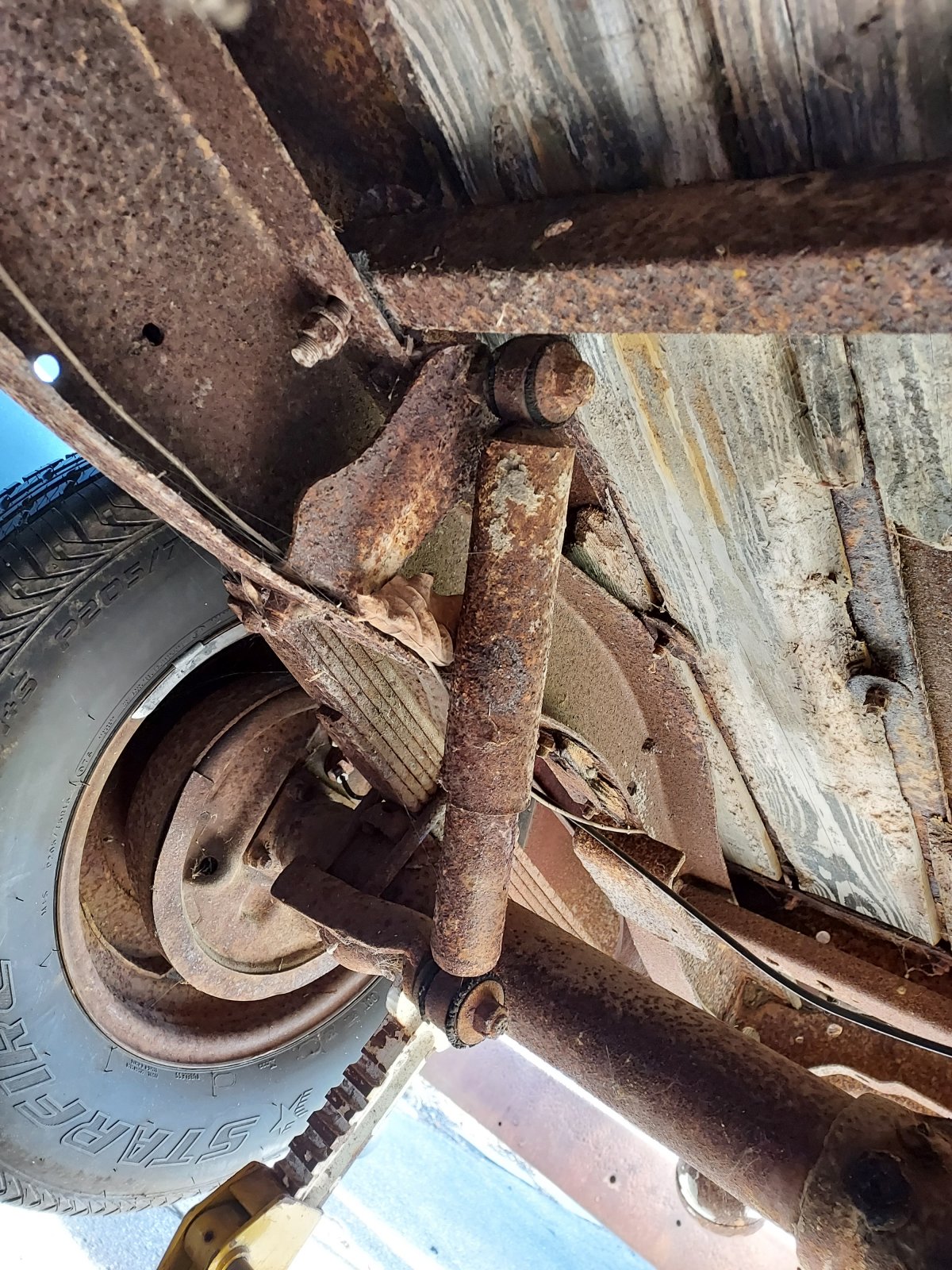

    wheeldog57
    Got some time to work on the truck this week. Plumbed new brake lines and hoses, put new shoes, greased front hubs, etc. While I was under there I noticed a chunk of frame broken off. It was part of a shock support that is missing. I'll need to fab up another support. 20211214_110023.jpg 20211214_110032.jpg 20211214_121514.jpg
    The floor was/is layers of roof flashing secured by nails and roofing cement over bolted together thin plate, yikes!
