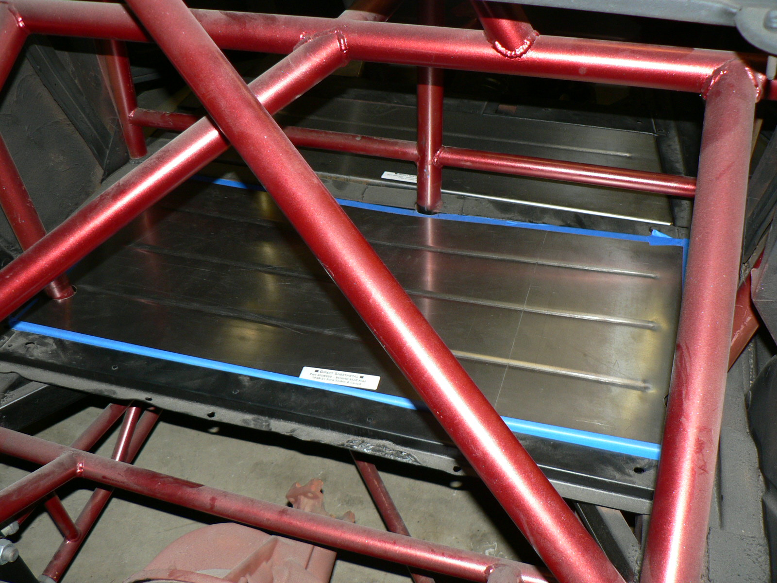

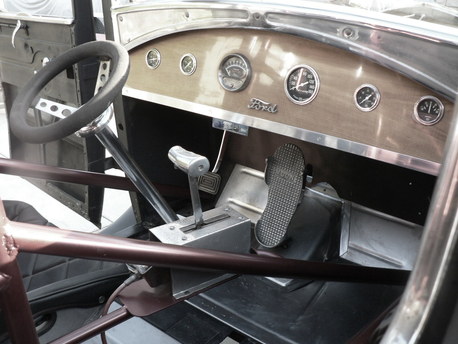

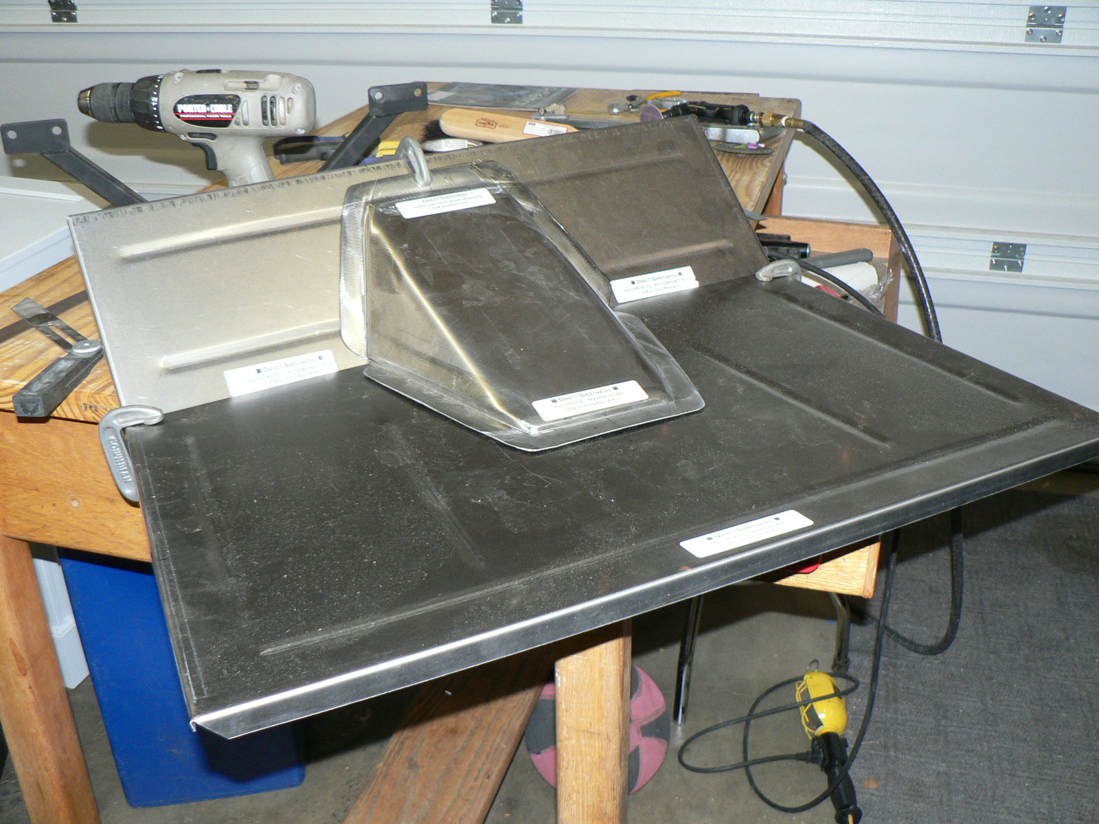

    i was luckey to have a rust free car to start ...
    back in 65 i was the 2nd owner!!!
    photos floors from Direct sheet metal here in socal...
    most of what you see for sale comes from them...
    great fit...........will make custom sheet from your drawings/alum also....
    ......... sheetmetal.com .........
