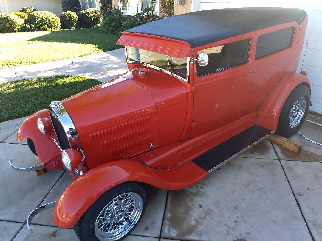

    In late November I bought the Danny Brent 1928 Model A Sedan which some were searching for as it was wanted for the Grand National Roadster Show. About a week ago I go the car back down on the road and found that the wheel/tire on the left protrudes past the fender, but on the right the tire/wheel is tucked under. My guess is wen the car was impounded last year, the tow company pulled it at an angle by the front axle, or the car was in an accident. I am guess the connection points for the wishbones may be damaged or bent, or that the front spring is not attached or the spring perch is bent. What can I do to get the left/right balance back in line?

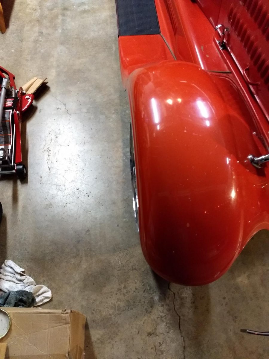

    Looks like the fender is damaged to me.

    Yes, I can see it now. The left fender has a good portion of the lip missing above the tire. What is going on there? Is the whole fender bent inward?

    yet the wheel sticks out past the running board on one side, and does not on the other side. As usual, there's more than one problem here.
    And we have yet to see pics of what might be going on under the front sheet metal.

    Alchemy, looks like the lip is rolled under.

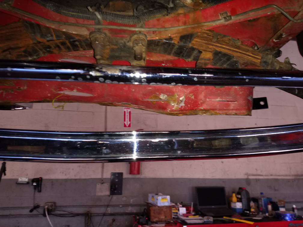

    Okay I probably took way too many pictures but here is a group showing different portion to the front suspension. It does look to me like the shackles are at a different angle. I measure the offset on the wheels and they are the same. I do notice that my wishbone brackets, one of them tends to go more straight down then the other. The one on the right tents to flare out from the frame possibly to clear the exhaust where I was the one on the left seems more straight down. IMG_20190104_153400379.jpeg IMG_20190104_154451284.jpeg IMG_20190104_154447932.jpeg IMG_20190104_154445290.jpeg IMG_20190104_153724040.jpeg IMG_20190104_153417704.jpeg IMG_20190104_153827516.jpeg IMG_20190104_153809814.jpeg
