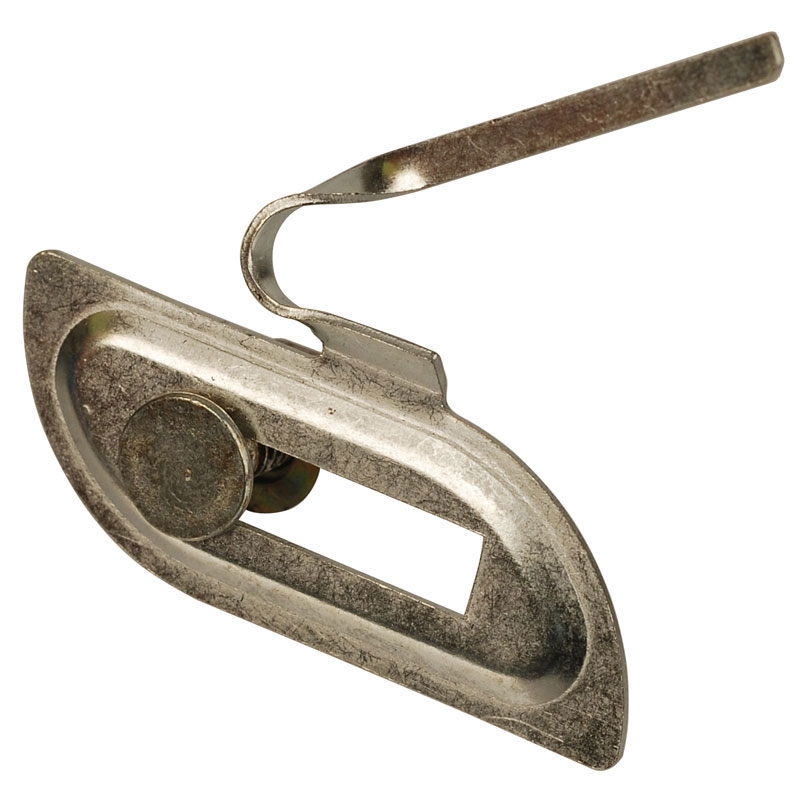

    Don't believe there are any clips with nuts, the clips go into a hole and then twisted 90°. The trim then snaps over that....I'm just having trouble unsnaping it.

    I'm working on my 53 Lincoln right now, and am surprised how many "snap on" clips hold the stainless trim on. This type clip, when installed, you put the trim over the top part of the clip, push it against the body, and down, to get the trim edge behind the clip, then push the trim onto the body, and it snaps over the bottom part of the clip. To remove, do the opposite. If your clips are in good shape, you need to push down on the trim to clear the bottom part of the clip, then when it clears it, push the trim up, and off.

    A lot of replacement clips have a nut and stud instead of the original snap clips, so if the car has ever been apart before for paint or whatever I wouldn't count on the original clips being in there.
    Also, many of the cars of this era have a clip on the far ends of the door molding that goes through the outer lip of the door and is held on with a phillips head screw. Even if the rest of the clips are push-in snap type, those will have to be removed first.
