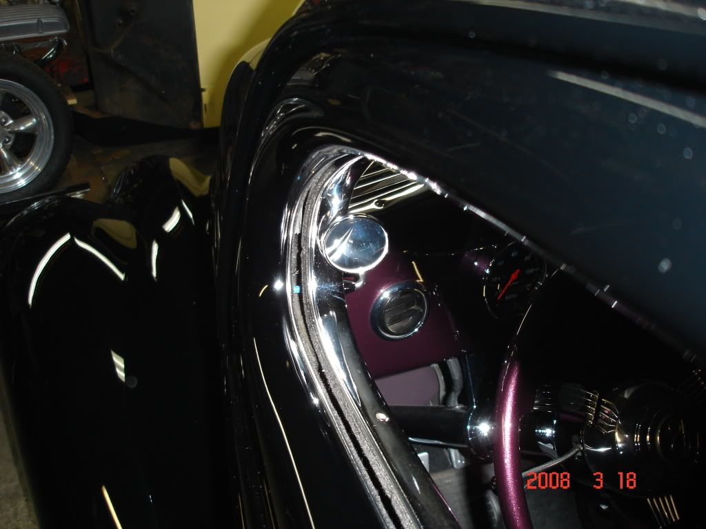

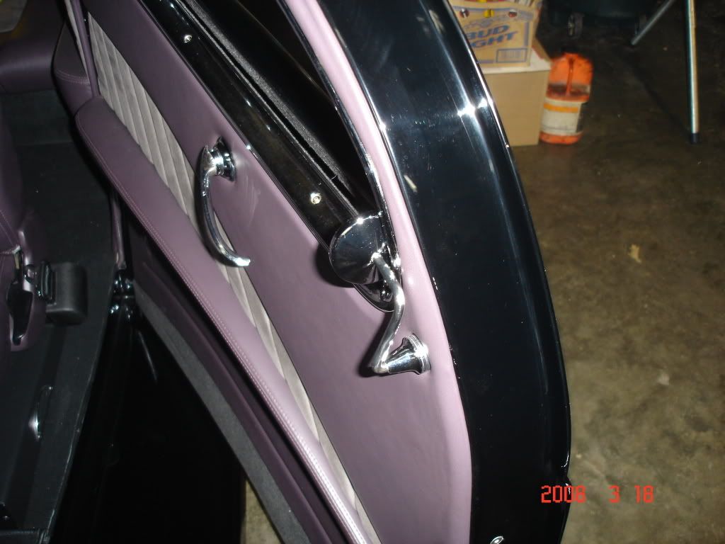

    Heres a couple pics of the mirrors I made for my 37 sedan about five years ago, they mount inside on door panel, at the front edge of garnish molding. I bought 2" stick on peep mirrors at local auto store for about a buck a piece, and took them out of their plastic cover. I made the outside mirror housings and inside door mounts from aluminum, and bent the mirror arms from stainless. They work OK, and are sure as hell better than nothin, but they sure are one hell of a conversation piece. :cool:
