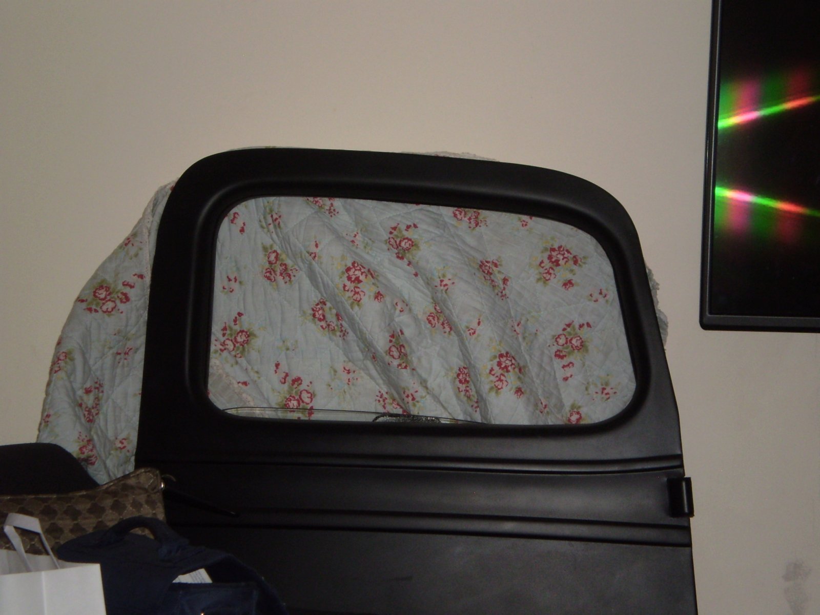

    upload_2022-9-28_22-0-51.jpeg .heres a pic of my p***enger door.the way i see it i could mount a mirror on the top or just above the upper hinge.i tried out some peep mirrors but not to my liking because they are too small too short and the mounting is too flimsy.it would soon be off after damaging the paint.im thinking i need a bigger version of a peep mirror that bolts to the door.mt trucks a 38 chev pickup.the A pillars are closer together than the B pillars so they will need to stick out enough to get a good rear view.mirrors are 5" round from jim carter with flat gl***.id like convex gl*** for a better view.driving a lhd vehicle on the left means i need 3 good mirrors.my rear view mirror is a 2003 vw golf item.high quality item with night dim with great vision.my truck is nearly all black so probably make my mirror from stainless steel and powder coat it black.i can source high tensile slotted countersunk screws to keep everything traditional looking where possible.if i remove the window channel i might be able to access the inside of the door for the mounting.if i drilled and tapped a plate for the inside of the door i could do away with nuts etc.i have recently aquired versachem 2 part adhesive would use that to hold the plate in place once the mounting is finalised.goes off in 4-5 mins so would need to move fast
  3. nunattax
    Joined: Jan 10, 2011
    Posts: 3,394
    nunattax
    if i mount it above the door hinge access is good inside the door,could stick a plate to reinforce the door drill and tap there would be no need for nuts inside the door.cmon guys lets see what you have done

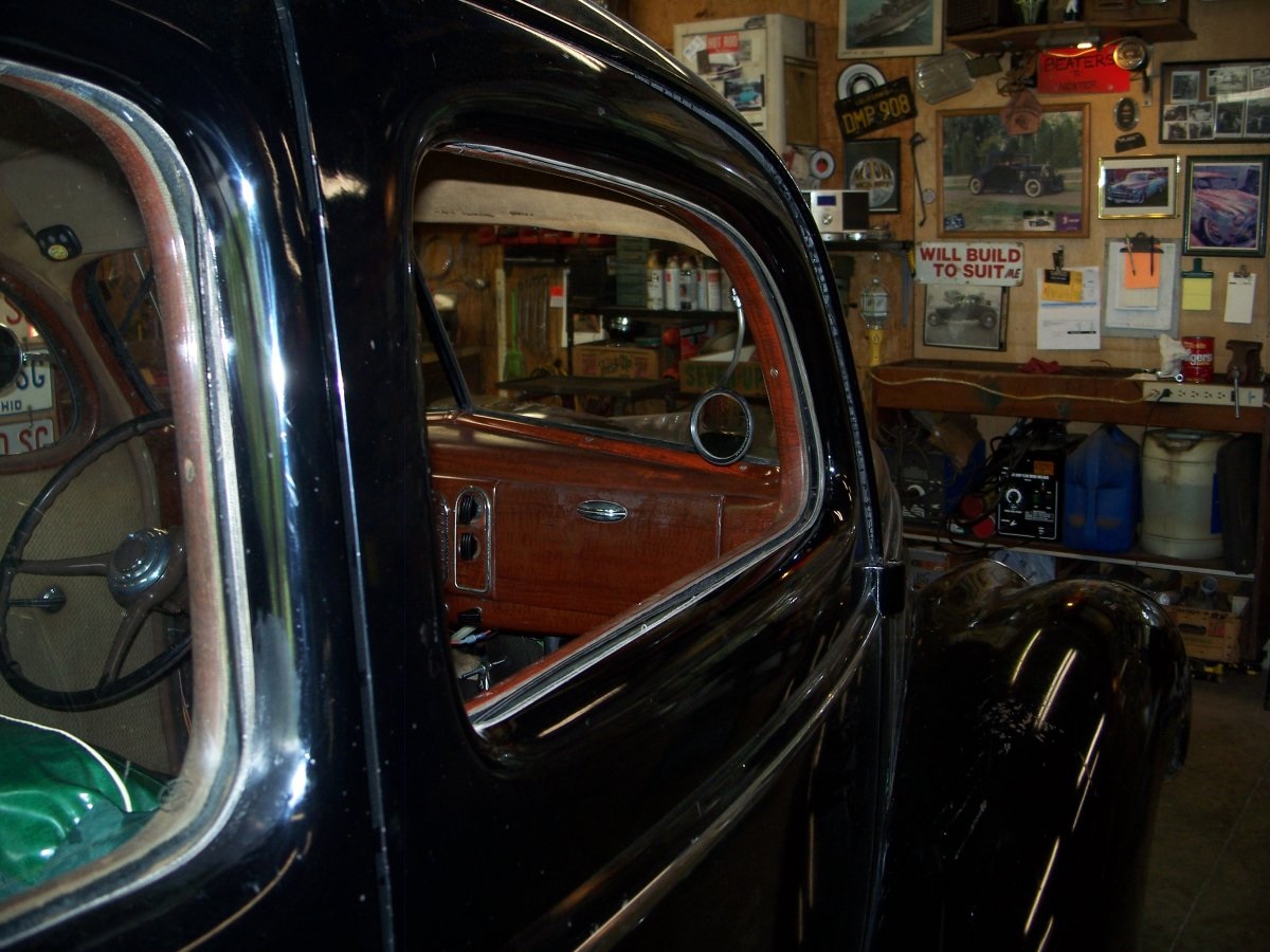

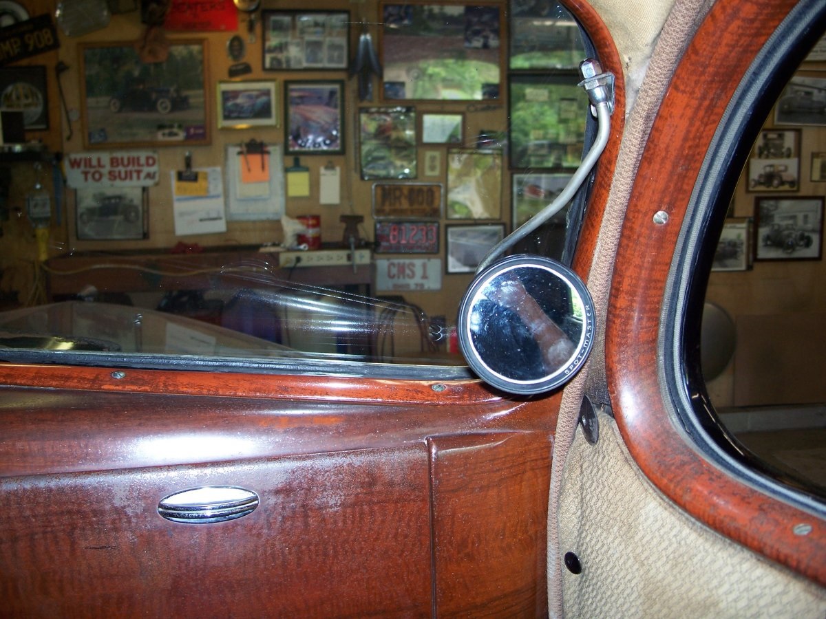

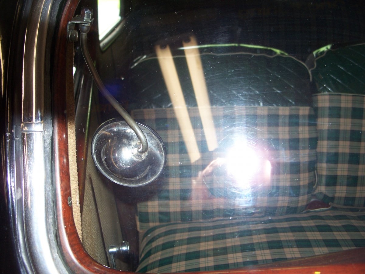

    Mount the mirror on the *inside* oriented so you can see behind/beside you like this:
    inside pass mirror 01.jpg inside pass mirror 02.jpg inside pass mirror 03.jpg
    WalkerMD likes this.

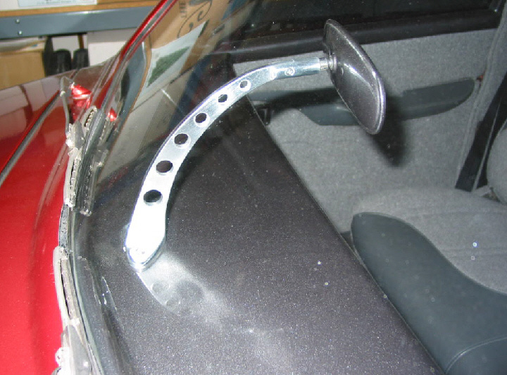

    This is what I have, the p***. side had a mount on the fender so I went with that and just made a arm. It needs a brace and that will come this winter. The drivers side had the factory mount in the door and the original arm was broken off. I made a new arm and welded it to the remaining original. These big gaudy mirrors fit this truck perfect ! IMG_0033 (2).JPG IMG_0032 (2).JPG IMG_0034 (1).JPG
    RMR&C, nunattax and VANDENPLAS like this.

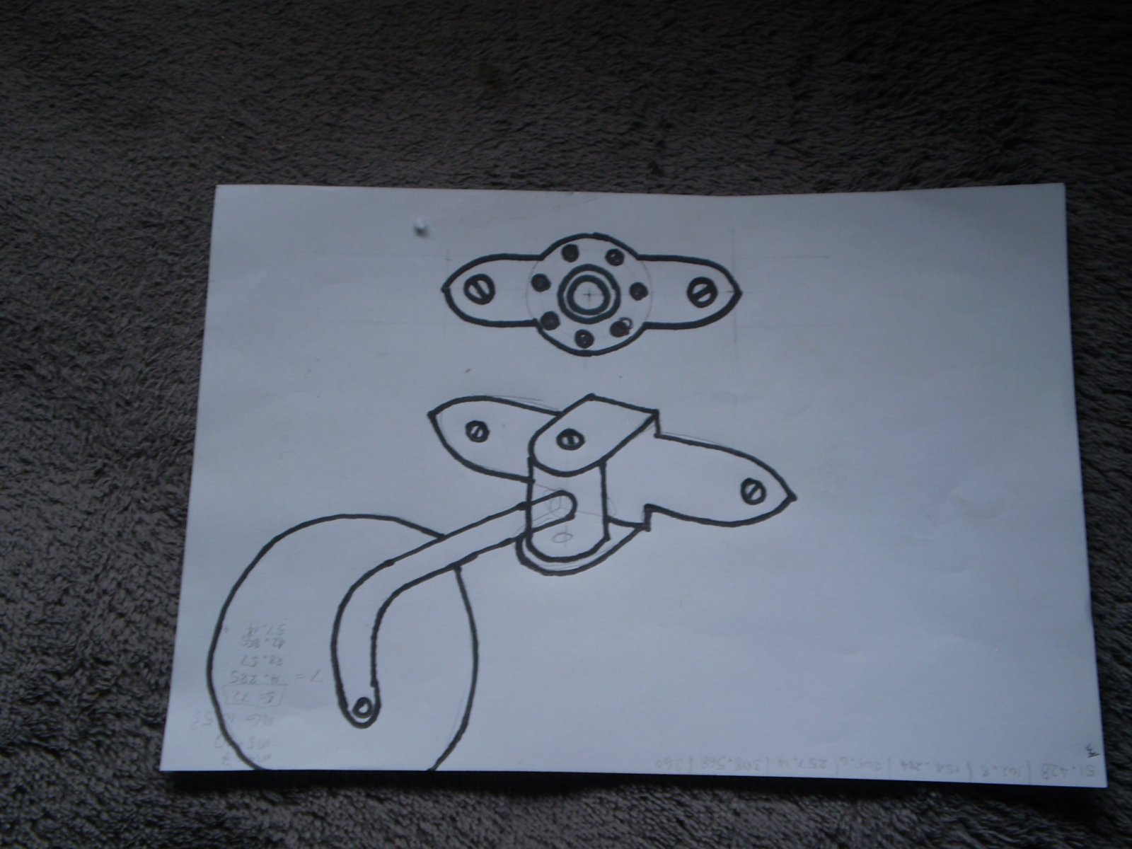

    upload_2022-9-30_22-57-46.jpeg heres a sketch roughly to scale of what im thinking.the mirror head is a 5"item from jim carter in black.stem is 12mm tube probably 2mm wall but maybe heavier wall depending on whats available.supplier closed at 4pm today.i work on later than that.stem will thread into the bush welded to the mounting plate.mirror mounts with 1/4 thread bolt to the stem.im thinking a threaded bush welded to the stem .sketch of a section through the door top may not be 100% accurate.id like to get a plate inside the door section but i dont think this can happen without cutting into the door.so my alternative would be 2 /3mm plates. inside plate would be stuck to the door with versachem 2 part adhesive ( strong stuff) also held in place with 2/ 4mm countersunk screws .door skin is approx 1mm.the 4mm countersunk screws would really be holding the plate in place while the adhesive set giving it a mechanical fixing also.
    TFoch and ccain like this.
  24. nunattax
    Posts: 3,394
    nunattax
    mirror stem would be threaded at the door end .the threaded bushing would weld to the outside plate 3mm stainless the outside plate would fix to the inner plate with domed slot head bolts (high tensile steel)inner plate would be drilled 4.2 mm and tapped 5mm.drilled and tapped after stuck to the door skin. for maximum grip.eventually loc***ed in place (loc***e 222 for small threads)id want the stem as short as possible to keep vibration to a minimum.as drawn maximum amount of lens would be in my eyeline.because the B pillars are 8" wider than the A pillars .the stems need to be 4"long plus 2 1/2" minimum length. to the centre of the lens.might take more than 1 attempt to get it 100%,but ill be pretty sure before i go drilling the doors.ive a couple of jobs to do finish dash wiring for one before i replace the doors on the cab to get moving on the mirrors.when/if i finalise the design ill send away for satin black powder coat on the parts for a stealth traditional look c

    i feel mirrors suspended down from the door tops are a better option offering increased visibility with shortest stems to reduce vibration.if at a later date i come accross convex gl*** in an oval mirror with offset mounting ill surely upgrade the parts.thats hotrodding

    the swan neck look suitable.could be mounted on the top of the door frame ,if swapped over left and right.thanx for the photo it shows the taper on the cab.very similar to my 38.your mirror heads have offset mounts allowing more alignment.i have a set of clip on peep mirrors but im going to use them on the lawnmower,not very good at all.on the 38 cant see past the side of the door.

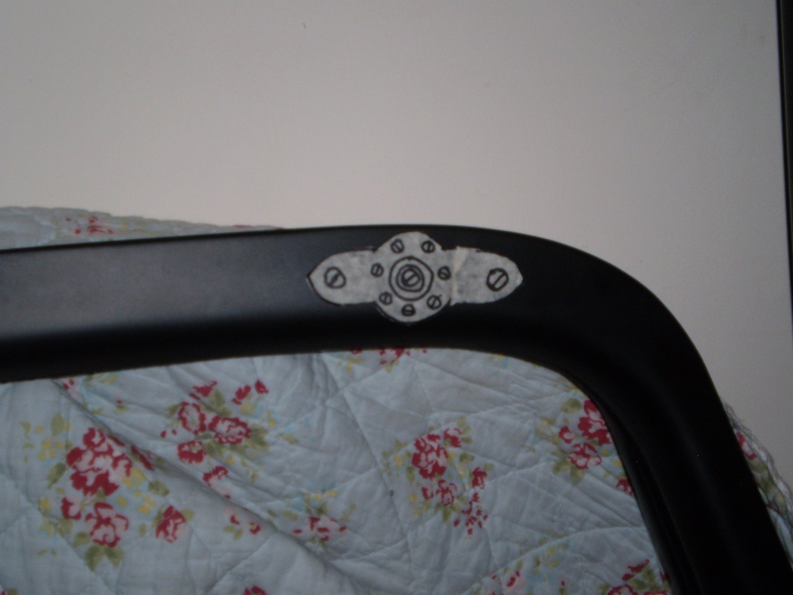

    upload_2022-10-1_13-48-12.jpeg .cut my sketch out and laid it on the door.first impression is its too long overall.ill keep the diameter of the centre but reduce the front and rear tabs maybe remove the sharp corners to make it easier to cut and sand it.if i get them laser cut it ill be waiting ages so have to go oldschool route and cut it myself .also the 7 m4 domed nut will need to have one at the very top so i can drill and tap through the double thickness of door skin at the top.the m4 and m5 bolts are a fine thread and should give good grip in the thin door skin.
