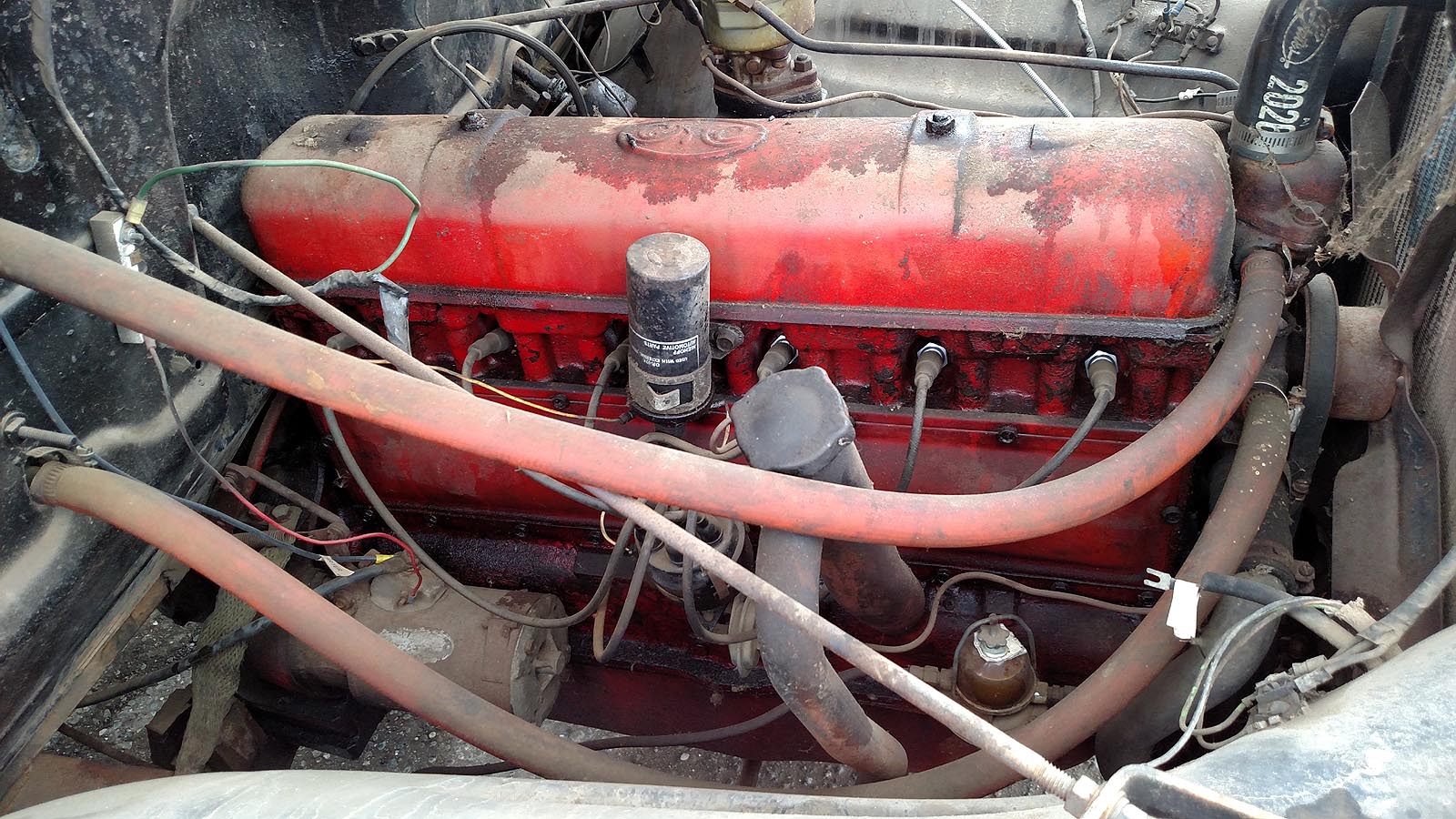

    Jimmy six and Chevy stovebolts often have coils mounted upside down. Sometimes, plug wire sets for those engines have coil wires so short, it's the only solution. engine-right.jpg
