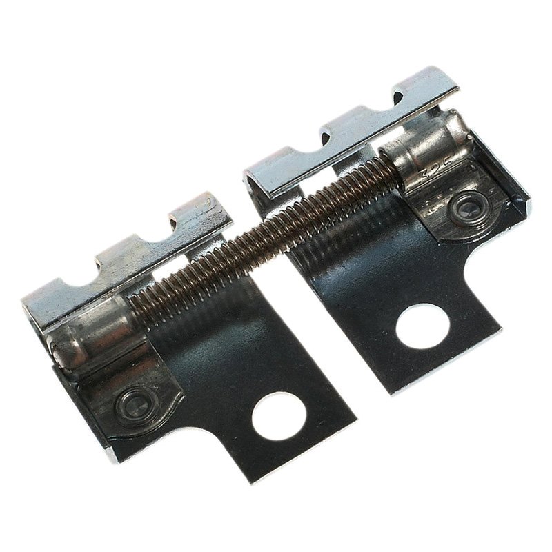

    Not that it has anything to do with the problem under discussion; but
    Ford used ignition ballast resisters; under the metal shield on the inside of the firewall in the '30s and under a similar shield mounted right on the coil in the '40s; I don't know if they continued later.

    from Napa
    Yep, looks just like the resister on the 9N-2N-8N and some later 6V tractors- even my 850 had one
    Blues4U and 2OLD2FAST like this.
  7. G-son
    Joined: Dec 19, 2012
    Posts: 1,553
    G-son
    from Sweden
    Any particular reason?

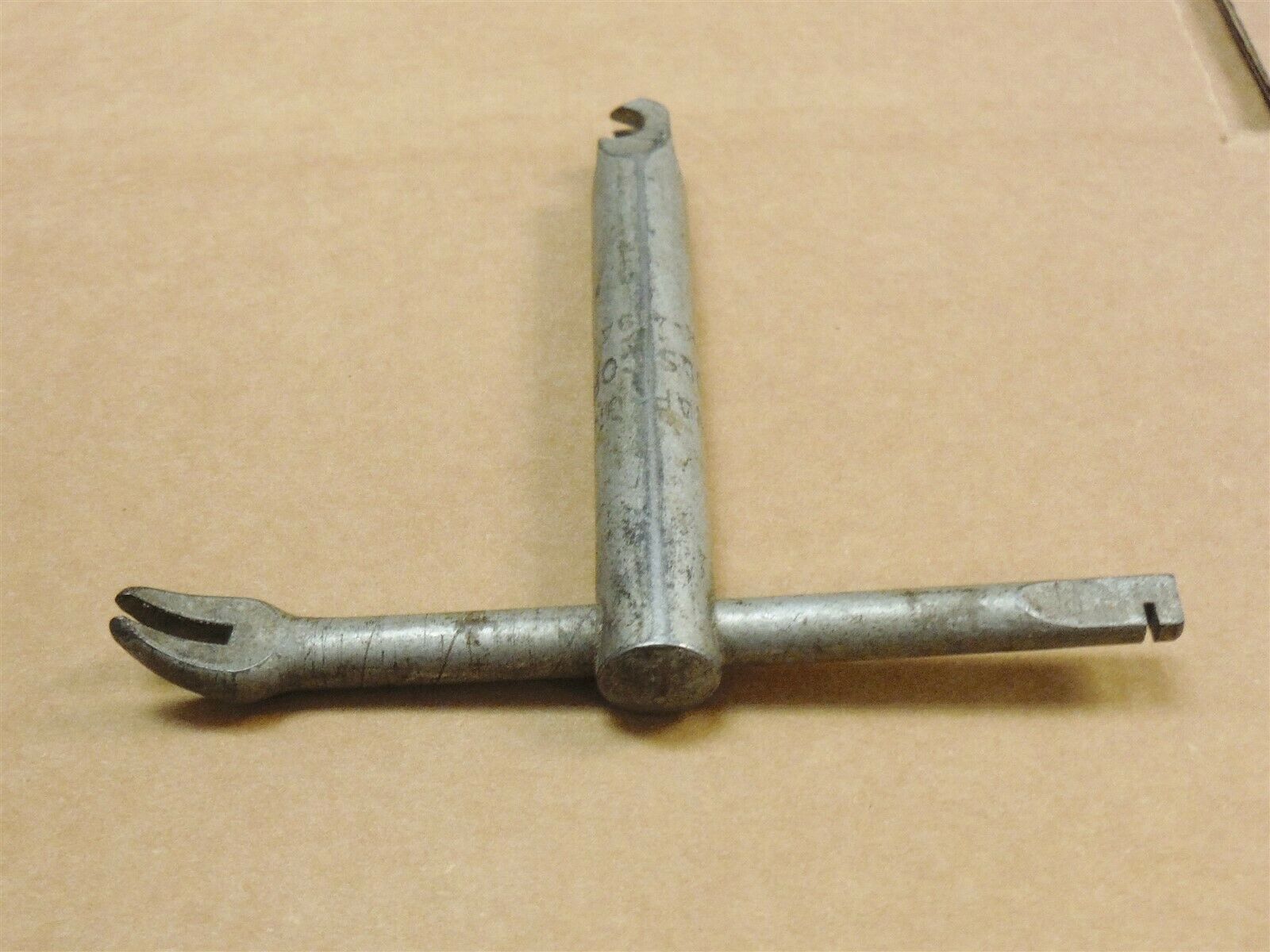

  10. bigdog
    Joined: Oct 30, 2002
    Posts: 841
    bigdog
    Sorry for the off topic post, but since this picture was posted.... There is a tool for alinging points. It used to be standard procedure to check every set installed. And there's even a tool for doing it. Mine vanished years ago, but I found a picture on the interweb.
