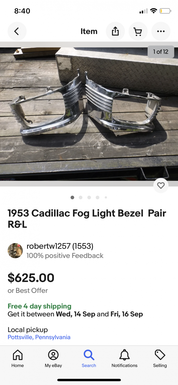

    I’m presently restoring 7 x 53 Eldorados all at once.
    Pot metal exterior parts have presented many problems in even sourcing repairable parts.
    I’m looking at replicating these parts in resin or fibregl*** and then chrome by use of graphite coating to hold electric charge.
    Anyone got any tips or previous success using silicone mould and subsequent casting techniques?
    I have access to a nos pair of these fog housing. Finding a decent pair these days is nearly impossible and I need at least 5 good pairs.
    These ones are on eBay and will require substantial repair before they are able to be chromed. 8C5A7E6D-53BB-404B-836B-DF0AA08AAF32.png

    For something that size, is resin shape stable?

    I think it can be done. But there are many types of resin so you have to choose the right one. One that does not warp on a hot sunny day and that is not too brittle.
    Or maybe it could be made with a 3D printer?
