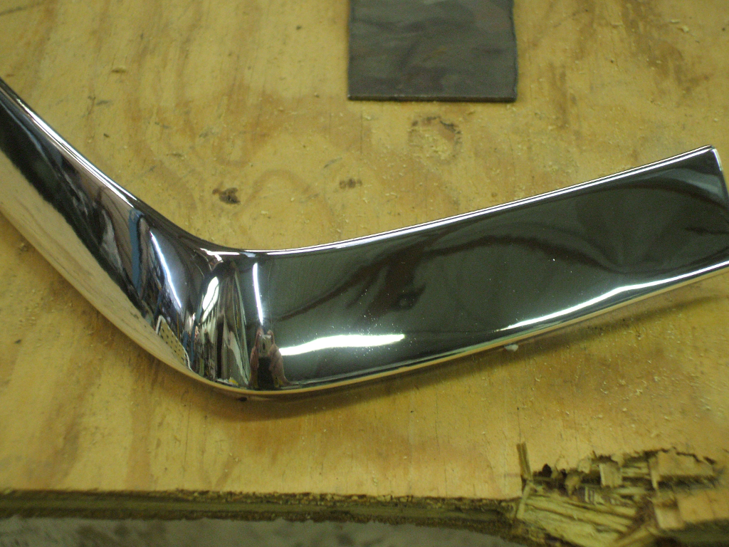

    We used www.coatofchrome.com in PA to finish 30 interior trim parts on a '61 Olds. We thought all the pieces came out looking like real chrome. I would hesitate to use this for exterior bumpers or trim because it can fade or chip.

    Put the "chrome" powder coat to bed. It doesn't look anything like chrome after the protective clear coat. Very short life without the clear coat. Cost was about 1/4 of chrome.
    Left side is "chrome" powder coat
    Center is triple show chrome
    Right is polished stainless
    The spray on stuff is basically what is on the back side of a piece of glass to make a mirror these days. Low durability.
