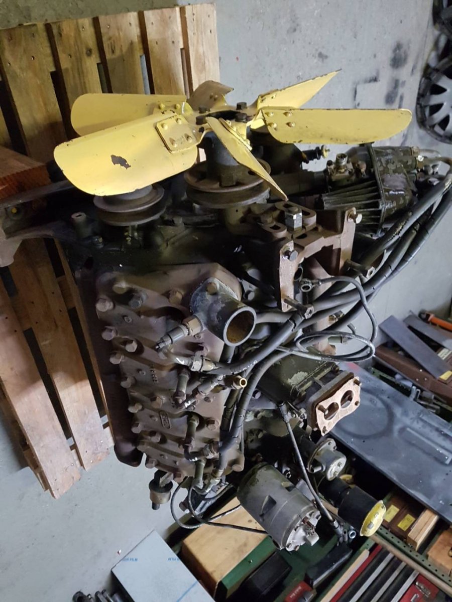

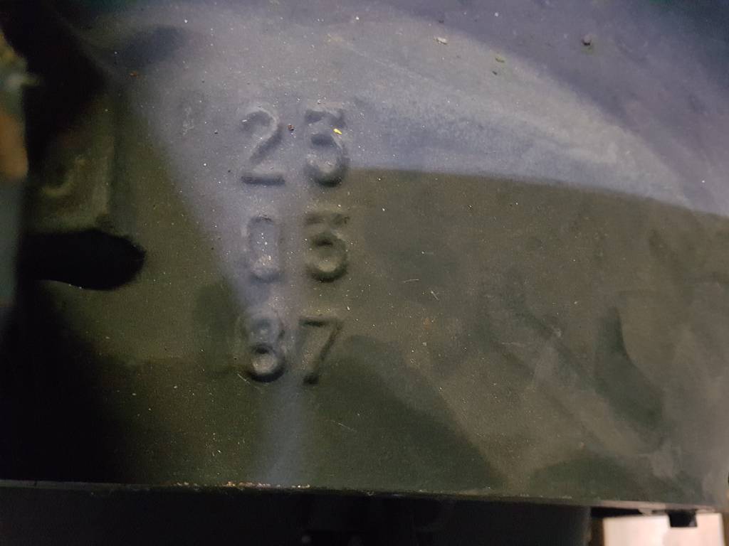

    I've just picked up a nice 30 year old flathead V8 for my next project.
    It's a French Simca Marmon (Ford) flathead V8 cast in March 1987.
    It came out of a decommissioned French military light truck. It's got the air compressor mount up front so fingers crossed, it's a long stroke engine.
    It's a low hours engine so we'll see how good it is later after strip down.
    Obviously it'll need a normal ignition from Bubba. A p***enger oil pan and starter and a decent 12V generator.
    The remote oil filter is there, just needs relocating.
    Hey - there are some advantages living in Europe. 20191001_141919.jpeg View attachment 4437114 20191001_141937.jpeg 20191001_141946.jpeg 20191001_141956.jpeg 20191001_142008.jpeg

    Cool! Is it a 4" stroke? A 59a pan should fit.

    I believe the ones that had the sump pickup up front were 4", at least mine was. Bob Drake or others truck water pumps bolt right on. Actually, the hole block is SAE threads, only the exhaust studs have 10mm theads on the nut end, sae in the block. Hint, leave the studs in, they are a ***** to get out.

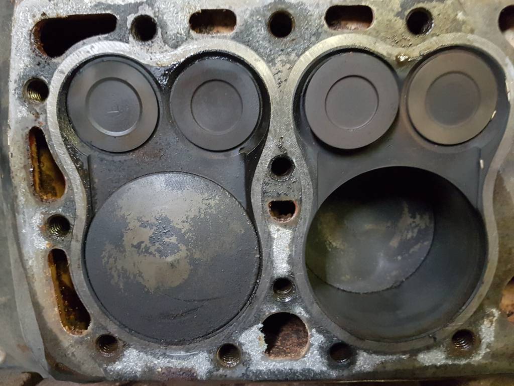

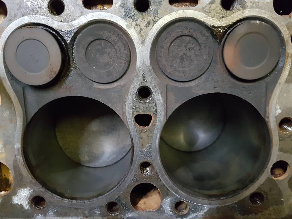

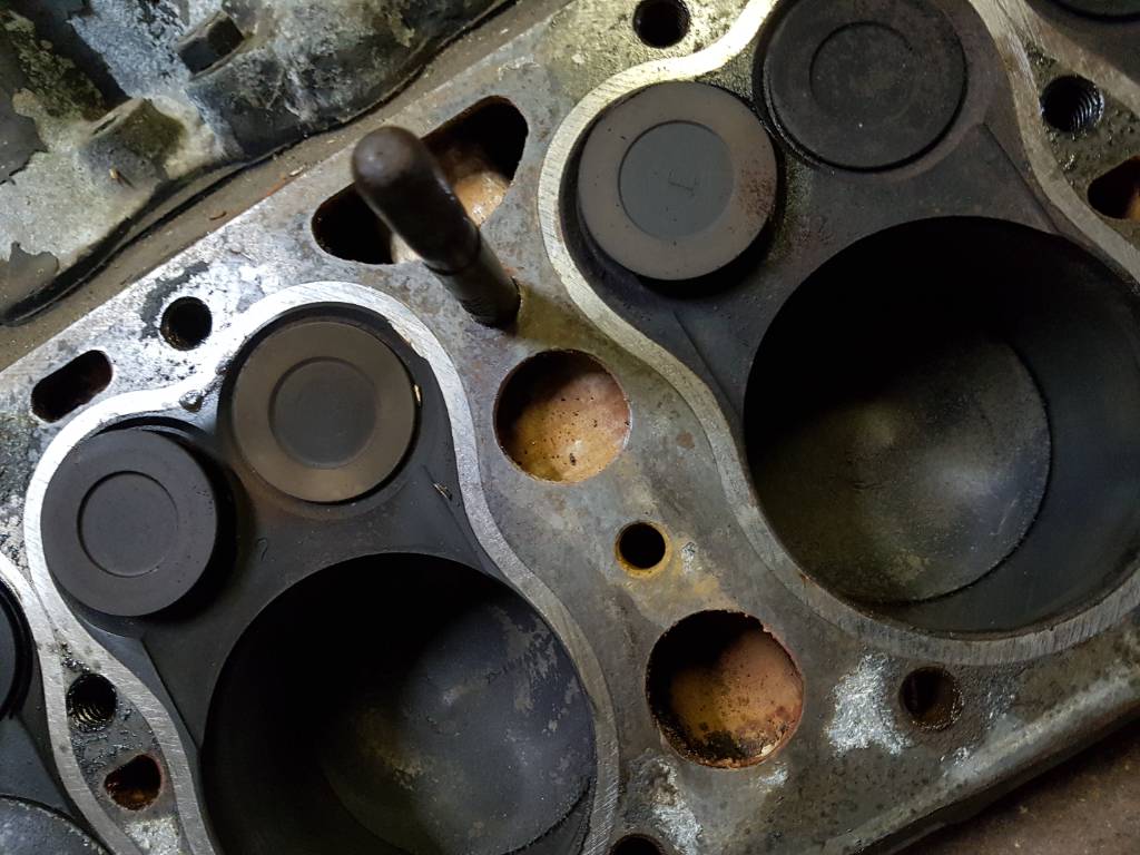

    I got the first head off. No ridge or scoring in the cylinders. Valves look clean. This looks like the low hours on this are true. 20191001_155740.jpeg 20191001_155749.jpeg 20191001_155842.jpeg

  7. edwardlloyd

    That's the way it was built. It's stock with just 311 hours on it. And it does have the 4" crank. It's built for torque so maybe it doesn't breath as well as a Mercury. Anyway it's going in the Model-A completely stock.
    It'll get headers, and new distributor and a single 94 carb. It'll be more than enough for a Model-A rear axle anyway.

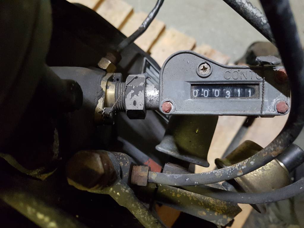

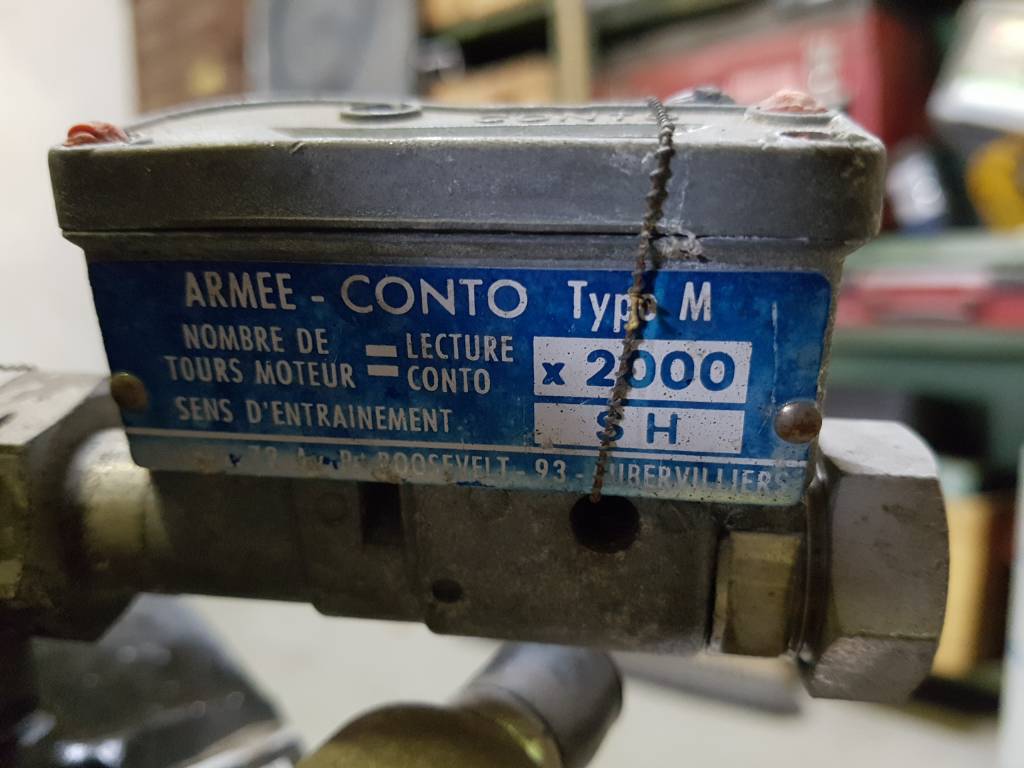

    just for the record as its often stated wrong, those arent hours, those are engine revolutions times a factor written on the conto's side.
    yours is kinda new. I also have two comparables from 79 and 86 freshly French mil rebuild.

    So it would appear the engine has done just 622,000 revolutions in total. Which at 1000rpm average means just over 10 hours.

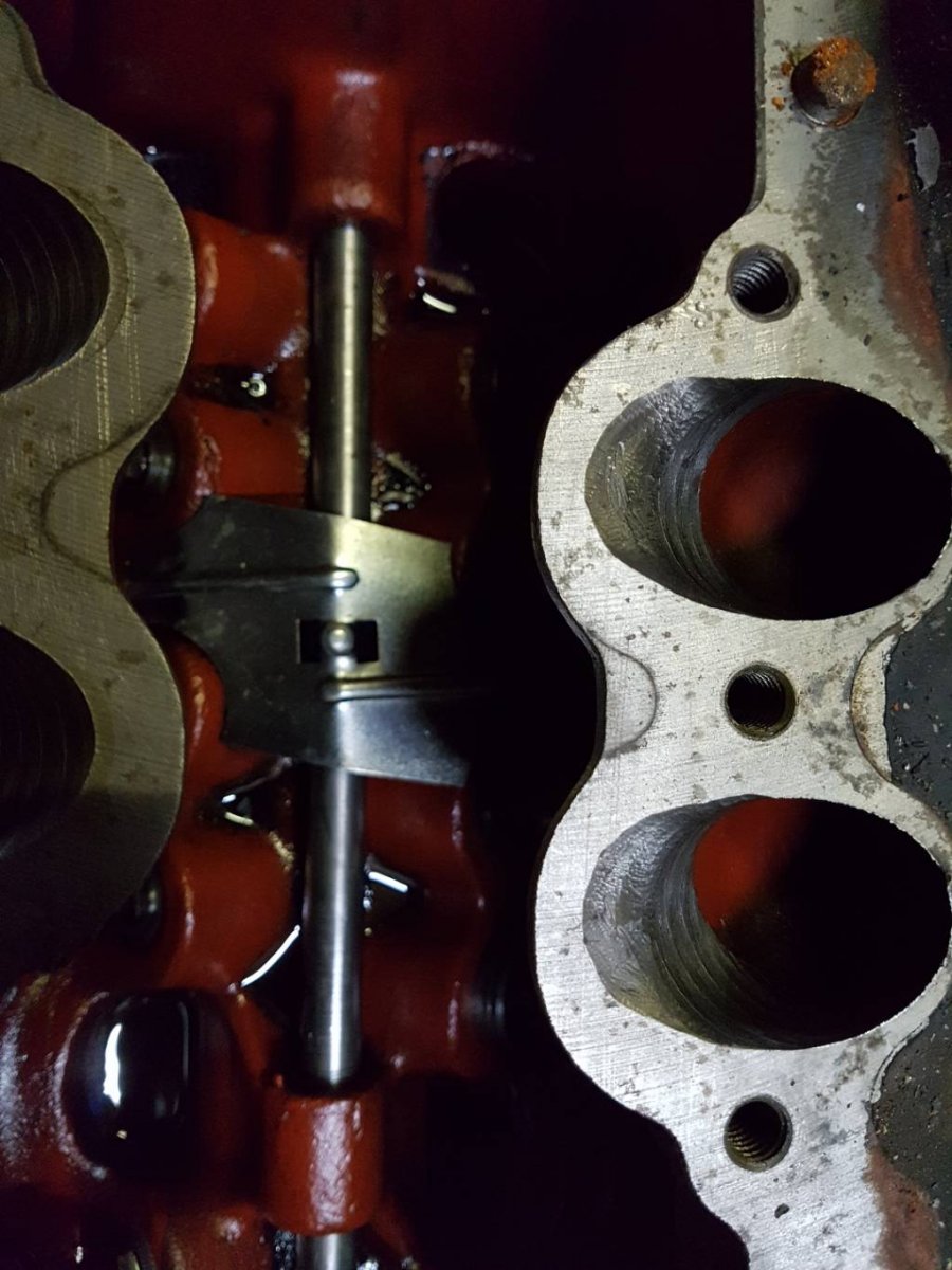

    I just removed the intake. Looks like brand new inside. Looks like someone has worked on the intake runners to improve flow. 20191002_132126.jpeg 20191002_132140.jpeg

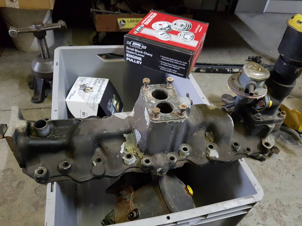

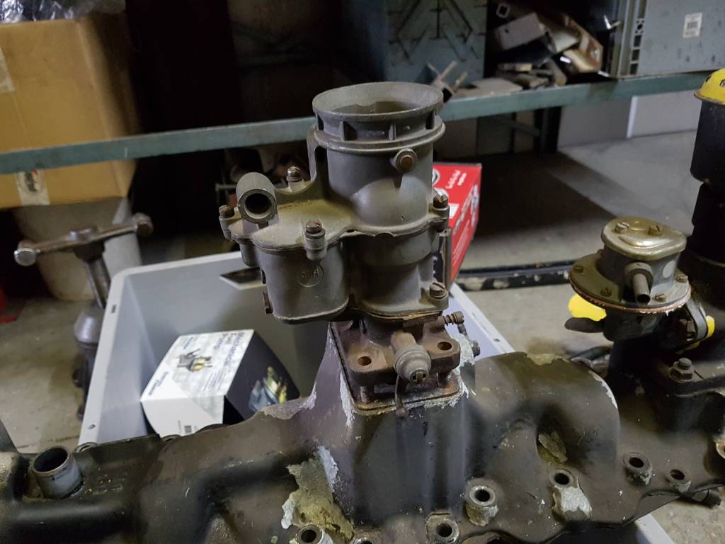

    I think I'm going to use the original intake manifold. It's aluminium but has a 4 bolt carb base. I've offered up a 4 bolt Lincoln Zephyr carb and the bolt pattern very nearly fits. About 1mm off so I could drill out the base holes a little.
    The Zephyr carb offers a little bit more flow too. 20191002_132914.jpeg 20191002_133240.jpeg

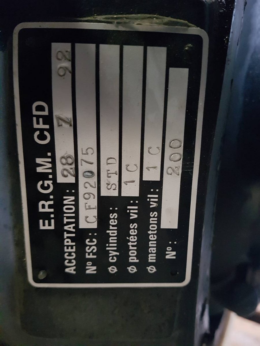

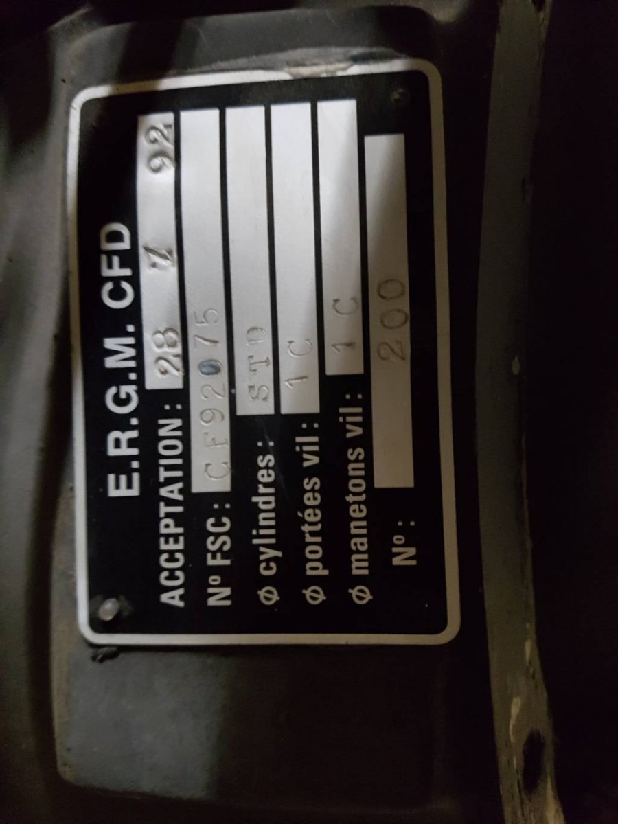

    It looks like it was ***embled in July 1992 even though the casting was already 5 years old at the time. 20191002_135935.jpeg

  26. FlatJan
    Joined: Dec 13, 2013
    Posts: 323
    FlatJan
    it was made/cast in 87
    No this is the rebuild plate. So it was rebuild by french mil in 92 in clermond ferrand.
    cylinders are standard, crank- and camshaftjournals are in first undersize.
    ports are always like this.
    i think i know who you got it from ;)

  27. edwardlloyd
    Joined: Aug 2, 2003
    Posts: 2,074
    edwardlloyd
    from Germany
    So I guess the revolutions counter was reset during the rebuild. That would explain it's fresh condition then if it was rebuilt in '92. Still, stock pistons means it hasn't covered much mileage.

    The HAMB is such a labor saver! This just saved me from trudging down to the ba*****t to introduce a French manifold to a Lincoln carb!
    "I think I'm going to use the original intake manifold. It's aluminium but has a 4 bolt carb base. I've offered up a 4 bolt Lincoln Zephyr carb and the bolt pattern very nearly fits. About 1mm off so I could drill out the base holes a little.
    The Zephyr carb offers a little bit more flow too."
