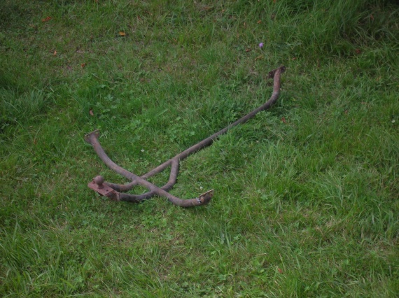

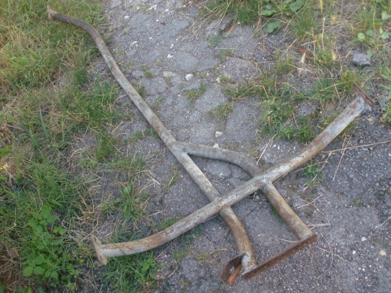

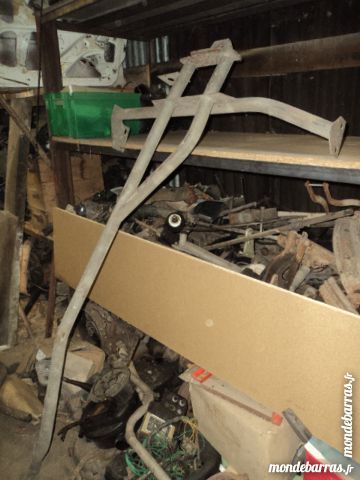

    Hello, Nice car!
    In France, Ford sold to Simca in 1954 and the name is Chambord or Beaulieu.
    Found this below after a quick research on the web.
    chambord attelage1.jpg chambord attelage1.jpg chambord attelage3.jpg chambord attelage4.jpg chambord attelage5.jpg
    Hope it help!

    The hitch Pat is showing shows how you need to “ grab” several places to distribute the stress on unibody cars. You will probably have to build something similar to that.
    It you look close, those seem to be three different hitches! If three were made that close together, the most likely are a “ manufacturered “ hitch! Should definitely be the way to go!

    Thanks Patrice, that's really helpful. Bones you are right, I suspected that just rear mounts were not going to be enough. Will have to get underneath and see what I can anchor to. I have a plastic fuel tank out of an Aussie GM car and also the diff so things are a bit different under there from stock.
    Need to make something that can be sought of hidden when not used.
    50,s Aussie holders had a fold away tow bar that pop up now and then for sale, maybe something like that. I'm sure I can design and make it, just want it to have the correct strength for towing.
