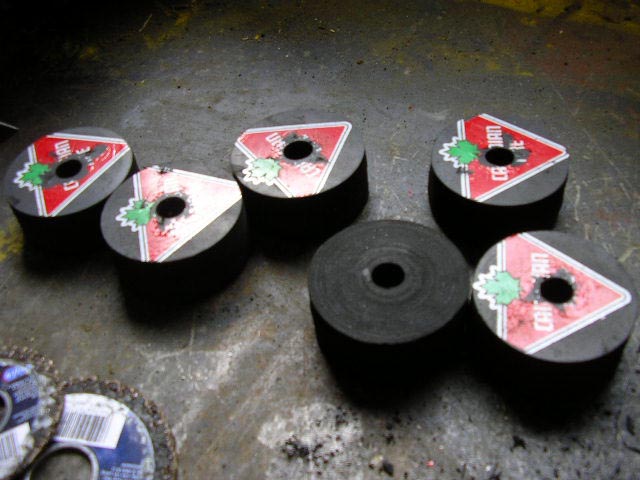

    Just made up some body mounts today for my sedan. Pretty easy without any work so I thought I'd post..
    1st, I used some inners from my last holesaw cutting. Nice thing about them is that the hole is perfectly centered.
    2nd, I used my 2.5" holesaw to cut down some hockey pucks, has I read on here they are a good type of rubber to use. With the holesaw the center pilot hole is perfectly centered too.

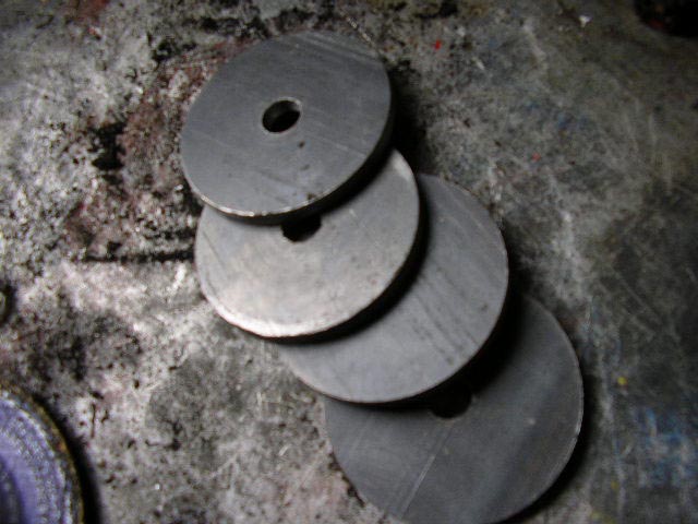

    3rd, I cut out some right angle triangles out of some 1/4" plate

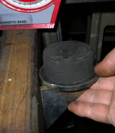

    4th, I made a jig out of some angle iron laying around, bolted some 1.5" square tubing to the circle plate and jig to space the gussets right, the laid the gussets there and c-clamped them in place and welded, perfect 90 degrees.
    5th, since I'm paranoid I welded the inside of the gusset too. I just used some more tubing to keep if from warping.
    6th, Theres what it looks like with..
    7th, I didn't get a chance to weld them to the frame today but what I'll do is just lay a small piece of 1/4" steel on top of the frame and lay some tubing across the rails and clamp the mount to it and weld it on. Giving me a 1/4" of space for the rubber.
