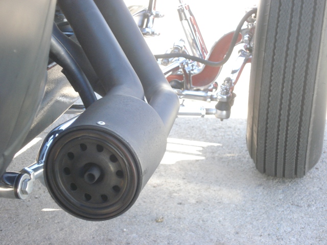

    Very nice work there.....check out my hillbilly baffles ! ! used a fram oil filter cut the end off, shoved it up there.
    cut the open header noise back only 20 percent but cops see it as a baffle. the tuning was un affected, used fram because casing is heavy duty.

    I've always wondered what Fram oil filters were good for, now I know. Thanks Mr. Haney!

    Haney, does the engine run OK under throttle with that much restriction in the pipe? Cheap solution for sure, but man, those holes don't add up to much area.
