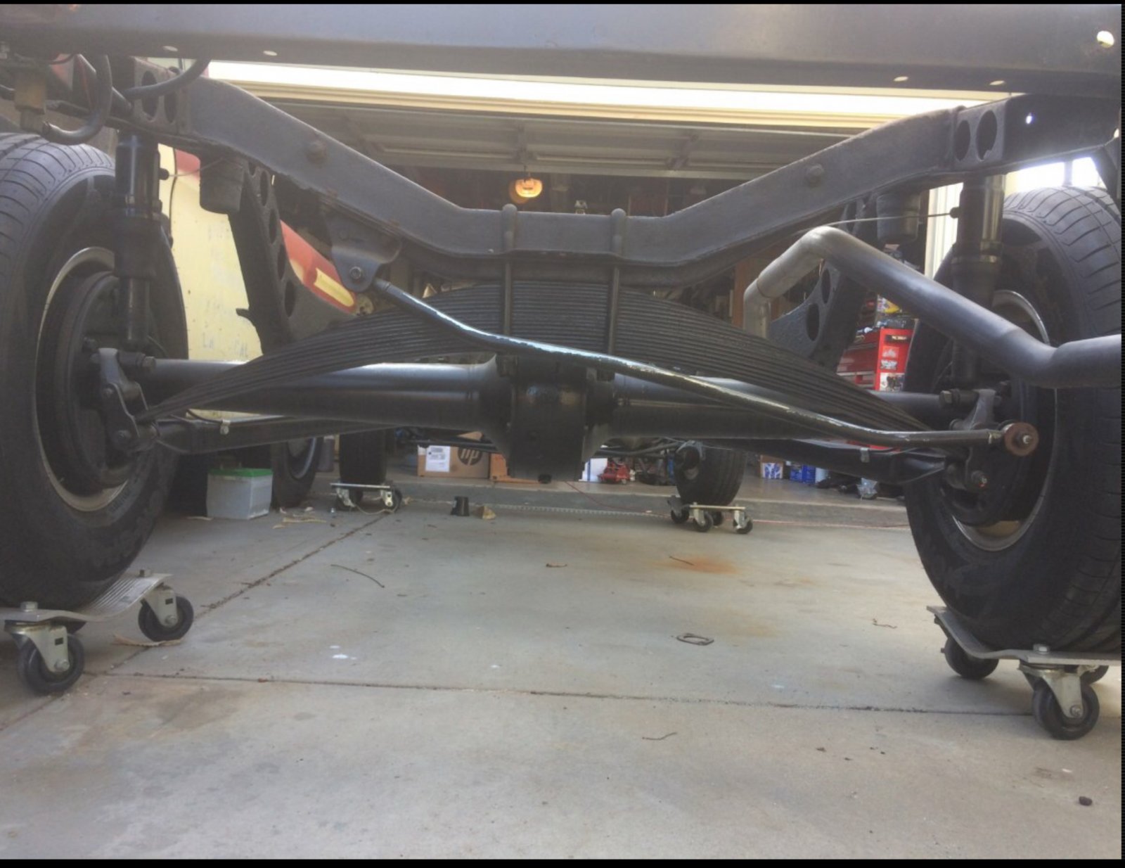

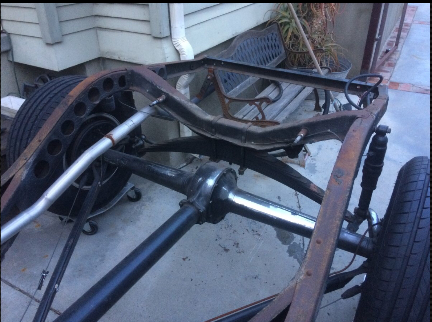

  3. Some of the aftermarket frames have very short panhard bars.
    I have a leftover one hanging on the wall fwiw, not sure where it came from since I make my own, but it's shorter than I like.
    When you think about it, the panhard bars transverse motion is not really felt.
    Some of the short ones noted above have more transverse motion than you do and I haven't heard anyone complaining about it
    Granted, these are on coilover cars, but that really doesn't affect the panhard bar other than being part of the packaging problem.
    To toss another factor into the mix, most of us are running lower than the usual rear tire pressure in these lightweight cars and that will dampen out some of the transverse movement of the chassis.
    Especially when running big radials at 20# like I do. (285/70R-15, 30" diameter.)
    Along with coilovers on the 32.
    I realize you are running bias, but much the same thing will happen with your car.
    A little less pressure makes for a less stiff sidewall and kicking the rear out the .21" or so won't be felt at all.
    I don't think that small amount of transverse movement will be noticed even if you hit a bump on a "let it all hang out" corner.
    What seems to happen on some (especially high tar strip) bumps is the rear axle leaves the ground for a short ways and when it comes down the car is pointed in a slightly different direction.
    Easily handled if you let it happen or saw on the steering wheel a bit so the car travels straight over that area of the curve.
    So, here's an interesting personal experience and one of those little screw-ups we all get involved with now and then.
    I did pretty good on the final assembly of my 32.
    No bolts came loose, nothing leaked and no electrical probs after startup.
    I'm a patient guy and work alone most times.
    Where I did screw up was, the bolt on the rear axle housing panhard bar mount wasn't long enough to fully engage the nylon in the nylock bolt and eventually backed off.
    Said panhard bar mount on the axle housing is tall enough so that the bar is almost horizontal.
    The way the bolt goes in, there's not room for it to fall out when the suspension is loaded.
    Interesting part was, with the panhard bar effectively disconnected there was quite a bit of transverse travel, but the tires didn't rub on anything.
    Nor was there any weird handling attributable to the now excessive transverse travel of the chassis.
    Part of that due to the flexy sidewalls of the rear tires masked the chassis sway to an extent.
    Granted, not a recommended way to run a panhard, but interesting and perhaps useful to this discussion.
    A new bolt 1/2" longer did the trick, along with a new nylock nut.
    As noted, bias plies will probably reflect the transverse chassis movement a little better than a radial due to the stiffer sidewall.
    While this has been an interesting discussion as well as some interesting math being brought to the fore, I think that in the real world - especially since your panhard bar is a reasonably practical length, bend or not - it doesn't make any real difference in the real world....

    Nope....the trianglation of the P&J ladderbars keep side-to-side movement to a minimum....for the most part. The spring, under the weight of the vehicle, will keep it in check.
    Panhard bars, generally, aren't needed.....
    My PU had the same setup. You could rock the truck side to side and get some movement when parked, but going down the road, it drove just fine and rode great.....
  15. ratster
    Joined: Sep 23, 2001
    Posts: 3,611
    ratster
    mine on my roadster is built the sameway as Bass did. it's been on it over 10 years and its not bent or stressed. nice job Bass

    I don't know how I came upon this thread, but I'm glad I did. First off, Mr. Bass does great work. A couple weeks ago, I installed my panhard bar set up on my T Bucket chassis. In my opinion, it seems like I could use a bar with a bend in it, like Bass did. BUT.... not only is my chassis not completely done, it also isn't set at ride height yet. So, I'm probably two steps ahead of myself and sweating nothing.
    Another thing Mr. Bass stated was that the weight of a hot rod is quite a bit less than the average car. Since welding in my panhard bar set up, I've been searching the net and even made a trip to a shop and asked about panhard bars in light weight cars. What I found was, "The results can differ, depending on application." In other words, it's a little trial and error, mixed in with good judgement?"
    My past T Bucket had a Watts Linkage. After installing it, everyone said the bars should be horizontal under load. Guess what? Mine NEVER ended up horizontal. Not even close. I never had any problems and I drove that car every where and almost every day. I think the factor in my favor was the lack of weight in the rear end.
    So, I've got a build thread on another website and this time the fuss is over my panhard bar. One person made a VERY insightful comment, " ...the panhard has more to do with the roll center so if you aint racing it I doubt it is that big of a deal. I think its more about aesthetics in these cars (keeping the rear centered/appearance from the rear view) or "fit over function". " For now, I tend to agree.

    busyhornet
    That’s bad ass. it’s my understanding that early fords 42-48 had pan hard bars because of new spring design. the pan hard bars were actually shaped just like yours on this chassis. your right it’s not much movement from what I understand. I’m actually going to use a 46 ford deluxe spring in the rear of a 32 frame and it will have to have the pan hard bar because of the shackle design. that looks awesome. here is a picture of a factory pan hard from a 47 ford
