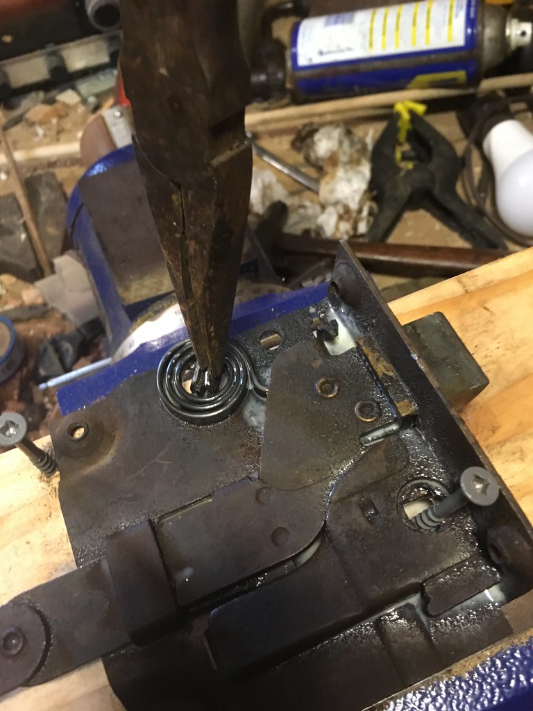

  18. F-ONE
    Joined: Mar 27, 2008
    Posts: 3,830
    F-ONE
    from Alabama
    My F-1 had a droopy drivers side door handle. The door functioned but to latch the door you had to manually hold the inside handle up as you slammed the door. You also had to make sure the outside handle was up. Then you have to lock the door.
    To shut the door from the outside you had to make sure both handles were up....hold the inside handle up from either the window or the vent wing opening.
    Needless to say that got old.
    The 1948-52 door latch is not reproduced.
    An inspection (removal of the latch ***embly) revealed the spiral latch spring was broken. That was done years ago.
    Anyway the F-1 door latch spring is not listed by some or (most) vendors. You have to do some detective work. After some research I found that a 1937 up Ford car spring would likely work...
    This...
    Today I removed the latch ***embly.
    You have to remove the outside and inside door handles. The inside one gave me some trouble as I can't see **** without my 3x readers. Off course I could not find them. I worked and worked with a punch and hammer trying to get the inside handle pin out. Something's not right so I go to town and buy several pairs of gl***es.
    With the gl***es I find what I was doing wrong. These Ford latches have two holes for position. Hell, I was punching the empty hole...no wonder I was tapping on the solid handle stud.:rolleyes: It's amazing what you can accomplish when you can see. The real pin just pushed out with finger pressure.
    The window needs to be down to remove the the ***embly. Now the inside handle stud may not want to come out. These doors are several decades old and the ***embly will come out of the door. You may have to help it a little by pulling or opening up the sprung sheet metal with your hands for clearance. She'll go. Of course you work from the door access opening.
    Since the 1950 spring was broken there was no way to compare it to the 37 spring.
    The spring is retained by two punched out teeth that wrap around the center of the spiral. these little jaws are clamped tight around the spring. I put some heat (propane) on these jaws. I tapped them open with a large screw driver and small hammer.
    How the heck am I going to wind this spring...I thought of all kinds of clamps...I finally figured out I'll just have to hoss it. (Hoss-force by labor) This particular episode of hossing...required that I hold my mouth right as well.
    It's impossible to do this with the latch ***embly loose. I screwed it down to a wooden block. actually I just positioned 2 screws ....one through the handle hole, the other through next to the edge of the plate where it would stay put against the torque. [​IMG]Un***led by Travis Brown, on Flickr
    You put the heel (rounded long end of the spring) against the sliding latch. Torque the center of the spring with the needle nose....try to hold the spring in place with the fingers of your free hand....when the center gets between the jaws.....try to hold downward with your pliers and reach for your small hammer......tap the center of the spring down.
    This is not unlike fighting a stubborn brake spring. It may take several tries but...she'll go.
    Since the jaws on my plate are 69 years old and I've pried them open....not wanting to push my luck I tapped them closed but not as tight as the factory had it. If it broke...the whole latch ***embly is history.
    I lubed everything up reinstalled it...the door now functions as new.
