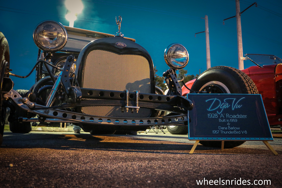

    One way in the last 20 years,I found too work well. There are a few types of chrome tape/an sheets,even some that have stretch<that is a little hard to work with,but needed for kind of round stuff.
    My first go too,being I never had $ to buy chrome plating,was to polish what ever metal to high shin. In the case of steel,I'd gloss clear coat over it some times.
    Chrome tapes have become better over the years.
    Chrome tapes* now days that are really good,like those made for kickpanels an other strips. 4716667_orig.jpg
    I'm going to tell a kind of "Secret"
    The nice chrome you see in the photo above,is not really chrome=The first thing you may note is the shocks> those are tape=the chrome tape sold for rockerpanels,same goes for the tierod n steering rod{ the tape seam is place on the side that dose not show.
    The front spring "U" bolts are just high polished steel an gloss clear coated , nuts an bolts every were I could I high polished stainless.< Those polished metal parts have been that way from the 1959/60s. I have had to redo a little from time to time.
    Back in the early 1960s,the shiny alum tapes I used were really for ductwork, and look great for only about a year ,before replacing it. This new chrome tape has lasted as you see it in photo for 6 years now ,an shows no sign of failing yet. I do keep my rod in garage. No one at any show has ever found out this stuff is not really chromed.
    Point being,if you can put tape on a clean smooth part,with out bubbles=No one knows you saved a lot of $.
    Shsssssssssssssssss don't tell.
