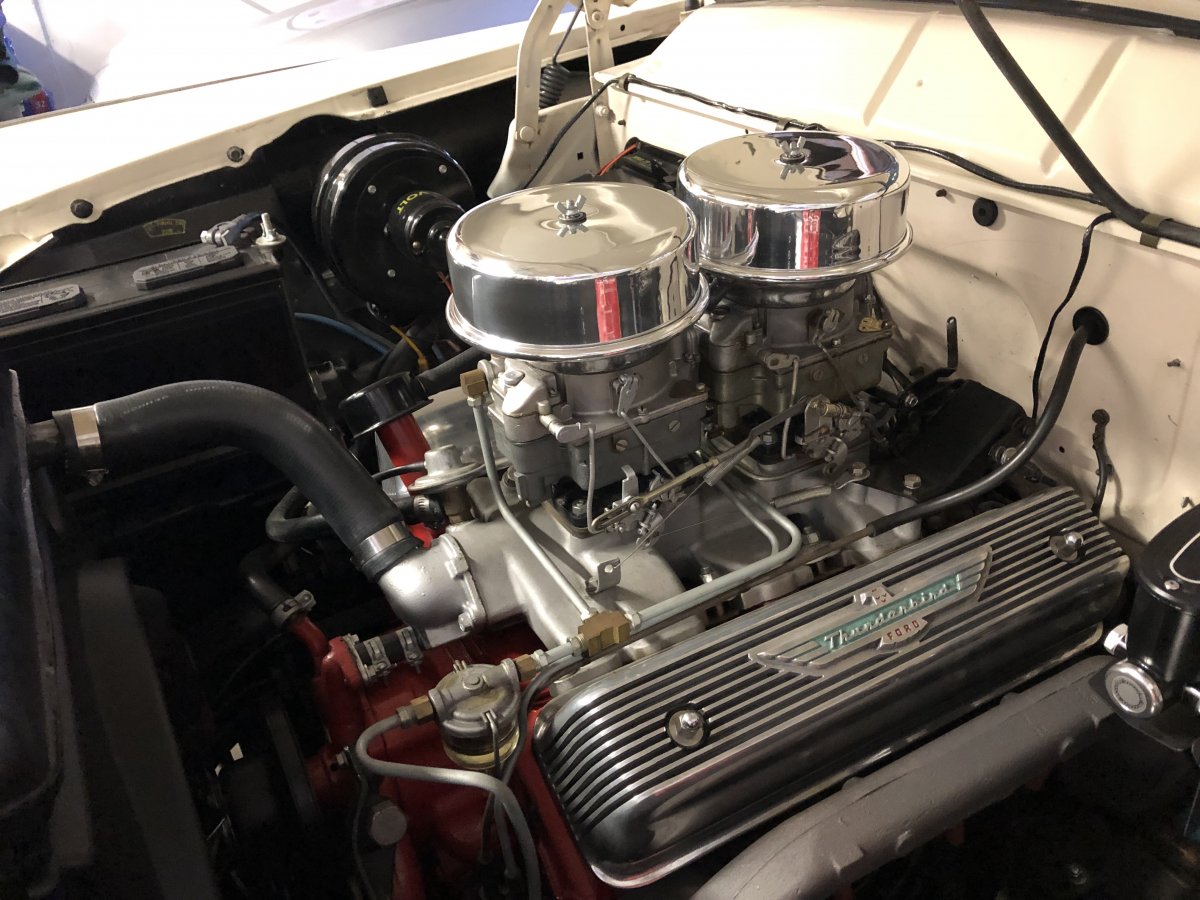

    All I can say is in 1955-60 with what was available dual quads made more power than a single 4 barrel. When newer designs were made staring in the mid 60’s things changed. One style that didn’t were tunnel-rams. As far as I remember the duals were always better than single on them.
    Today I think it’s because guys just want them.... It worked for me. 70AFE7A3-5D29-4DF1-A98A-D1A588838546.jpeg
