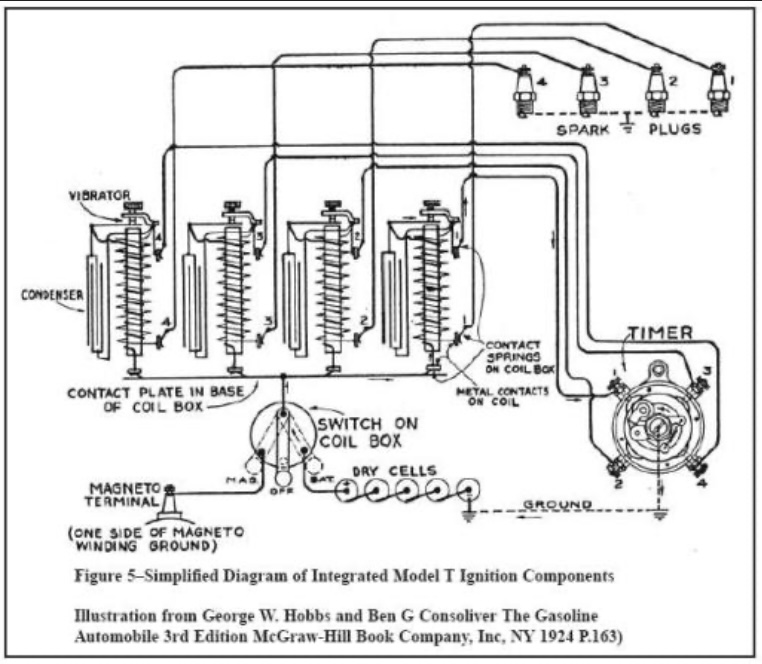

    Right that’s what got my wheels turning. I doubt it would take any electronics at all.

    As Johnny pointed out, it has already been done a hundred years ago, so absolutely possible without electronics. I'm just thinking it'll be easier to build some slightly more modern electronic triggering, possibly hall sensor or optical sensor based (if you build it so the design locates the sensors with good enough precision you could get the timing interval between each coil setup correct automatically), rather than building a "distributor" with one set of mechanical points per cylinder and make something that will be reliable and easy to tune. Could you imagine having eight sets of points to adjust for a V8 to get them all to open at exactly the right time, and not just set and forget, they'll need readjustment as they wear. Doable for sure... but time consuming.

    @G-son Modern "E" Timer for the Model T uses a Hall sensor and replaces the mechanical timer....https://modeltetimer.com/
    but then there is the coil saturation rate and maybe a set of points arcing causing a different timing of the plug firing.
    The Montana 500 (mile) race is for stock Model T's and the winners average 53-54 miles per hour. A lot of time is spent building identical coils and timers that energize the coils exactly 90 degrees apart.
    .....but none of it is one wire

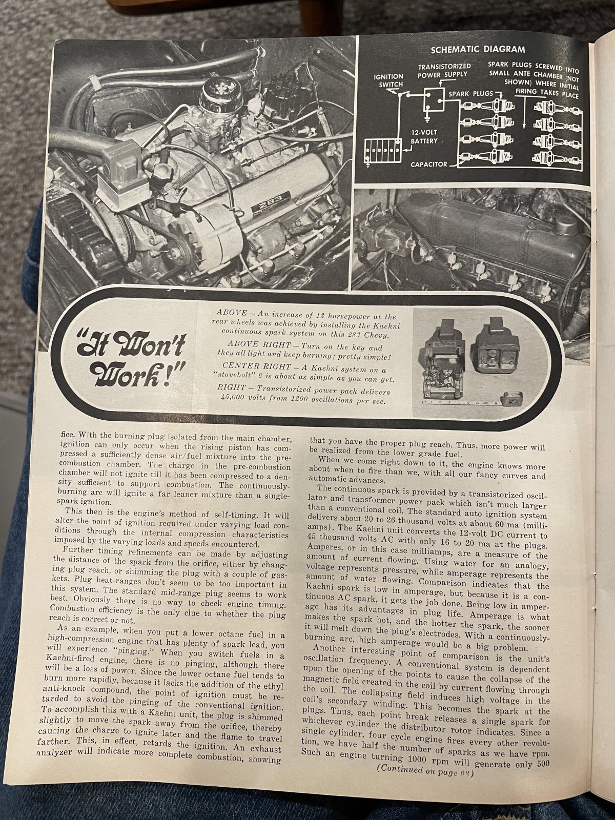

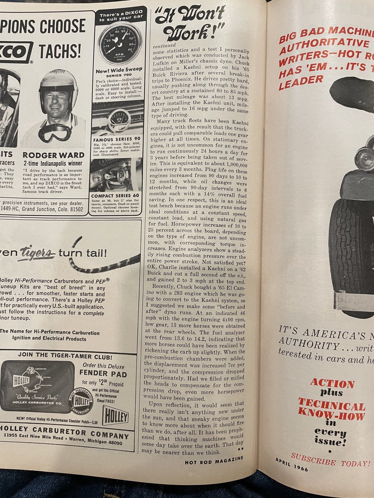

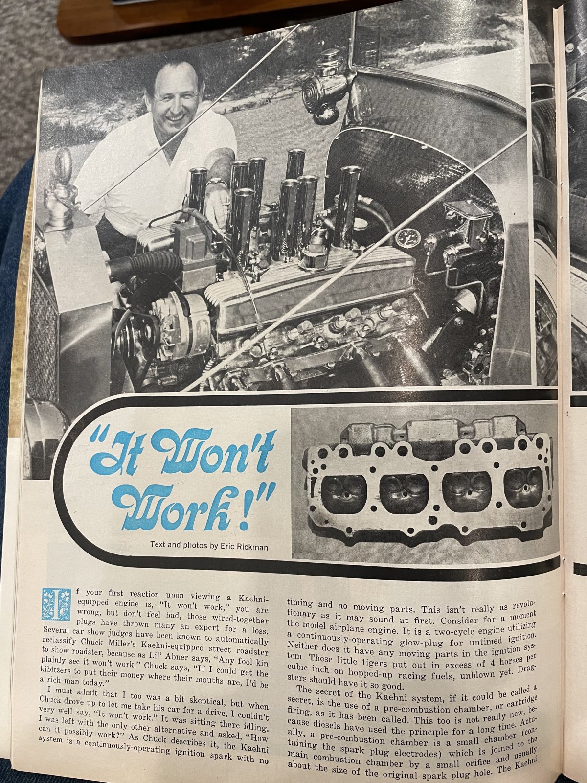

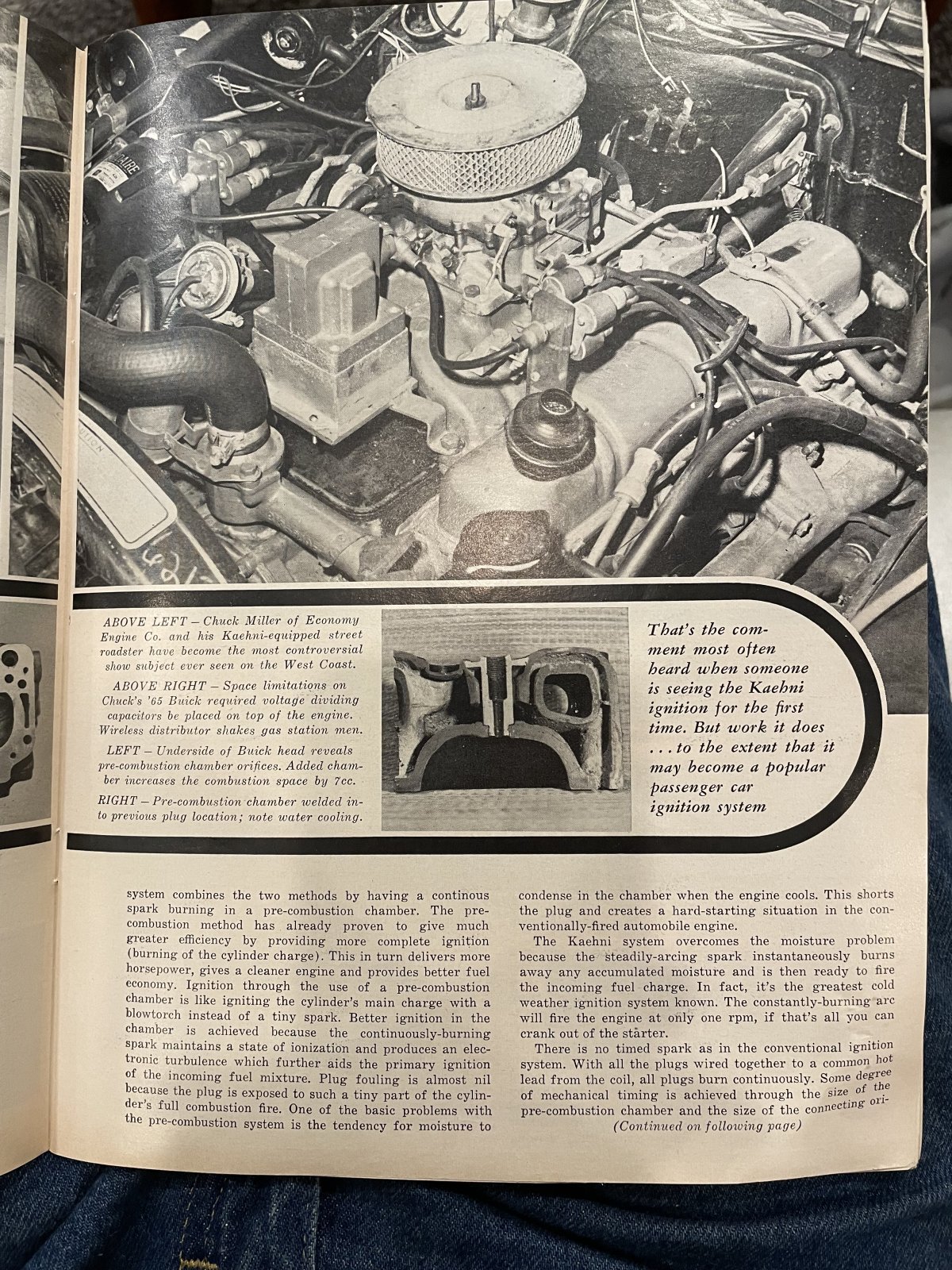

    Ok, I was wrong it is not a diesel although the hot rod magazine article on the Kaehni ignition system compares it to a diesel system.here’s the article from April 1966 hot rod

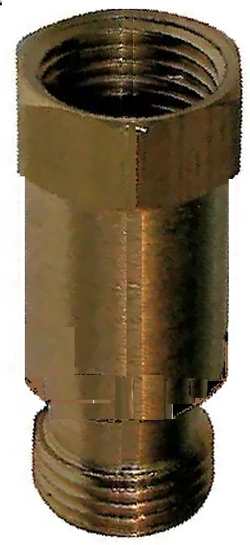

    Plug anti-foulers can also be used as pre-chambers but must be made from copper, aluminum or finned to promote cooling. Timing can be affected by pre-chamber dimensions a**** other things. Lots of variables to consider to get it right.
    ATTACH=full]6120451[/ATTACH]
