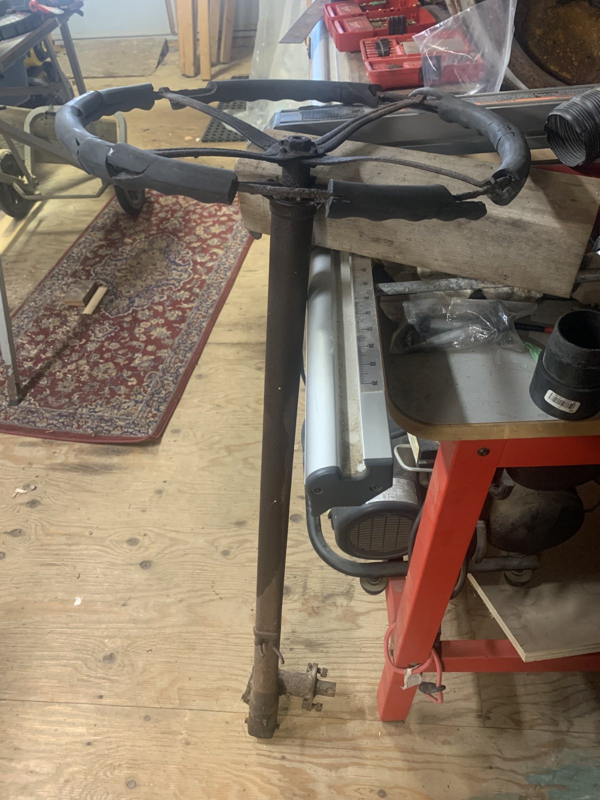

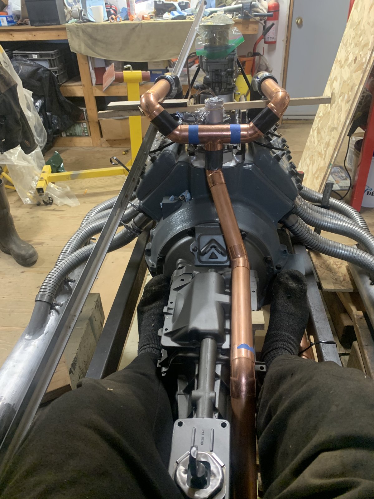

    As I was working on my speedster coolant plumbing and as I get a little further with mocking things up, the question of how to tackle the steering system is starting to creep into my mind. I was originally thinking of some kind of cowl steering setup, but after reading up on it, not sure if it is still suitable for my setup which will use 1/4 elliptical springs that I hope to make from the original Model A front spring.
    The issue of course is it being a single seat speedster with the seat centred in the middle of the frame, the steering column will run straight into the engine. If cowl steering is not an option (I don’t have the $$$ for a Schroeder unit), then is it possible to use sprockets and a chain to offset the lower half of the column to get it and the box in the “correct” position? Is another option a bunch of shaft sections with u-joints?
    I have a complete Model A column that works although it is a bit crusty. Any other ideas appreciated.

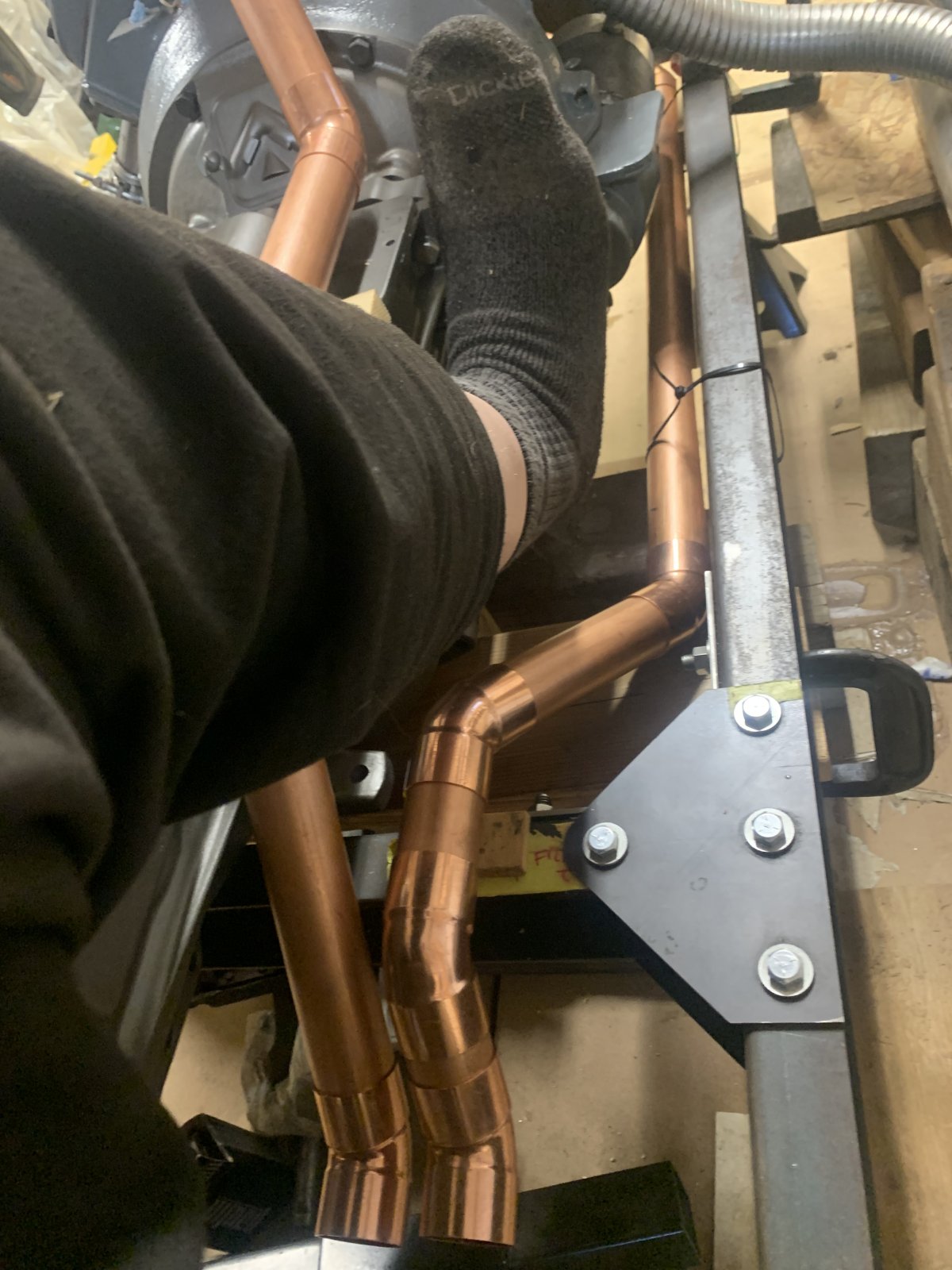

    Having spent some seat time in a similar ****pit, you do not want anything that generates heat near your legs. The cooling pipe is way too close to your leg.
    I think that cowl steering would be perfect for your setup. There should be a good number of used manual sprint car steering gears out there. Of course that's just what I think since sprint cars went to power steering, but that was 40 years ago.

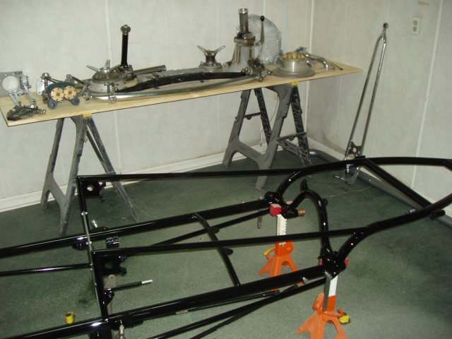

    PLAN AHead. Cowl steer is your best bet. Ross as used on fork lifts are compact. This one on the table is for my 1950 midget. The primered one is an extra fast ratio. 5" Pittman arm. Midwest Auto Speciaties, Ohio used to list them for race cars back about 1970. PS; Schroeder or Ross work right or left steer. Contact me if you can use the quick steer Ross. 2024-01-04 12.22.09-8.jpg 2024-01-26 10.53.58-2.jpg

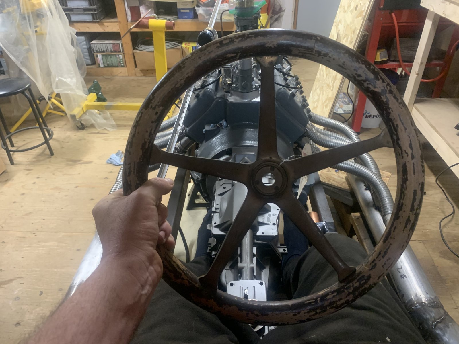

    Thanks for all the replies. Great info and advice. I had another quick look last night, and since the steering wheel will be quite far itself from the engine, I might be able to do a few u-joints with shafts to sneak it between the bell hsg and last exh tube on the DS. Will be super tight in that area, but it might just work. Still haven’t ruled out cowl steering either.
    On the topic of coolant pipes, and J really appreciate hearing from someone like @jaracer who has actual experience behind the seat. I actually ran the pump(s) outlet pipe even closer to my foot and leg. Will have to really think about re-routing. I thought about running them below the frame rails, but I wanted to keep them kinda of hidden for asthetic reasons. Can’t run them inside the rails, as mine are reversed and I will insert wood to mimic a wooden frame of the original I’m copying.

    As far as your cooling pipes are concerned. Don't change them. Just pack your right foot and leg with LOTS of insulation.

    I think you might look at wrapping the coolant pipe with header wrap...the woven fibergl*** stuff...
    I know asbestos wrap would be period ....but....
