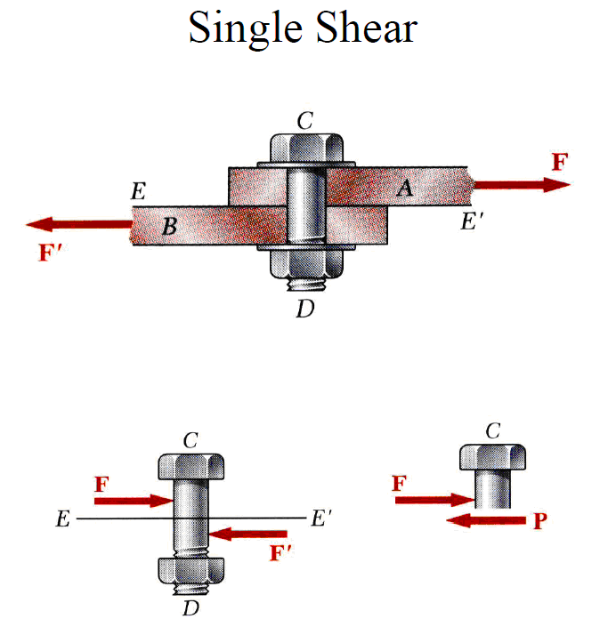

    How about a technical definition of what single shear is and a couple of pic's showing it (good & bad examples) for the audience.

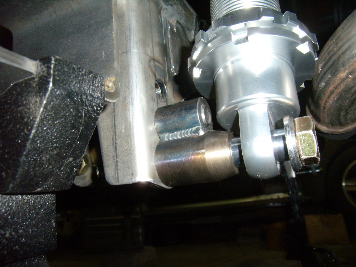

    As much as possible, I try to use fasteners in double shear. Sometimes, it's very difficult, as in lower mounts for coil shocks. I always make up a substantial spacer to go between the shock eye and the housing bracket, it offers support very close to the shock body. I always use 5/8 grade 8 bolts here too. Coil shock mounts 003.JPG Coil shock mounts 007.JPG Coil shock mounts 009.JPG

    ^^^ Very nice work. Excellent examples of how to do single shear. :cool:

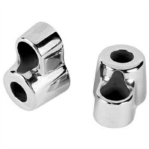

    Many years ago these simple little mounts appeared on the market and I finally thought "somebody was think'n", these are a good way to spread the load over two mounting bolts and also combat the self loosening effect.
    Problem was, $50.00 sure could go a long way on other part purchases so I made these.
