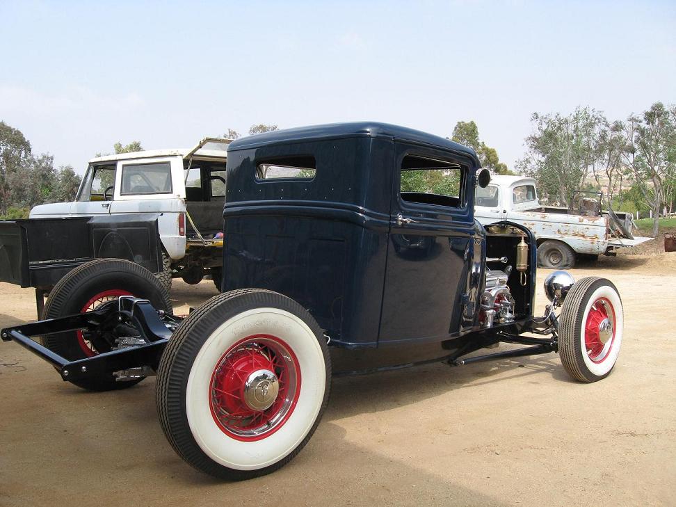

  8. NMCarNut
    Joined: Nov 28, 2009
    Posts: 638
    NMCarNut
    News to me. Do it all the time . . .

  9. no problem, just give the limco 3 a couple days to get "hard"

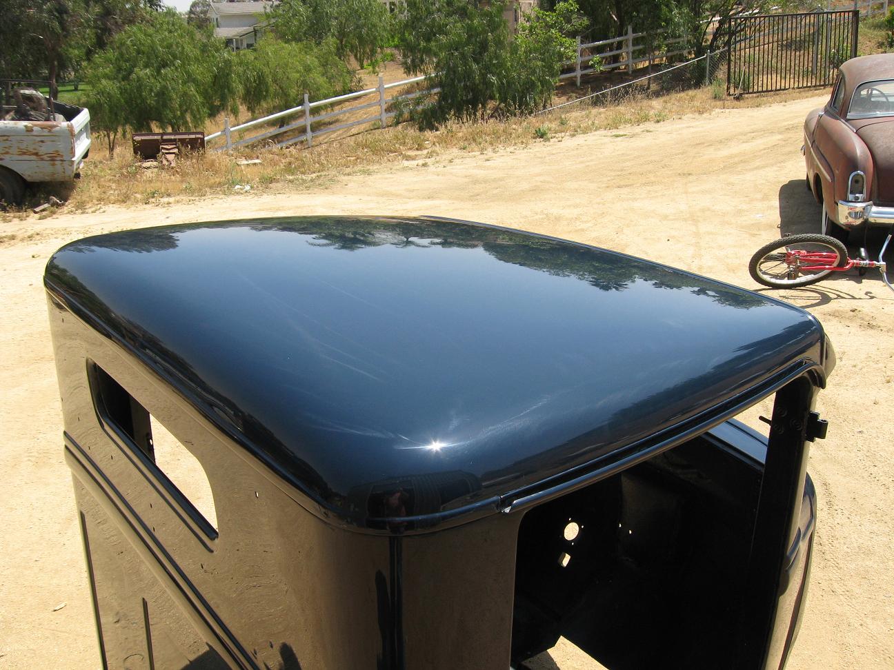

    Hell, the old dupont urathane you had to wet sand and buff just to get it to shine

    Thanks guys, I just love the look of a properly polished solid color.

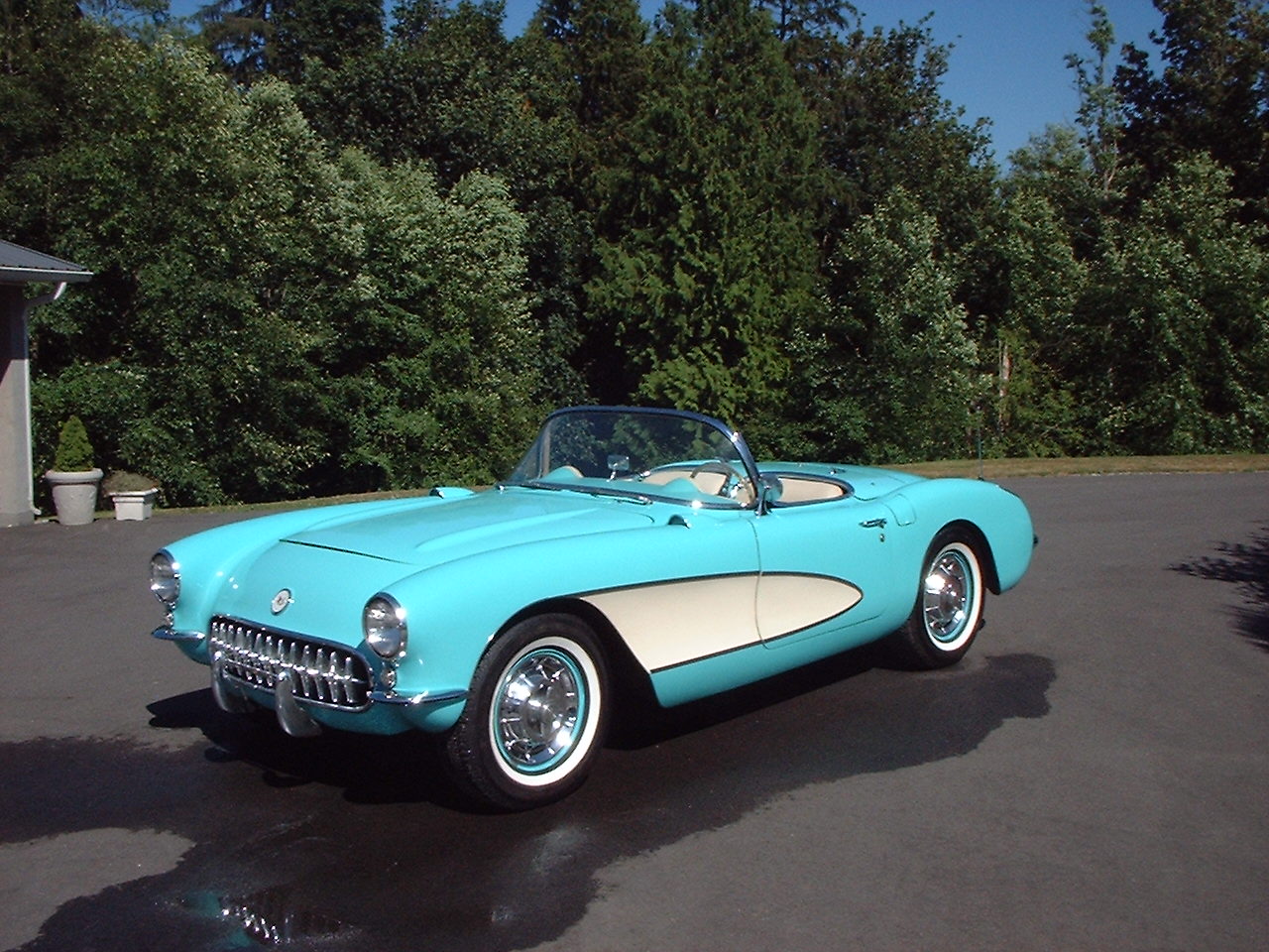

    Heres the color,borrowed the pic from HAMBer.

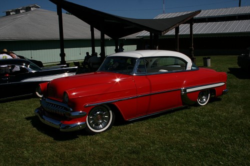

    Here's SS Dupont Centari that was done recently. The last pics were sanded with 1000/1200 then 1500. I took the car to the Detroit Autorama and got several compliments on how the shine was better than a bc/cc hard shiny plastic like look.

  16. I love that car! Is that a Dupont Fleet color? I think it is the same one I helped a customer pick out for a Pheaton a few years back?

  18. Kirk Hanning
    Joined: Feb 27, 2005
    Posts: 1,606
    Kirk Hanning
    I do think that its a fleet color. I walked into my favorite old timey 3 generation parts store which has a paint dept. and told them that I wanted an old fashioned red/maroonish color and that's what I got. Couldn't be happier, in low light the color really darkens.

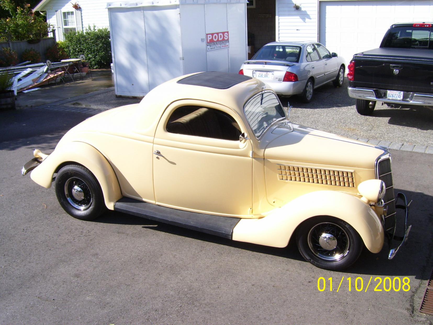

    here are two single stage jobs, the one is a washington blue tinted a tad darker and the red one is my buddys old truck that i copied a pic from its ebay listing a few weeks back. that paint job is 11 yrs old..
  28. i found with "lower" grade paints, good results can be achieved, but they require extra care by the painter. with the lighter colors and red, because of weaker/less tints, a primer coat matched to the color is a must. the primer/sealer must be uniform. additional coats may be required but give it extra time between coats, they tend to dry slower.

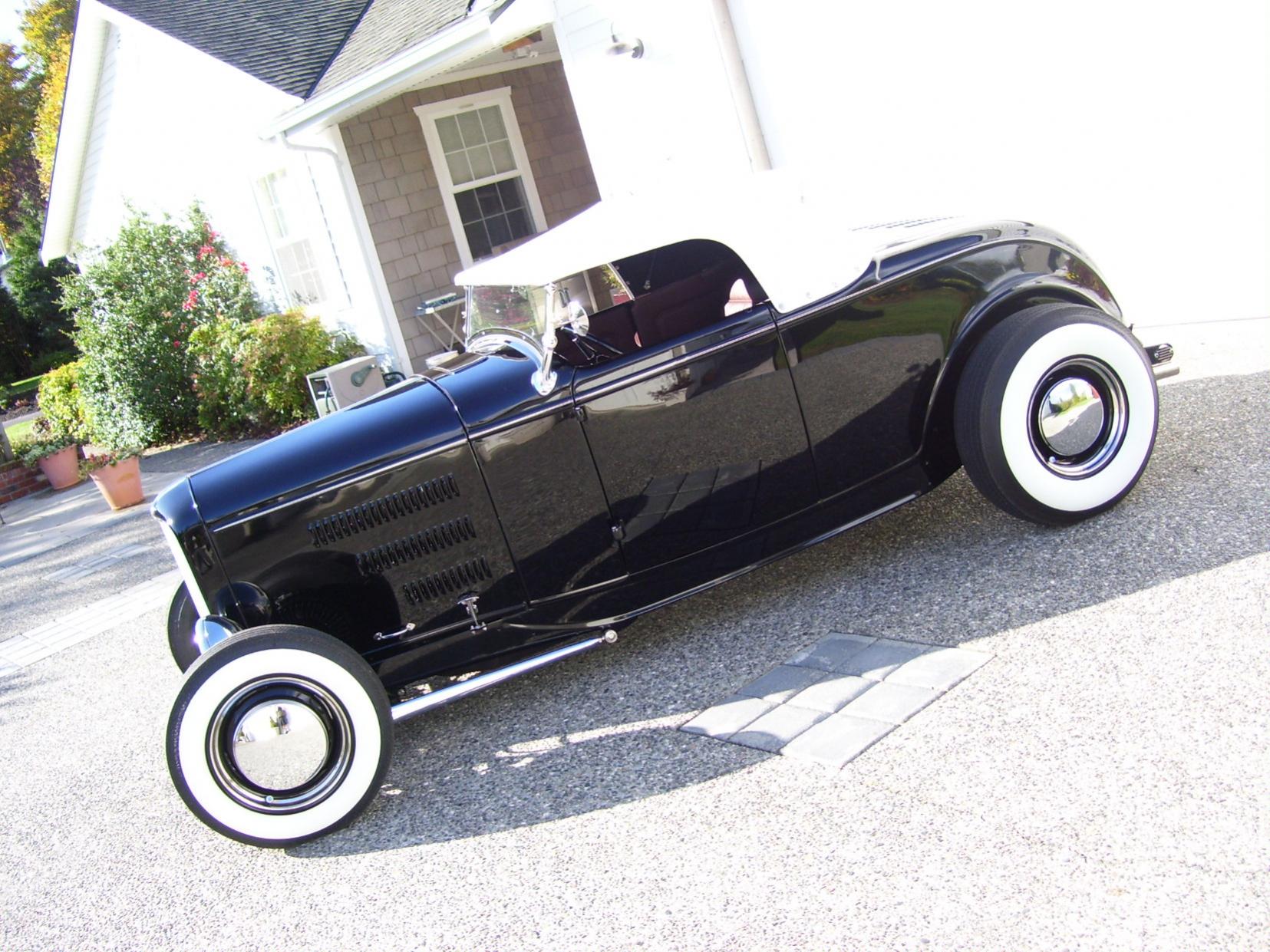

  30. Also been paintin for over 40 years, Limco ain't JUNK, just a lower grade and less cost.
    If the OP want to say sum $$$$ thats his choice.
    Case in point, this little 32 was done 5 years ago in Washington Blue and still looks great. 3 rd owner just called me a couple months ago to get color code for sum chips and I asked how the paint is lookin, and he said looks great
    And yes it was cut and buffed.
    4 coats, let it sit a week, then get after it.
    If yer a "Good Squirt" no need for 1000 or 1200
    I hit 'em with 1500, 2000 the a lite cut then polish.
    The shot of the 3, all were done in LIMCO 3 6 years ago and all still look god
    Go fer it.
