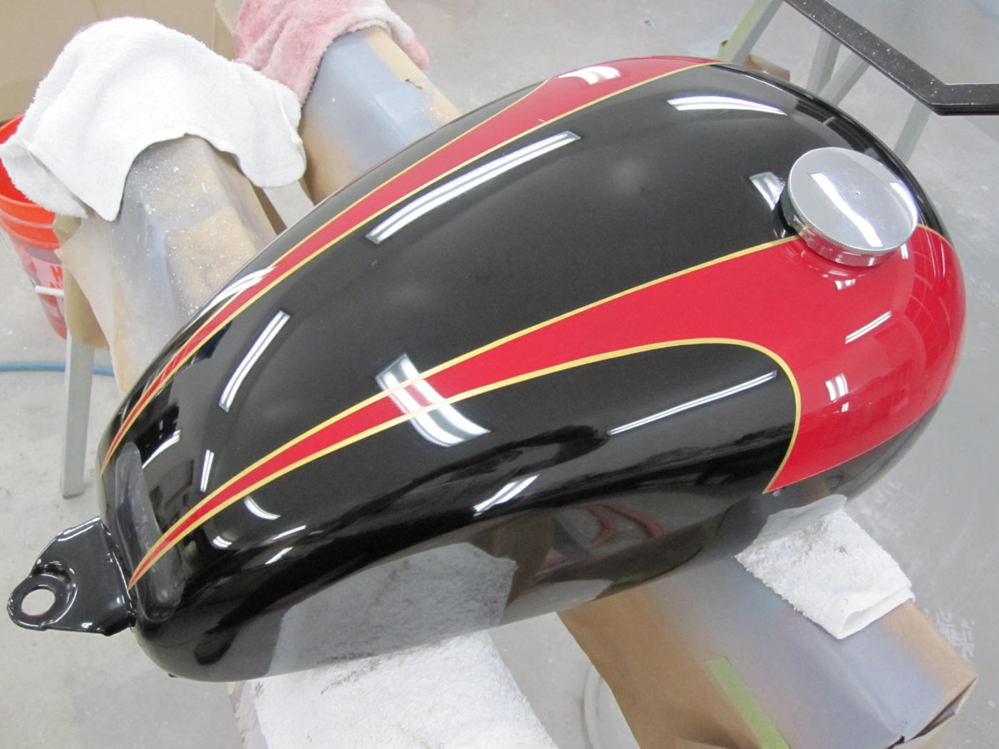

  2. Here is my buddy Rocket doing a cut and buffed on my single stage roof two days ago... Looks great, no problems at all.

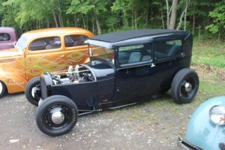

    this is this is single stage acrylic urethane cut and buffed.
  6. ^^^Good lookin' T-Bird!
    I color sand and buff everything. You've gone to all the trouble to get the body straight, so why not spend the time to get the finish smooth and shiny? You can have your booth hospital-clean, but you'll still get particulates in the paint. Nubs, dirt, and bugs should never be left in a paint job, in my opinion.

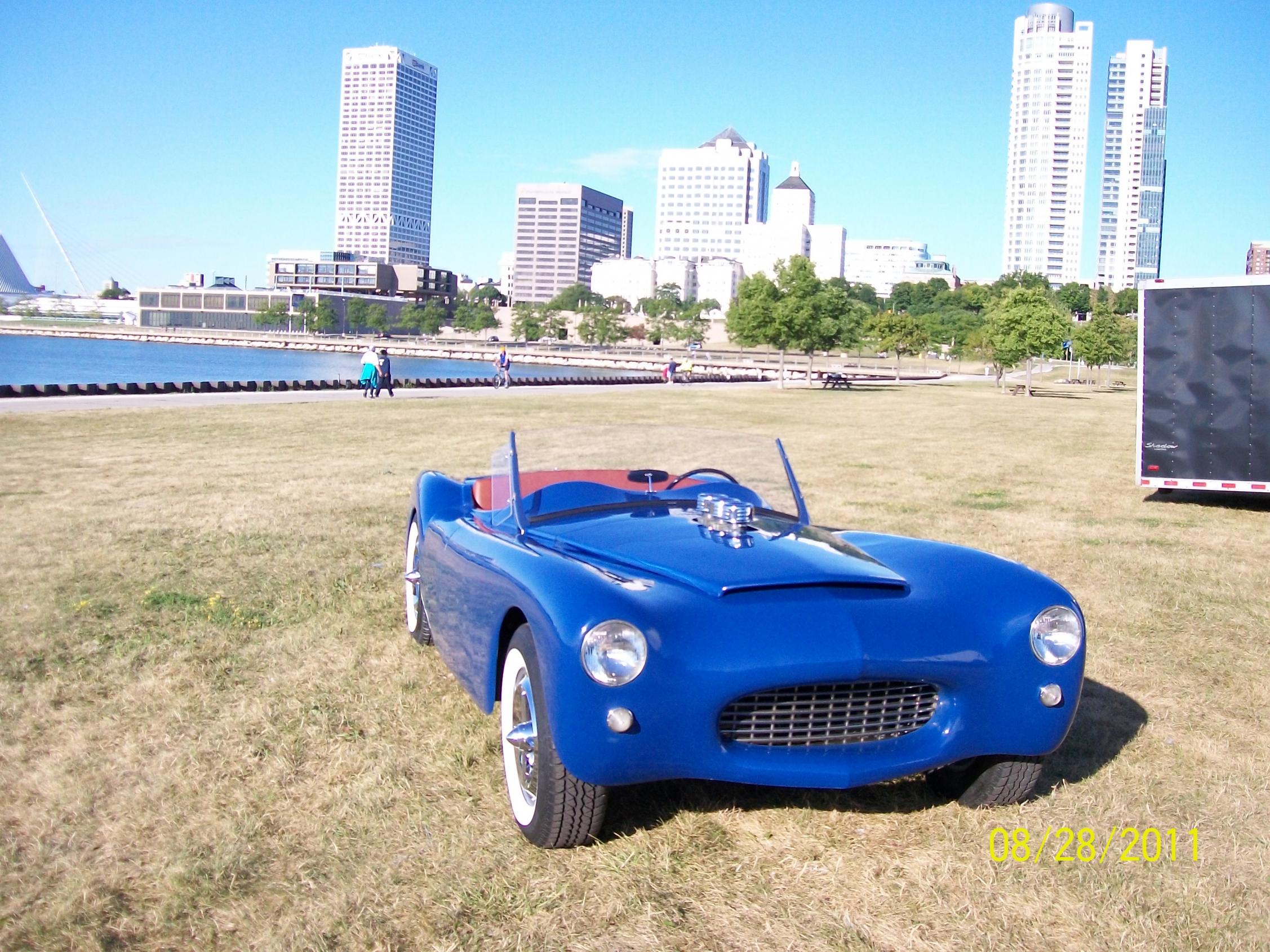

    I like single stage when cut and buffed. Has a "different" look than that of BC/CC. The best thing is that if you ever have to repaint a spot, you don't have to clear the whole panel. Just paint it and cut and buff that spot. To me, it's like a Colored clearcoat.
  24. arkiehotrods
    Joined: Mar 9, 2006
    Posts: 6,802
    arkiehotrods
    That photo right there is enough to make anyone who wants patina or suede rethink what they want on their car! Beautiful!
