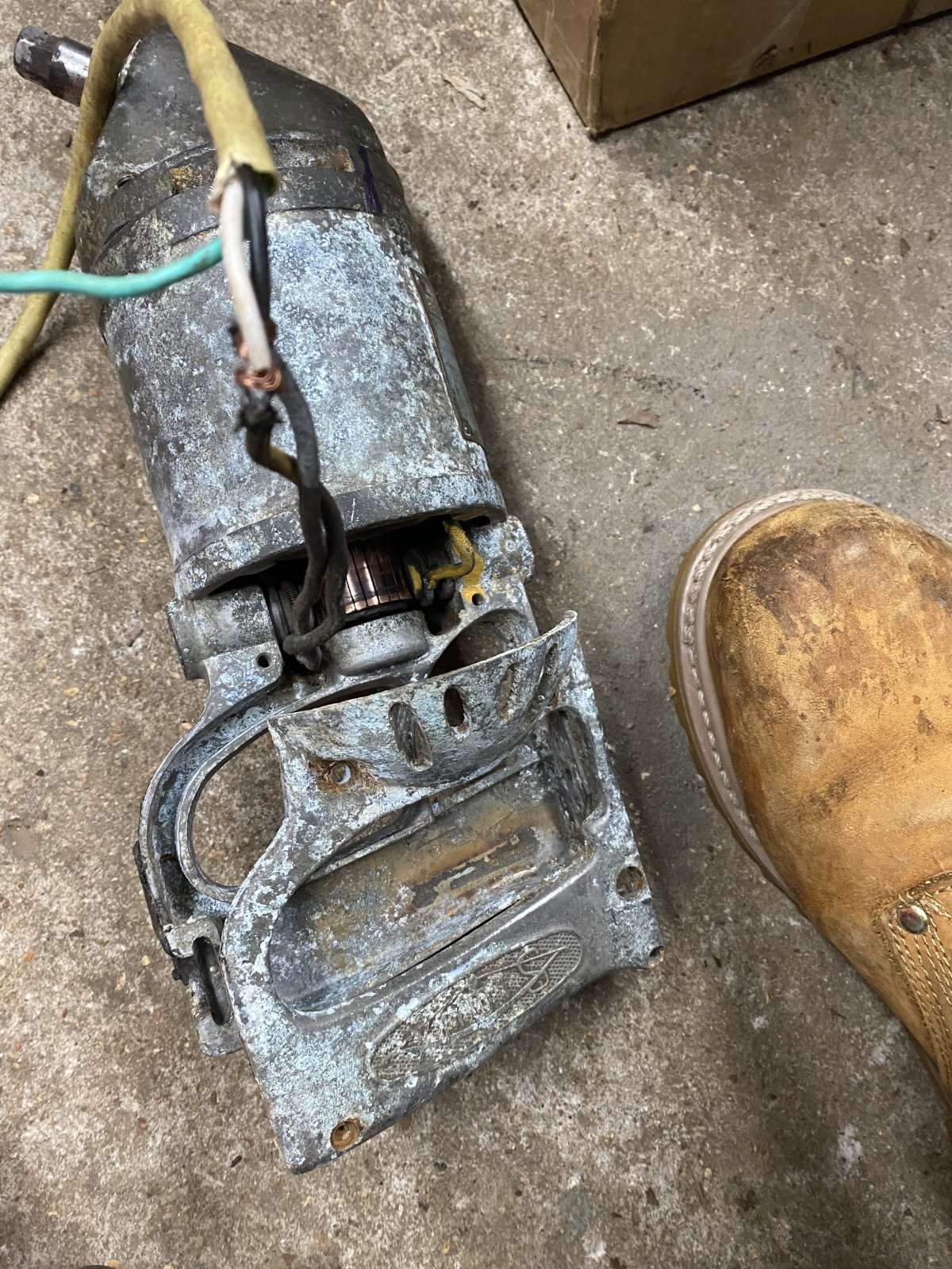

    IMG_1852.jpeg IMG_1855.jpeg IMG_1851.jpeg IMG_1853.jpeg IMG_1854.jpeg IMG_1850.jpeg I need a trigger switch for my Sioux seat grinder. Don’t let appearances fool you. It runs smooth as silk. The switch went out and I’ve been looking all over. Internet/online/etc. I wired up direct just to check and make sure. This version has the all metal handles that split and one side unbolts.
    The new versions say they will only work on plastic handle machines. I need to find a switch that will bolt in and no be a cobble job.

    I'm reasonably sure you're going to be SOL in finding a new switch. Best bet would to be find an old, long-time-around tool repair place and pray they have one on the shelf. These switches are almost always proprietary, not generic. Or maybe do some research to see if they (or the parent company) also made a larger drill motor that might have shared this switch. But don't get your hopes up...
    It may be repairable. From what I can see, it looks like the mechanical part still works, you just have burned contacts. Those contacts are in the bakelight housing, if you can disassemble that without breaking it, I suspect what you'll find is there's two sets of contacts. By turning them over, you can use the 'new' set. Even if there's not unused contacts, you may be able to clean/file them and get more use out of it.
    If all that fails, you could wire a foot switch into the cord and eliminate the handle switch. Good luck!

    You are correct. The problem was that the tiny bolts(2) that hold the switch together broke off. If I can drill the tiny screws out there is a chance. I am honestly hoping there is a switch somewhere. I have a few spots to look.

    KB you may be a winner winner chicken dinner. Sure looks close. Am going to look at it. I have a milling machine etc. I am not afraid to clearance as long as it installs and is safe.

    Just ordered it. KB if your ever in my part of the woods I’ll buy dinner or lunch. I called myself looking. It looks close enough that for that price I’ll take a chance. A new one as in Soiux/style seat grinder is around 1300$. Supposed to be here Saturday.

    Switch came in today. Man talk about a dead match. I bet the box is 50 plus alone. KB again I owe you if you are ever in this part of the world you pick the place and we will eat. Lol IMG_1898.jpeg

    All back together. Like new. Now I need to order another seat of stones soni will have enough to have a set for each of the angles that I use and not have to dress so much of the stone away changing angles.
