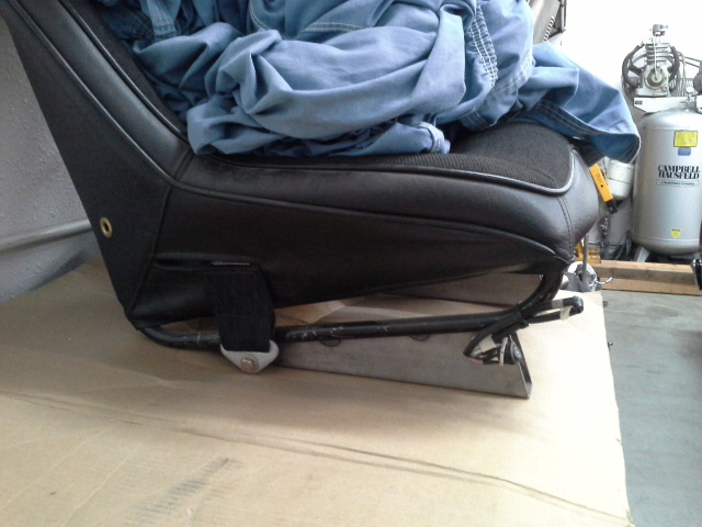

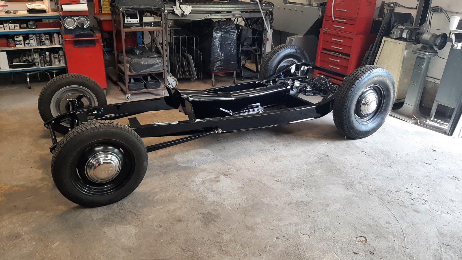

    Slick ch***is! With the seat bottom being able to be mounted WAY below the top of the frame rail.

    In the old dry lakes roadster pictures, they sat real low…on a thin pad on the floor. With this setup, you can sit “ dry lakes low”, but be sitting on a nicely padded seat!
    Just have to plan the seating setup…at the very beginning of the build.

    I've always liked this idea to reduce cramping, but it's not without some drawbacks. Without an x-member torsional rigidity is harder to achieve. How do you route the exhaust?

    I would use 1x3 rect. tubing generously under the new floor pan, not only to support the floor and connect to hoops for the xmsn mount, tunnel, driveshaft protection, but to prevent your buns from being ripped off by big stuff you might not see lurking in the road - especially at the front where the floor and toe boards meet IOT protect your feet. Nice idea, though.

    It can be X with creative thinking same with exhaust.

    Heavier gauge mild steel sheet for the floor-seat pan/transmission mount-unibody crossmember/transmission-driveshaft tunnel. The exhaust could either run down inside the driveshaft tunnel or be side exhaust… or with a turbo, exit in front of the ****pit!

    I was going to build the frame/floor of my T that way. Would love to get that RPU project back. Yes, I would use a thicker steel or two layers under the driver. It could look perfectly smooth , like a belly pan. The exhaust could run with the driveshaft.
    I think it’s the best thing for a low, open roadster. 100%

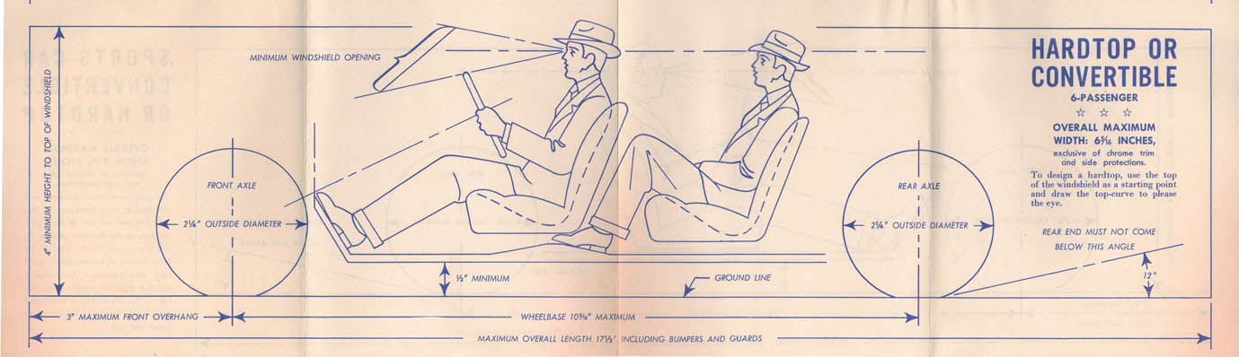

    A Club I was in FBCG ,back in the 1950s,about car designing,had some great things to learn; This was for building models,but needed in real cars. FisherBodyCGseating.jpg

    Drawing looks like it's from the old Fisher Body yearly design a car contests.

    Yes,that's the club,there were a lot tips in the booklets that helped with good design. Things that many, even now could benefit from.

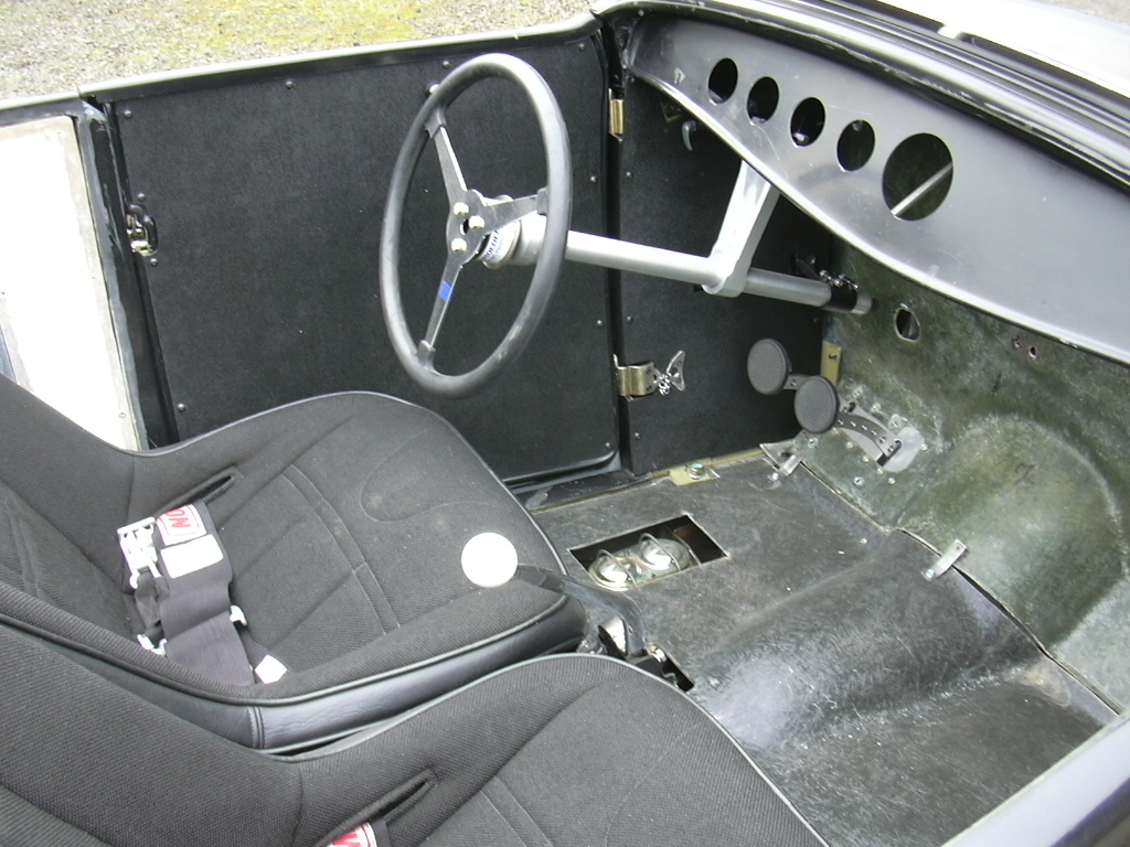

  23. DDDenny
    Posts: 22,845
    Sometimes the planning is (far more) than the seat(s) and floorpan.
    The line of sight (or lack of) of the steering gear/shaft, rod end mounts/joints, headers, type of column/mount, not to mention motor mount location/design play the larger role.
    I too wanted to have a lower seated position in my roadster, making tapered mounts for these suspension style buckets that had minimal construction and padding allowed the seats to sort of "tuck" under the tulip panel
    l built the steering column and used multiple joints, this enabled the first joint to be inside the cabin area with only the 3/4" shaft p***ing through the firewall, much more flexibility this way when dealing with engine header tube clearance, also used a quick release steering wheel hub.
    No tilt columns in this car!
