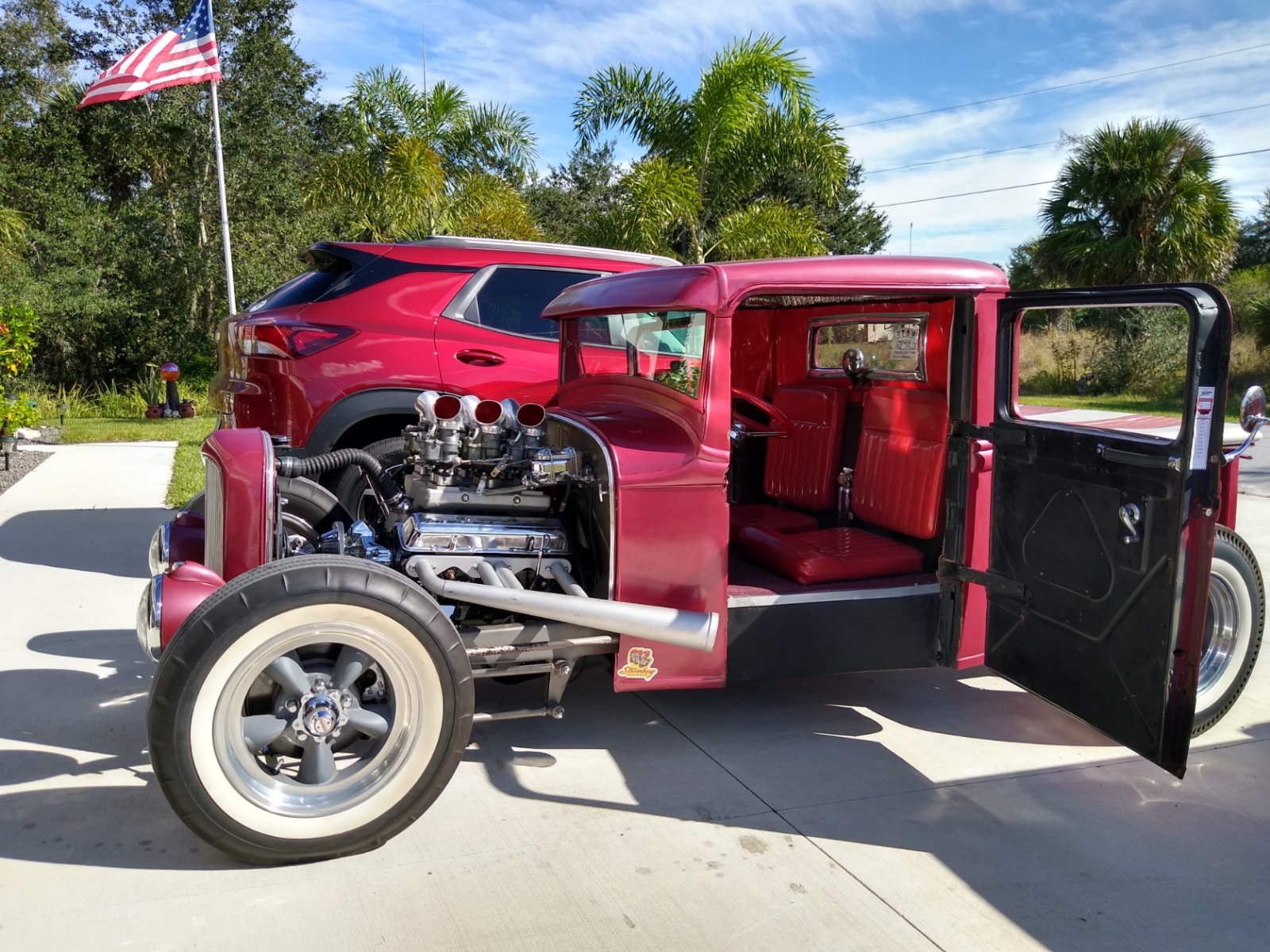

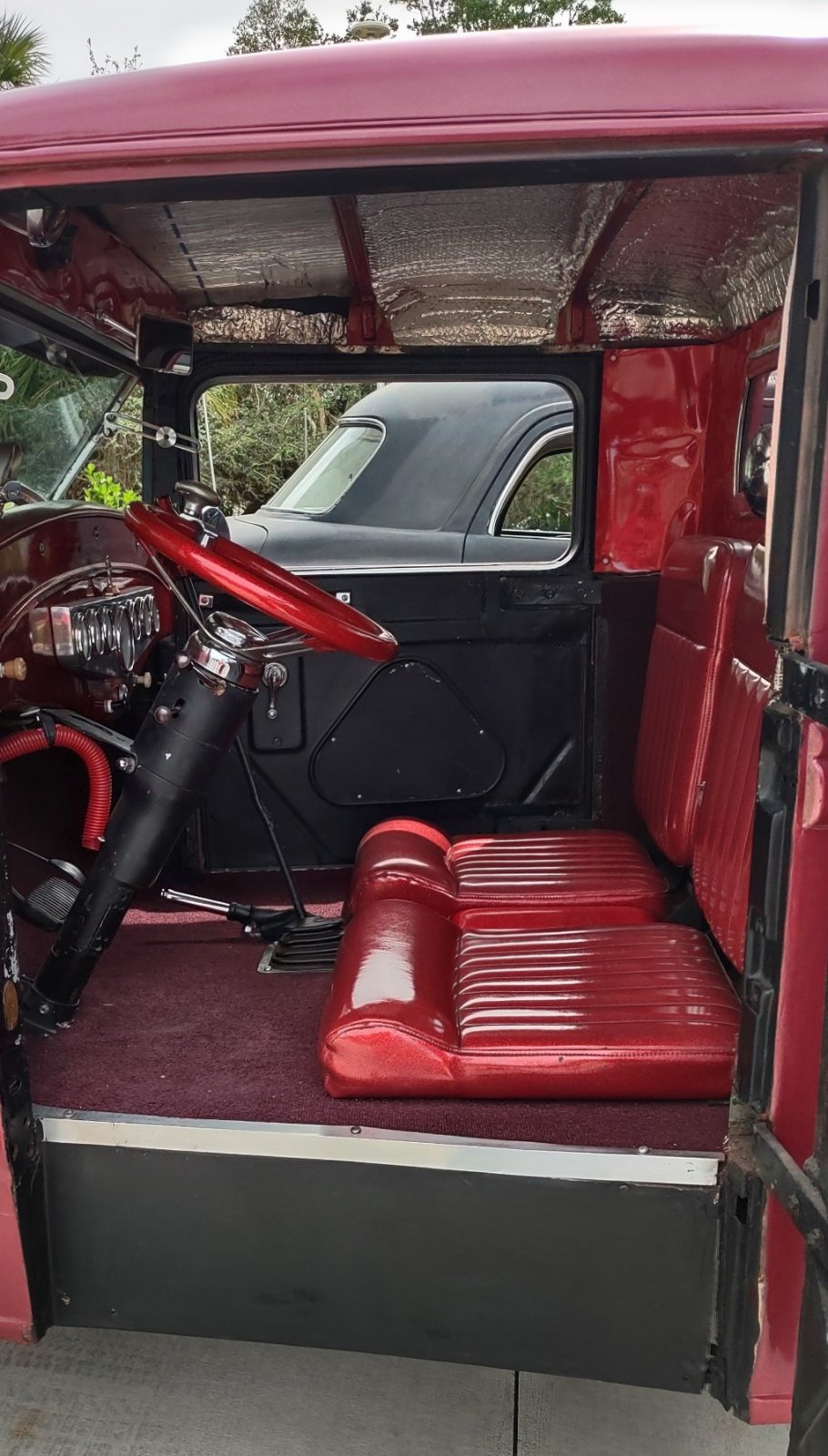

    4" chop, 9" channel. Knees just even with window frame, I could drive all day, but took forever to get in and out!

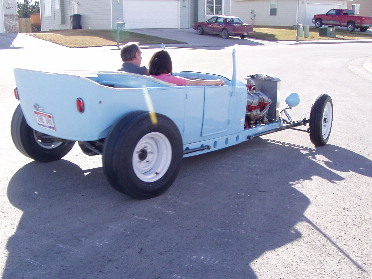

    Yes, Colin Chapman…funny thing, have an OT Lotus Europa out in the shop! Love the 7’s too. Built the 27 modified (like an American version of a V8 powered Lotus 7), as I’m too big to comfortably fit in and drive a 7. Probably should sell the Europa…as that’s a pretty tight fit too. Older son doesn’t like Europa’s, and young son really likes them, but is too big…bigger than me!

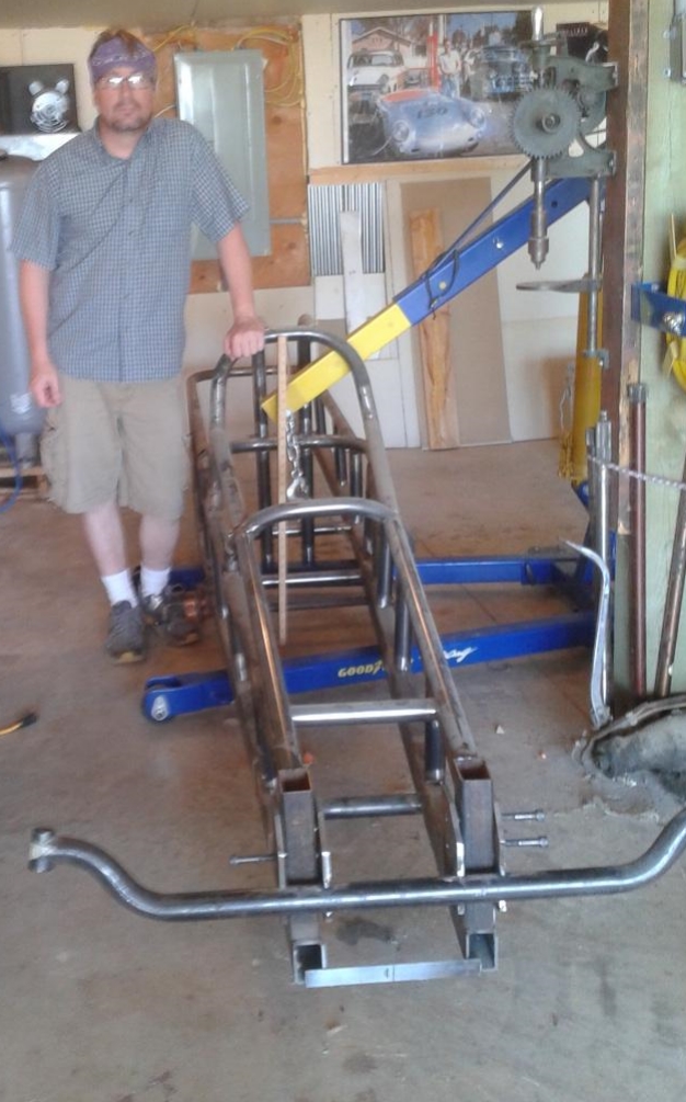

    Here's an under construction shot of my old Anglia.
    5 and half inch chop and channeled about 9". I mounted the seats through the frame and it worked really well for me at 5' 7". I put a lot of miles on this thing and it was really comfortable! The guy who owns it now must be 6' 4" and he hardly drives it. Think he bought the wrong car....ha ha ha. Pop latest 028.jpg

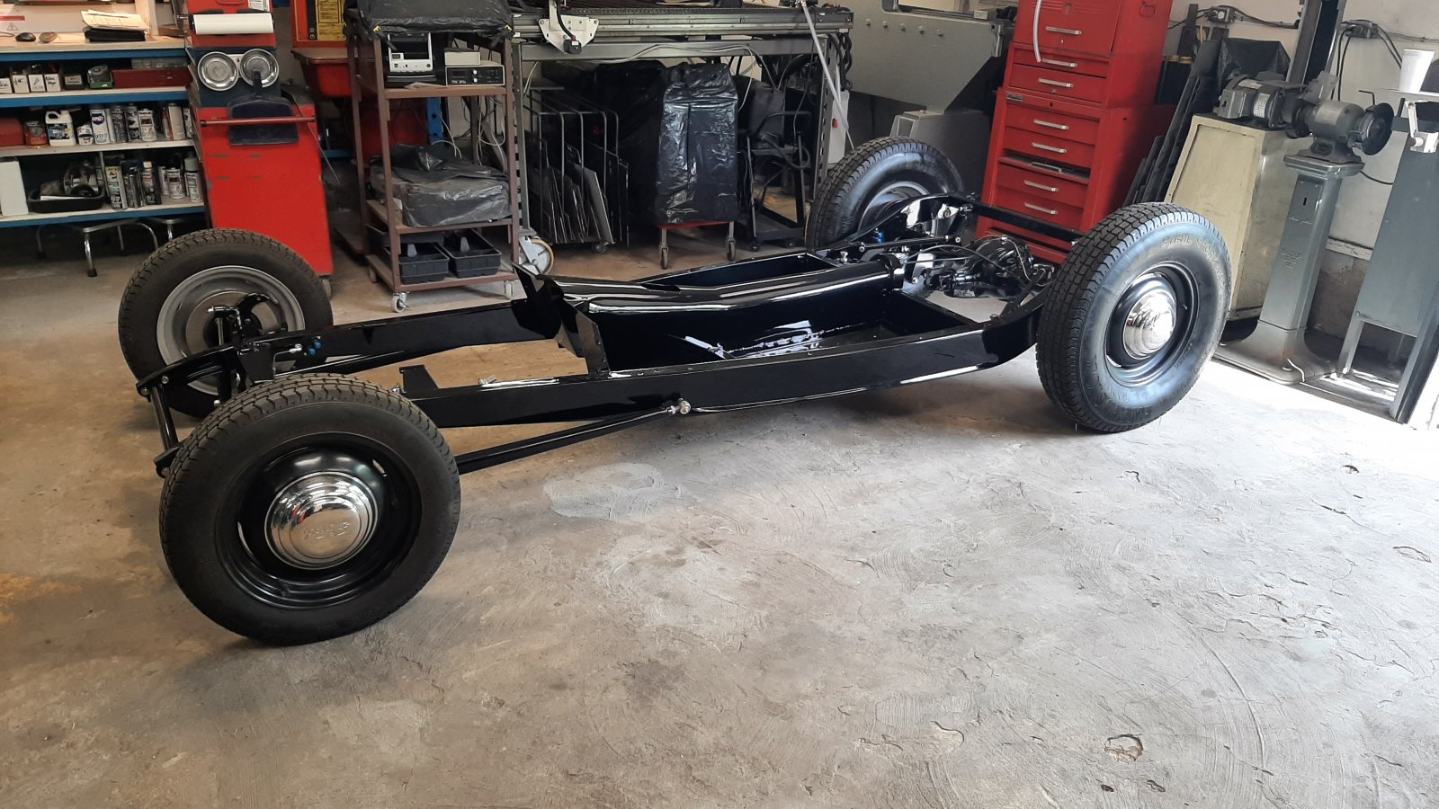

    Here is a pic of the Hot Rod in post #1, that pictures it’s ch***is. Anyone recognize it?

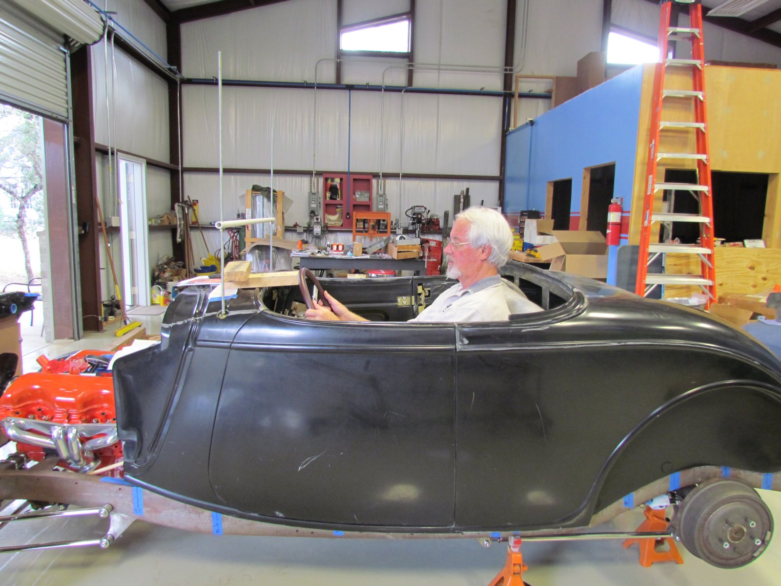

    At 74 years old (soon to be 75), I may not be the fittest person in the room, but I can still do anything that I want to do. My comment to the younger critics is, wait another 20-25 years and then we'll see if your body still bends the same ways it does when you were younger. And before I get criticized, I have been doing this "rod" thing for over 55 years including building my green coupe 49 years ago.
    However, staying with the topic of this, I have a problem being able to fit in a lot of cars, including my wife's 2021 Mazda 6 sedan and my C6 Corvette. I am 6' 3", but most of my height is in my back (I have a 32" inseam). Except for my truck and the coupe in my avatar, I cannot get into most cars to clear the door roof line without bending my head forward until my chin is on my chest, even with the seats powered all the way down to the floor.
    Now, to translate that problem to my current '33 Roadster build, before I purchased a windshield frame and stanchions for it, I had to do a complete mock up of the seat height, front-to-rear seat position and tilt, the steering column & gauge placement, with the windshield height to see if I could use a 2" chopped windshield (hopefully with a removable top) versus the standard height windshield. Plus all of that needed to consider that I am looking for the car to be a "long-haul" driver whenever I want to take a road trip. It will not be a garage queen or a show car - it has to do inter-state cruises (and from central Texas, that means 600-700 mile plus daily cruises.) I really wanted the look of the 2" chopped windshield and top. After everything was mocked-up several times, the final decision was that I can do it if I put the seat (bench seat style) on the floor with no riser, tilt the seat back where the bottom is tilted upward at the front and the top of the seat back is resting against the rear of the ****pit area (with no package or top storage shelf) and the steering wheel/column is positioned where it is comfortable in my hands with my arms relaxed. One helpful thing that I learned was that there are different foam densities that allow the use of thinner denser foam without sacrificing comfort in your bottom . The column mock-up allowed comfortably clearing all of the pedals and misses the exhaust header and I can see the gauges on the '32-style dashboard. However, even with that arrangement, the very top of my head is above the top of the windshield frame, but my eyes are below the top frame. I think I can live with that. It will make traffic lights and overhead signs difficult to see, but I have somewhat the same problem with the green Plymouth coupe and I think I can live with that inconvenience with the roadster. But...I can't live with being uncomfortable in a car that is intended to be driven for any distance over 25 miles. 2020_11_21-1st Seat Mockup-IMG_1656.JPG
  24. I highlighted you best comment in red. This is called ergonomics and I would say 75% of folks building hot rods miss this point unless they know better OR talk to an actual interior guy or gal. Almost ANYONE can fit in these cars with the right fit. The only ones that are REALLY hard for even us 5'9-10" folks are early pickups.

    It's a shame these frames have to be covered up? A frame just waiting for an engine is artwork. You have artwork right there.
