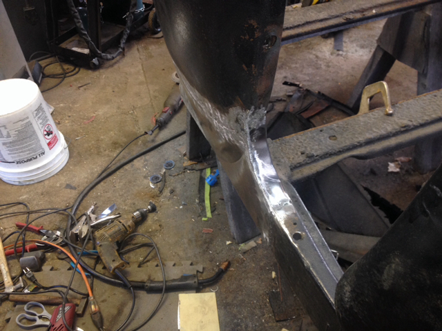

    onekoolkat1950
    Driver side patch panels made and installed. ImageUploadedByH.A.M.B.1425928500.383961.jpg ImageUploadedByH.A.M.B.1425928511.465093.jpg ImageUploadedByH.A.M.B.1425928531.220375.jpg

    ImageUploadedByH.A.M.B.1426822794.500604.jpg ImageUploadedByH.A.M.B.1426822808.176170.jpg ImageUploadedByH.A.M.B.1426822821.926784.jpg
    Passenger side . Ugh

    ImageUploadedByH.A.M.B.1426822873.023661.jpg ImageUploadedByH.A.M.B.1426822889.247365.jpg ImageUploadedByH.A.M.B.1426822900.429119.jpg
    Gettin there.

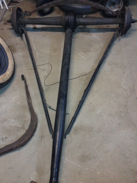

    Don't mean to sound uneducated but what does it mean to "flip the bells"? Love the way it's coming out. Nice work.

    The 40 rear is a spring behind, flipping the bells puts the spring in front of the axle

    Yup. Easier to shorten a tapered frame then to lengthen it and the rear cross member stays out of the trunk. In theory anyway
