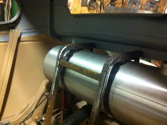

    Started the fab for the skeleton for the floor and working on mounting the fuel cell. I'm about half way done the mock up. I can see I'll have to modify the outlet on the fuel tank also will be adding a sender to the tank as well.

    Very nice work on the frame!! Like the way you set up the rear bags!

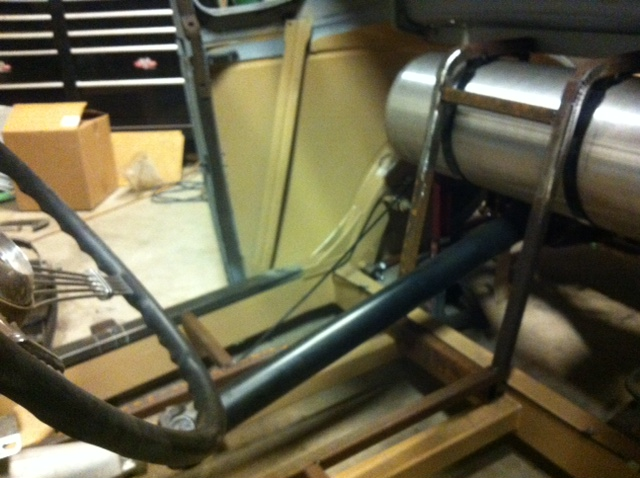

    Just need to make the driveshaft loops and a few small pedestials to tie the skeleton frame to the chassis. Should be able to start laying the aluminum in the next few days. Gotta tig weld the the new outlet for the fuel tank and drill and mount the sender unit and start laying the wiring for the rear before I lay the floor skins though

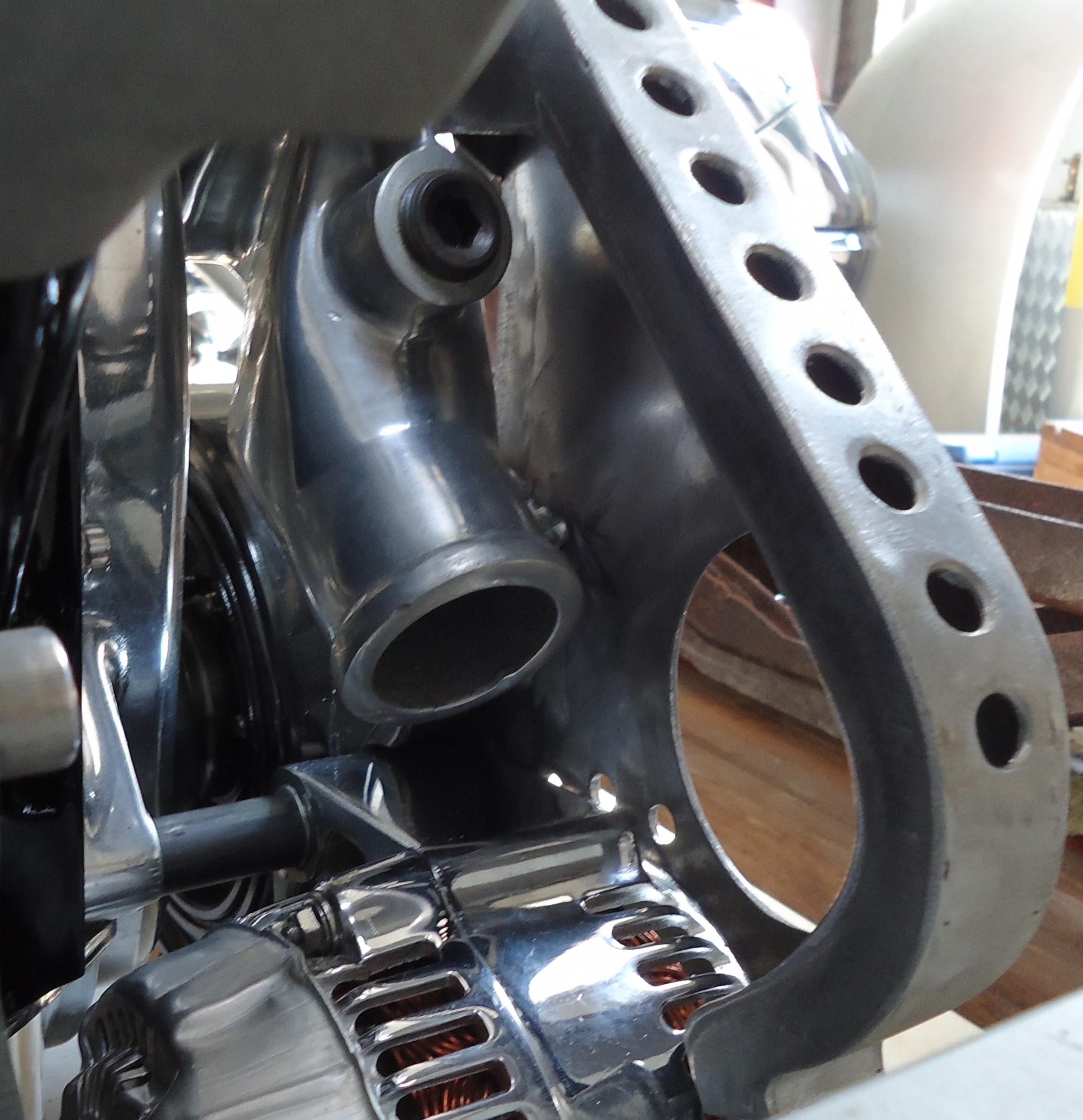

    would you have room to make a mount off of the rearend for your alternator here? I love your build and when im staring at that beautiful hemi, that damn alternator jumps right out.. Although you have probably thought out every mounting possibility.. :rolleyes:

    I've been looking at driveshaft mounted alternator setups, they are definately cool and get the alternator hidden. My concerns with that setup is that it wouldn't be charging when not moving, rush hour traffic around here is crazy. I'm not to worried about the battery being drained I would be more concerned about having to change a belt or the alternator if something happened.
    I have been looking into those alternators from racemate. Wonder if that would work on my motor?? I have a BBC waterpump on the hemi.

    Great work so far! Have you thought about make a driveshaft hoop/loop? You could easily incorporate it in the new framework you've just built.
    Regarding the alternator, I also opted not to use a driveshaft driven one for the same above mentioned reason. And didn't want one sticking above the engine/bbc water pump either. So I fabricated my own bracket and used a single wire 100 amp alternator positioned on the lower passenger side of my Hemi. Maybe this can work for you. Good luck.

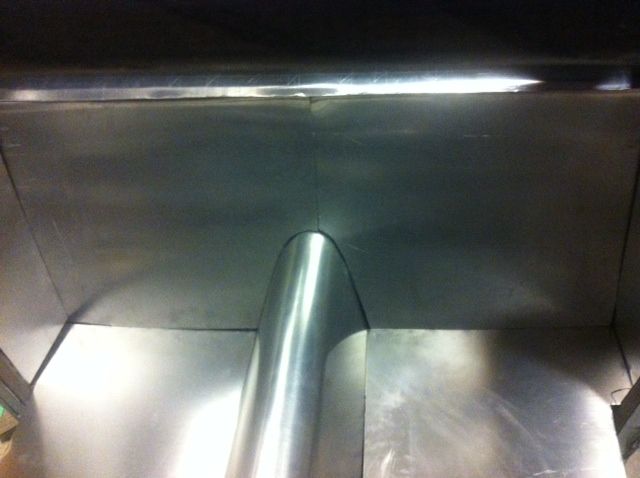

    As for the driveshaft loop, I've already made them just haven't updated the pics yet. Got all the aluminum roughly cut and fit from the transmission back including the tunnel and most of the floor for the car and need to start layering it and putting in dimpled holes and beads and start riveting it together. I'll be working on the last few pieces for the front this week. Hopefully in a week or two it will be wrapped up and I can start the wiring......hopefully, lol.
    That's a very nice alternator mount you made, something like that may work on mine, after I cut and modify my rad outlet for the hose to the pump I'll have a better idea of what I can fit down there if anything. For now, my focus is to get the flooring done, running, wired and in paint. Thanks for the pics of your mount. Much appreciated.

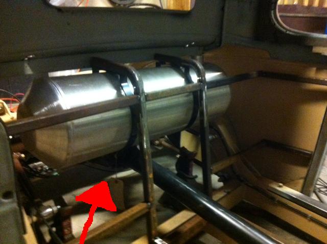

    Modified my aluminum tank and moved the outlet as well as making a pedestial for a fuel sender, won't be running out of gas with this one:cool:
    Got the tank final mounted and installed the fuel pump and cut the lines, everything in the back is done finally. Ran hose plus some to the firewall where I will mount the regulator.
    Started ROUGH cutting the aluminum for the floor skins, will have to cut and fit as I go. I didn't really have a plan but this is the way it's turning out. LOTS of layered panels to make still, bead rolling and dimpled holes to go....not to mention the couple thousand rivets it will take. Will start clecoing it together over the next few days and start the riveting.
