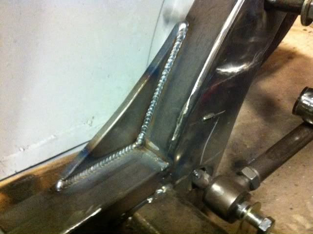

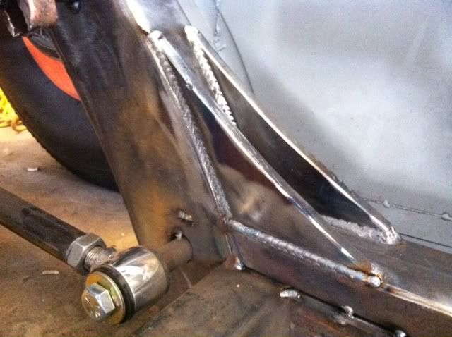

    Added some gussets to the rear kick for strength:
    Basically the rear is done, just need to install the rear body mounts I've been working on and its finished and ready for welding.
    Just wondering how you are going to sleeve the 4 bar mounts and add some gussets as they are out from the frame a ways and I would guess that they would flex a bit. Not nit picking, just curious as it looks like you have it well under control.

    The grade 8 bolts for the four bar links are mounted through a heavy wall DOM tubing that goes all the way through the frame rail and will be welded both sides. I am also going to add some small gussets off the DOM to the frame rail. I'm thinking that should be plenty strong.

    I figured you had it under control looking at the rest. The rest is done up so nice that I guess thatis why that caught my eye. Carry on.

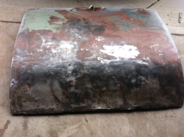

    Finished up the rear mounts last night, been ****ing around trying to square the decklid and not getting anywhere, I've tried everything it just won't sit proper. I'm under the ***umption that the aftermarket skin I put on the inner panel is just poor quality.
    I kept the old rotten original skin when I stripped it off, its pretty mangled to say the least, rested it in the trunk opening and it sits way better than the "new" one. Decided that I'll spend the day trying to get it's shape back.
    Here's what I'm up against:
    Stripped it of all the bondo, welded all the cracks on the flanges and started working it in the English wheel. Had to tweak it abit in the shrinker/stretcher and welded in 3/8" to the bottom flange. Starting to fit pretty good now.
    Still need to body work it some more but what a difference. Removed the inner trunk and will work on putting it in tonight or tomorrow.
