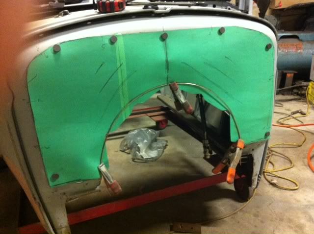

    Decided to make the firewall and weld it in. Still some finishing left to do but it's looking better than what I had I think.
    Made a pattern from poster board
    Fit and welded in
  7. Drivinford

    Drivinford

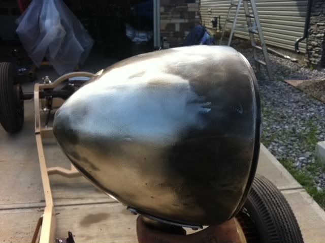

    Scored a set of original guide lights from the Spokane swap, a good buy for 50 bucks but pretty banged up. Hammered out the dents, rant them through the English wheel and hand filed them after. Looking good now and ready for paint.

    Good score man. I like em
