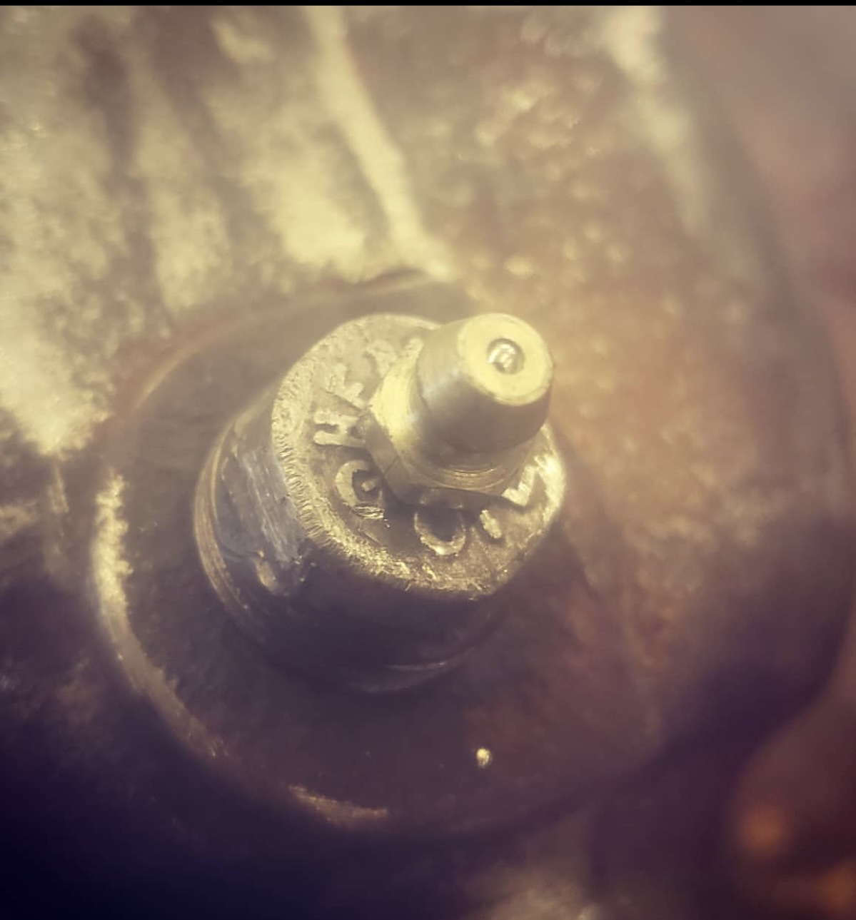

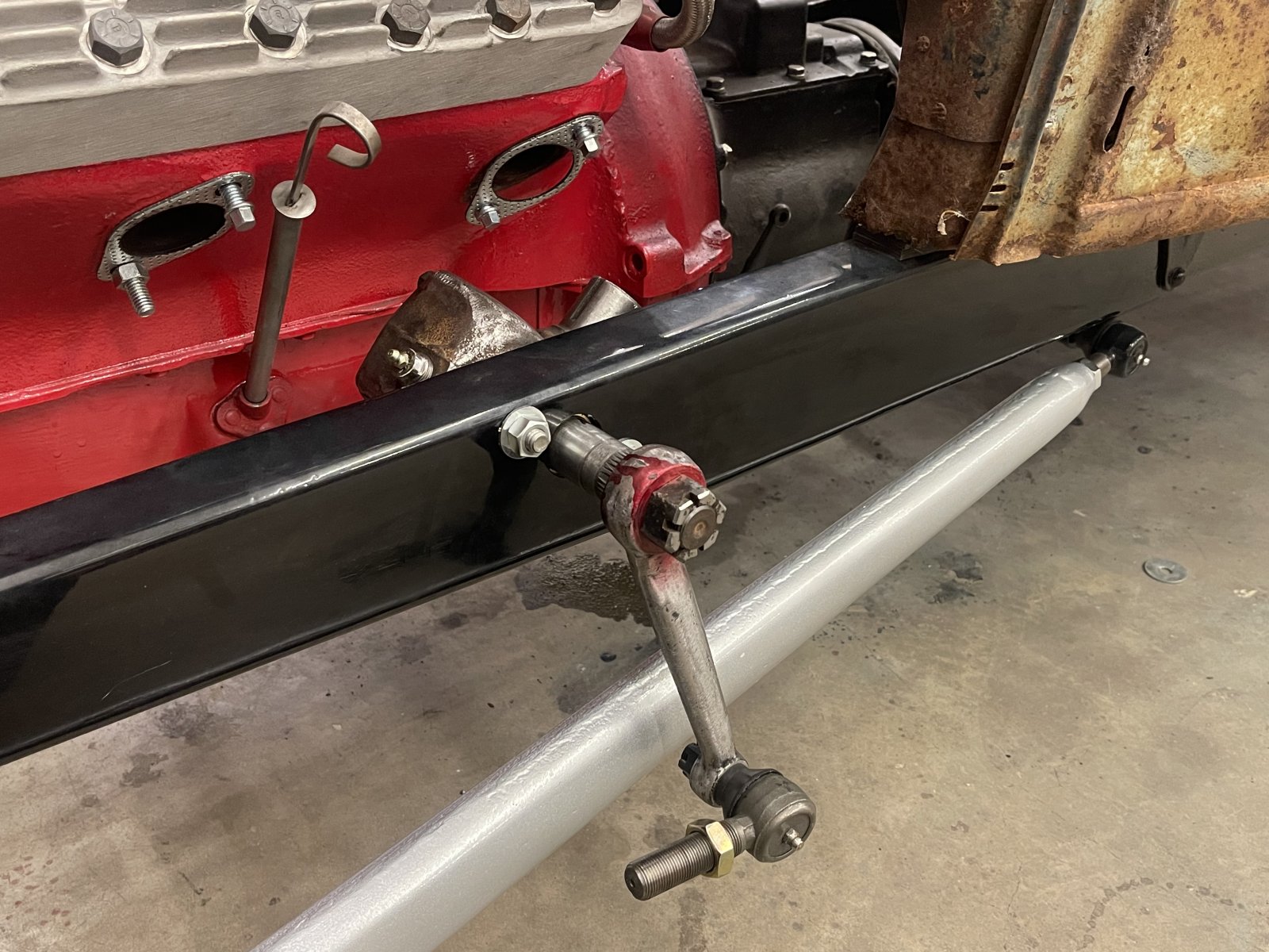

    Box is done done. Keys in the pitman arm were removed and tie rod end retapered. Zerk added. Now to replace the gears and she’ll steer!
    By the way, if anyone has any advice (or a video!) on how to rebuild one of these, that would be much appreciated!

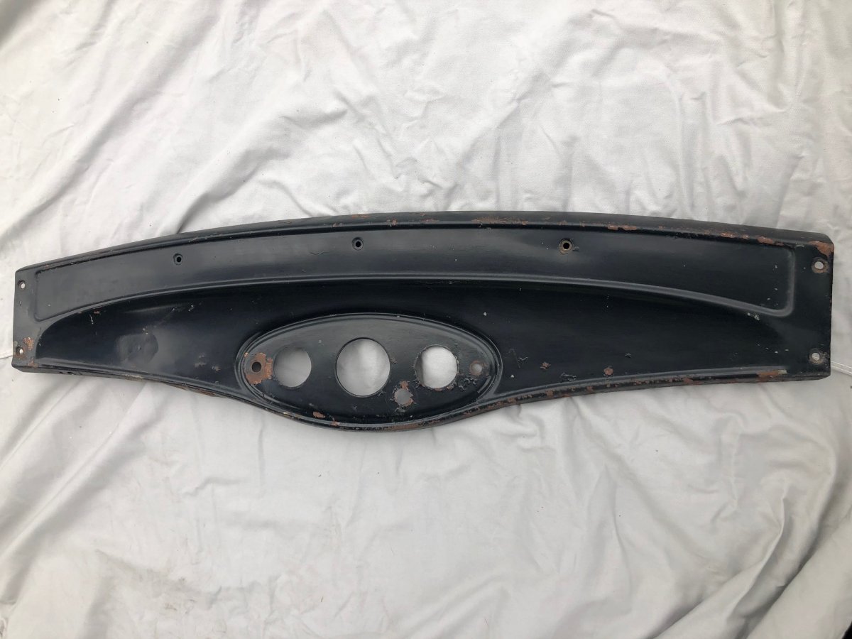

    If you're not using the stock gas tank, a 32-34 Ford pickup dash is almost a bolt-on. You will have to cut the old tank out and trim about 3/16 inch off each side of the dash...it also matches the curve of the windshield/dash rail perfectly.
    EDIT. This dash would also work well on 30-31 Ford Victorias and A400s, as they use the same cowl as the Slantwindow Sedans

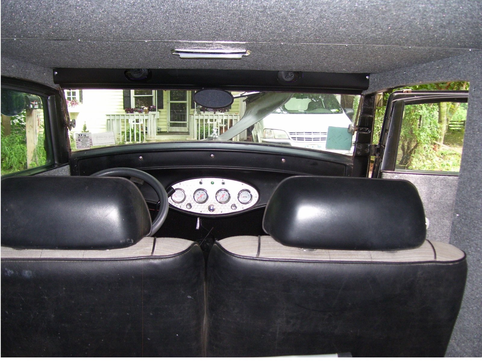

    I think I’m going to use the gas tank as a dash and housing for any electronics and battery. Need to find a dash rail though.

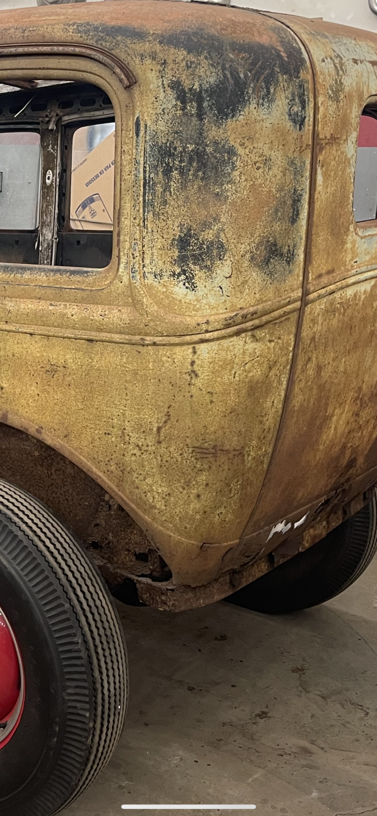

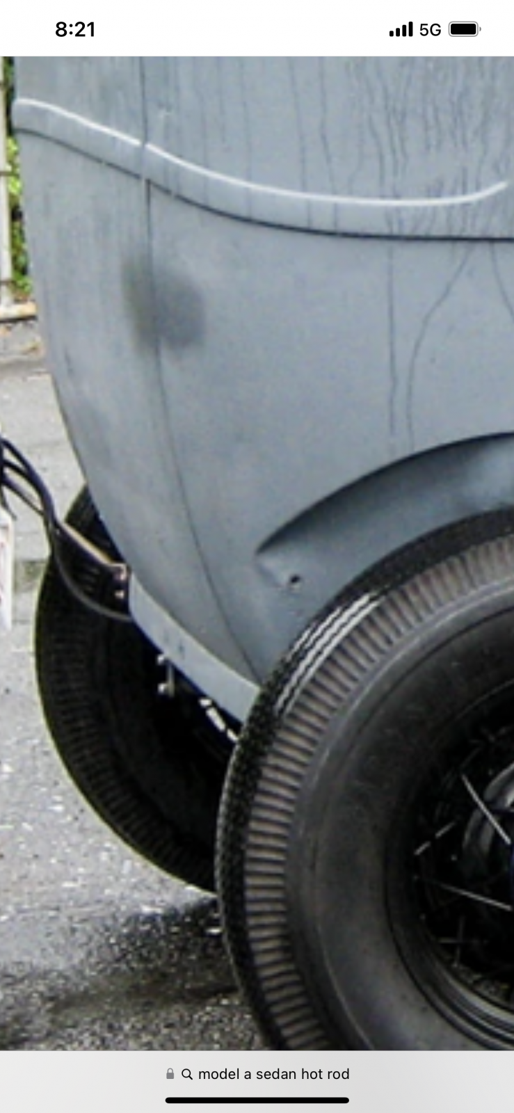

    Anyone know what patch panels I need to get for the back panel/corners? Definitely different than standard model a. Do I need to find ones for a 32??

    Yes, the '32 patch panels are about as close as you are going to get. The "reveal line" isn't as tall as the Model A, but they can be made to work.

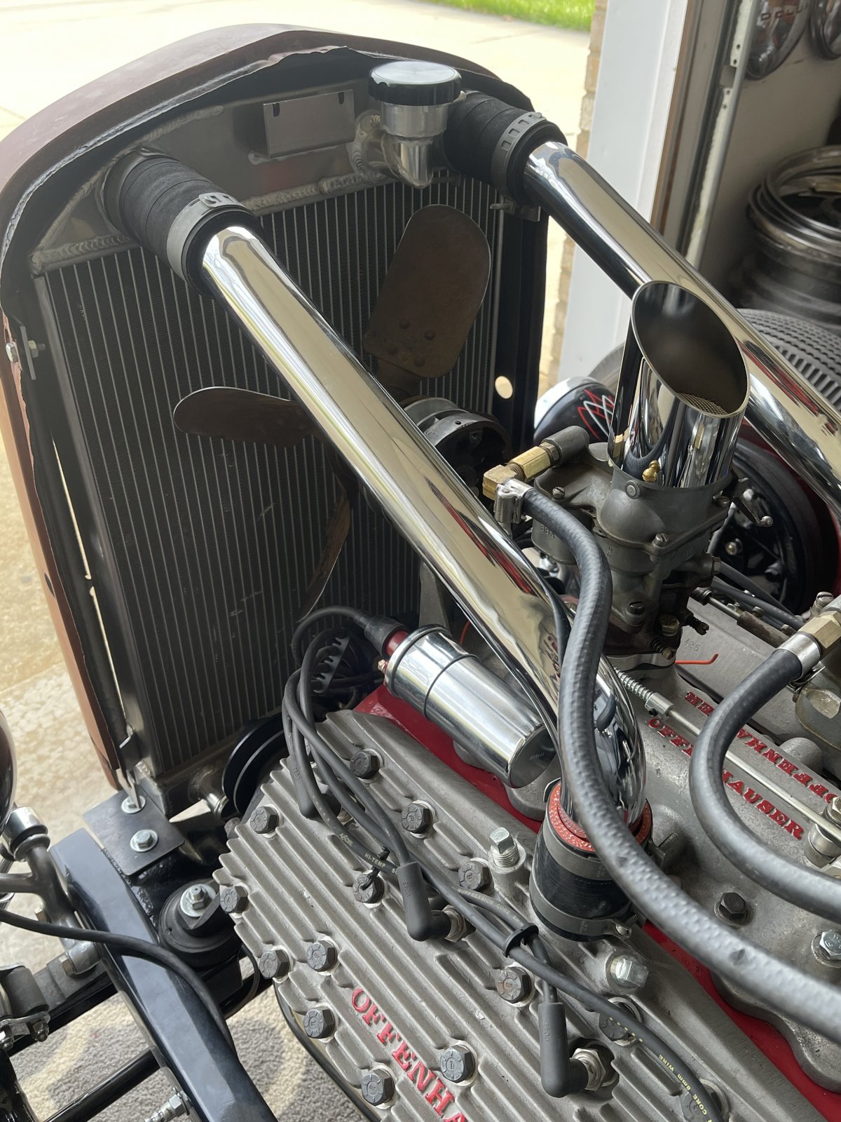

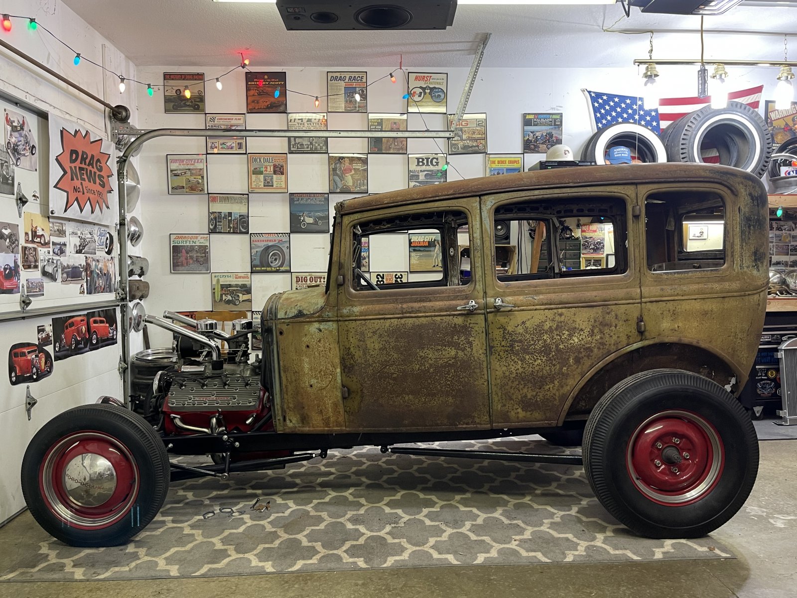

    Slow, but sure. Kinda getting it how I want it now. Swapped out the aftermarket axle for the old A axle that was under my T coupe. I’m going to do a little spring work and get the front end down another inch or so. E8A8823F-769F-4173-9DE3-D614643D7B9A.jpeg A3850C06-2DC3-4245-8A6C-B056F034FA42.jpeg BCF65523-DF8C-4338-8D93-3032AEA1B0C6.jpeg

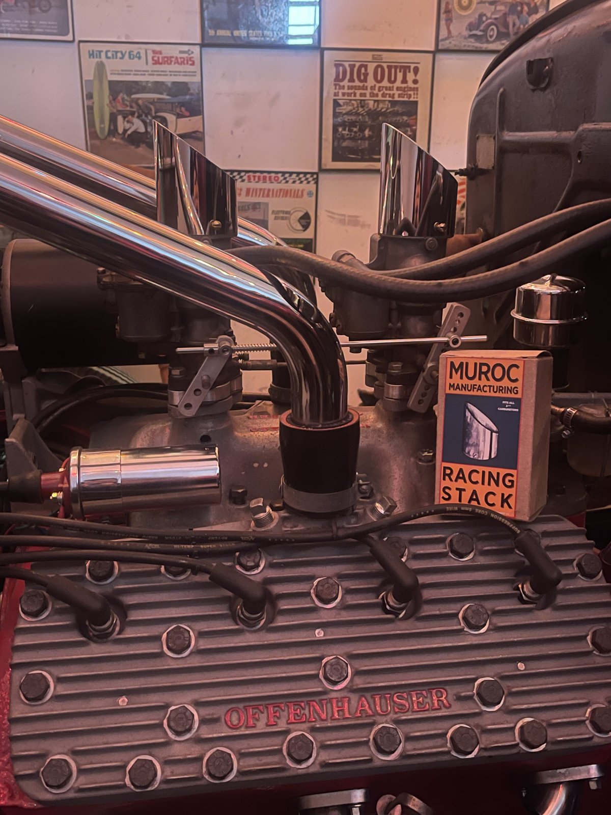

    Got the front down another 1.5” or so and lost the frame horns. C8FCE107-AE16-4125-98E9-B45487CB9E5B.jpeg 5272D6FD-7F8E-447E-BE25-47EE571450F0.jpeg
    Also got a nice surprise from Muroc Manufacturing!

    Got my grille! Need to get the radiator painted and final mounted. 266CD917-61DF-4C1F-9236-080C9E6075AC.jpeg 40983D71-3B7A-4185-A8C7-ABA271D9C841.jpeg
