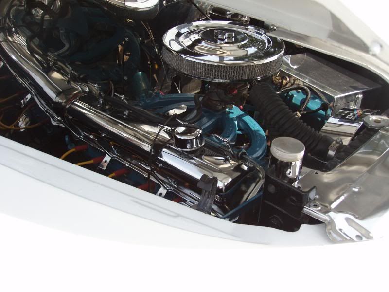

  3. http://i99.photobucket.com/albums/l289/56dodge/P1010337.jpg Here is a pic of my slant 6 in my 56 dodge truck I did no have to make any fire wall modifications I actually added a chrome false fire wall. I do not know if the dimensions are the same as a 170 mine is a 225 from a 74 Dodge dart. Sorry about the link I can't figure out how to post a pic without the link. Check on www.slantsix.org there is a wealth of knowledge over there and they should be able to answer your question.
