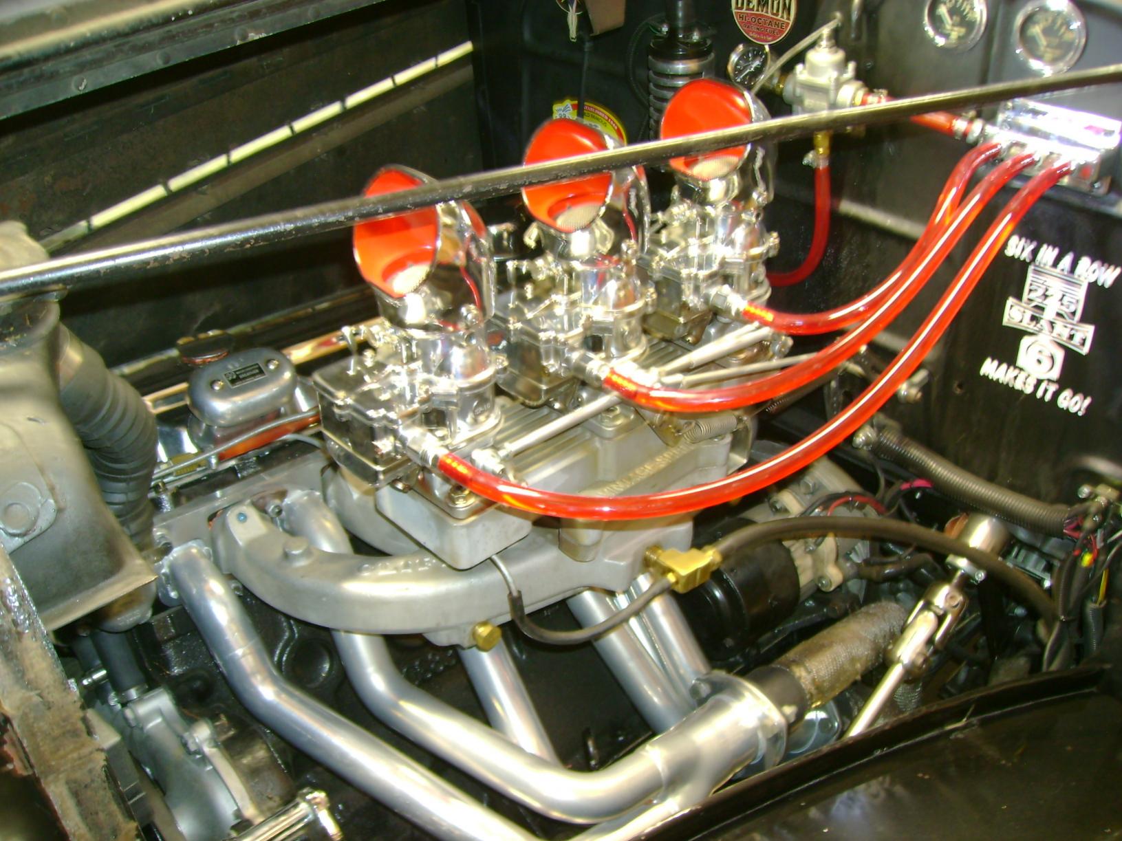

    Here's mine.
  5. Jeem
    Joined: Sep 12, 2002
    Posts: 5,882
    Jeem
    Alliance Vendor
    Looks cool...how's it run with the 3 carbs through the adapter?
  6. zipoleon
    Joined: Dec 19, 2006
    Posts: 290
    zipoleon
    Well it runs pretty good, it'll fry the tires, but I know it's not running up to it's ability, because I keep chewing up distributor gears before I can drive it very far.

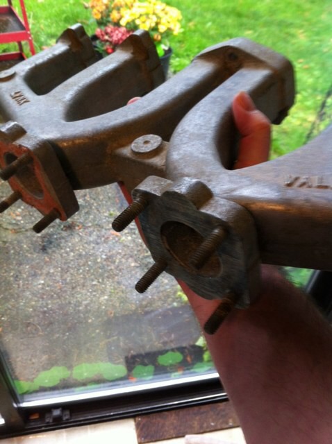

  8. ImageUploadedByH.A.M.B.1386407455.448796.jpg ImageUploadedByH.A.M.B.1386407489.048275.jpg
    Putting this together for my '29 chev
    Should mention its a lynx intake from Australia that takes two hs6 su carbs.

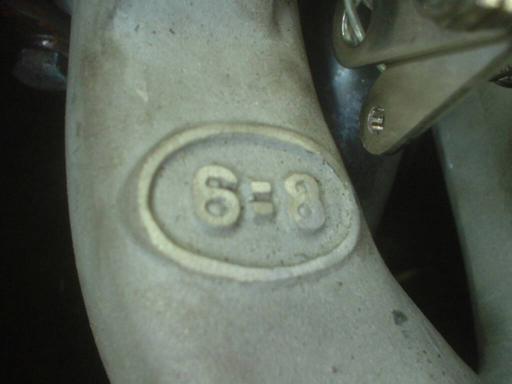

    This pic 1393011176900.jpg is all I can offer to this group.
    I have a shaved-head slanny (milled .100" and stocker pistons= 9:1 ish) with Offy 2x1 bbl intake and Clifford header. Pic above is the Clifford intake that is now on the shelf.
