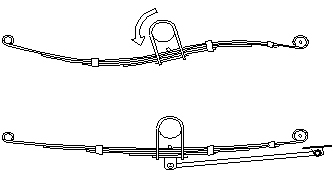

    I was looking at this picture of the TRACTIONMASTERS setup and was wondering, wouldn't the rear suspension bind if positively mounted front and rear of the traction aid?

    I think you put a floater on the spring (ladder leaf) or use a telescoping bar.

    "I was looking at this picture of the TRACTIONMASTERS setup and was wondering, wouldn't the rear suspension bind if positively mounted front and rear of the traction aid? "
    Its important that the front attachment point is directly under the spring eye to minimize bind (to have same arc). That attached thumbnail would not be acceptable.
    Also front attachment should be in double shear, not single as original Traction Masters. These are a cost effective benefit both accelleration and braking but are not the most effective solution to achieve instant center and antisquat solutions
