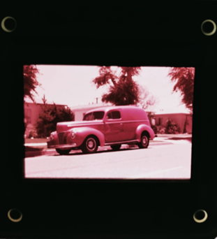

    This is what I did for our 327 powered 1940 Ford Sedan Delivery when my wife said she would not drive it unless it had seat belts. The shoulder harness (4 point, dual straps) over the seat was the only other option and that did not go over well with a girl/woman driving it in her pressed clothes.
    I was driving it home from a photo shoot one day and got caught in a CHP traffic road stop for vehicle inspections. Those kind that require random selection of cars to be pulled over to the side for a vehicle inspection. The CHP inspector thought the red Ford Sedan Delivery hot rod was going to be a gold mine of infractions. So, he started with the headlights and brake lights and worked his way inside.
    When he saw the seat belt installation, he went to the floor behind the seats. He gave his approval with flying colors when I explained how I installed the custom GM Chevy factory seat belts into the 40 Ford Sedan Delivery. Yes it was a Chevy product in a Ford, but, they matched the upholstery perfectly. We placed a smooth, opaque custom piece over the hidden GM logo and it looked as if it was a custom product. Which it was!
    The CHP guy liked that I put in a second wider washer plate underneath when I explained the installation. Strength plus… YRMV
